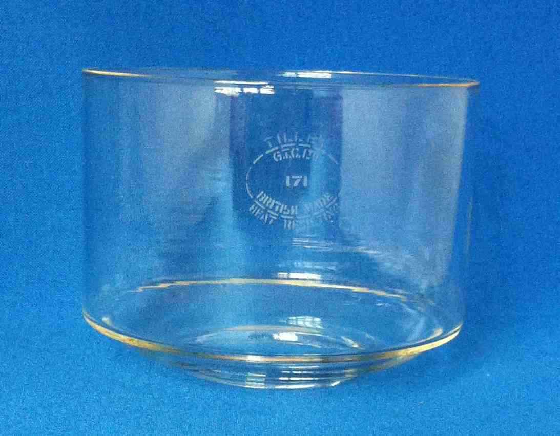

    Hi guys. Does anyone know what globe and mantles I need to order for a 246a lantern.

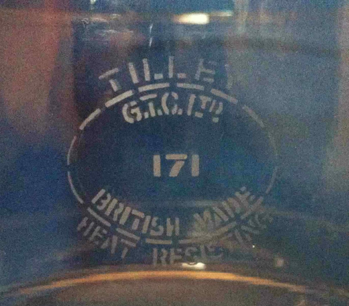

    @David Lawlor
    You will need to find a 171 glass globe.
    The mantle with be an 164 X. This is a double tie and there are several different versions and they all work.
    You can find both the globe and mantle in the UK and ebay may be your best option.
