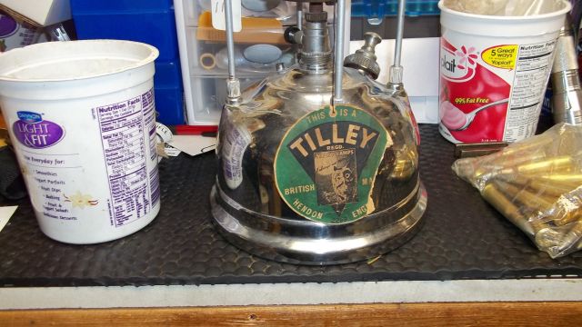

    On my shelf among my Coleman lanterns, I have this 958XA that I bought from a fellow in Canada back in 1998 or 1999 for two reasons: I thought it was a handsome lantern, and it has an owl on the side! Thought that the owl was really neat!!! It has a tag on it that has the number 2253 on it. I have no idea what this means or how old it is as the 958XA is the only thing on the bottom.
    So is this a good lantern?? Is it rare? is it special, or just a run of the mill Tilley. Also will the Service Pack SP1 washers and gaskets fit in this, just like the 246?. This will be my next "Kerosene Project", but I have to make some more bullets first.

    Hello Don, a few photos would help, but 958XA is the date code, it was made in September 1958 and it is most likely a Guardsman lantern.

    1339113662-Tilley_958XA__1__opt.jpg 1339113746-Tilley_958XA__2__opt.jpg 1339113769-Tilley_958XA_opt.jpg Finally figured out the picture thing!
    16,914
    Hello Don, yes, it's a Tilley X-246 Guardsman lantern and it should restore well enough.
    They are a good lantern, but the tanks were better before 1957, Tilley changed the tank design in that year.
    That service pack of washers will be fine, but if you require new washers, then it's better to buy them from Ross on this website, I shall add that link shortly, Jeff.

    16,914
    Hello Don, the link below shows a topic called Tilley tanks, it shows and explains the change in the design of the Tilley tanks, Jeff.
    http://0flo.com/index.php?threads/3634

    So what do the numbers on the tag stand for??
  8. JEFF JOHNSON
    16,914
    Hello Don, I'm not sure, but it may be a batch number, Jeff.
