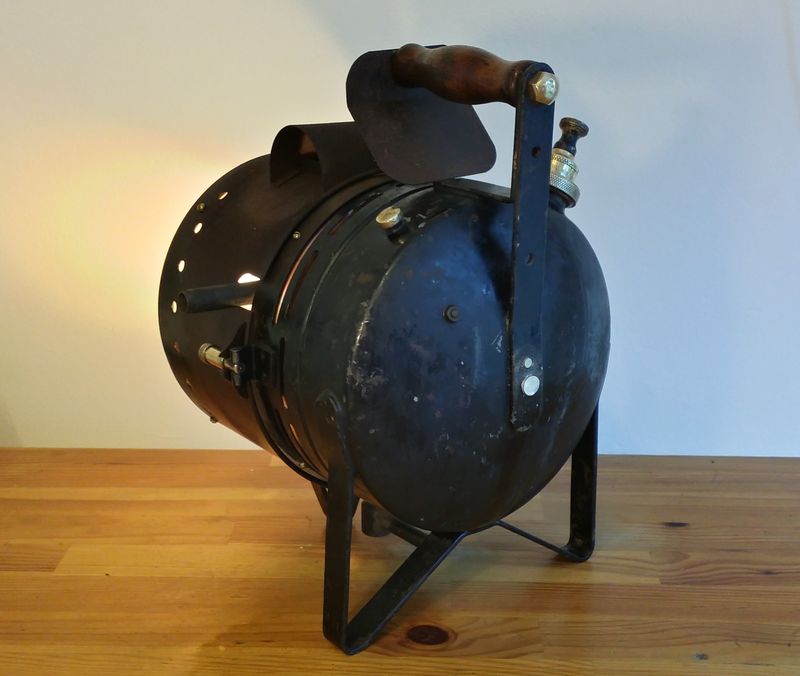

This is an AL11 that I saved from electrification. It is in pretty good condition rust wise. I plugged up the holes in the tank and resoldered a leaky seam. I don't have the right burner for it so I borrowed a burner from an FL6. The mantle is not very bright as my FL6 burner is pretty much worn out. The reflector has had a hole drilled in it and the plating polished off back to the copper. Not a problem with a lightbulb but an issue with a mantle as the heat causes it to dull rapidly so unless I can find another I might repair the hole and have it replated.
Wow James that's a nice lamp Gratulations Wellsaved I like the hinge sits in the side, why did they ever change that?? Also they still had the pressure-relasescrew seperate. Claus C
Great job saving an electrocuted Tilley. I've seen some Tilley reflectors for sail on EBay, but not sure of the size. Cheers Tony
A rare thing. These were only made for a few years before 1937 and not many have survived. Nice to see another one rescued. ::Neil::
