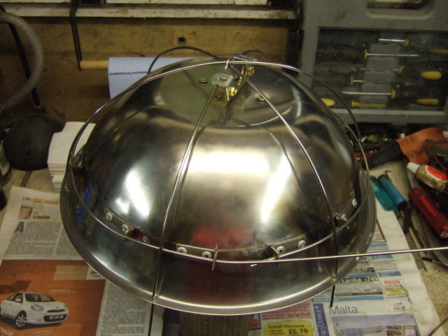

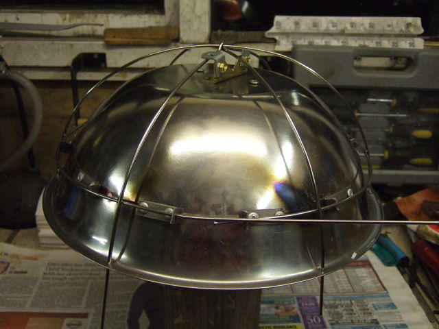

    Iv'e had a busy week but have managed to get some bits & bobs finished that iv'e been working on for a while now & here's the latest creation , i know it looks like a mad scientists brain drain device but this is my tilley bowlfire guard jig ( It takes a bowl to make a bowlfire jig :D ) .
    Iv'e been working on for weeks now because i have so many heaters that have no guards & the ones i do have are rusty, & using this i can now make them ( the early simple pattern ones ) from stainless steel wire silver soldered together, as even i don't have a spot welder :D ( yet ).
    The clip on ends are just bent over at the moment but i will try to make a tool to get the original clip shape but thats for later :shock: :D .
    I will make these to order for anyone who wants a guard for their heater & will sort out a price when i get time.
    Here are some pics.....
    The first two pic's show the front clip where the wire for the inner support ring is held & joined
    This pic shows the top wire clamp made from a modified hinge , this holds all three guard wires in place & when soldered pushes over to release the finished guard :thumbup:
    & finally a couple of shots of the finished guard on an early tilley :thumbup: :D
    What do you reckon :thumbup:
    Best regards Stu :thumbup: .

    Would you believe i got some stainless bowls to make some repro 2 pint stove heaters with the fire domes 8) , but this one had just the right shape to make this jig so off i went on another tangent & this is what i came up with :D . I may add some more bits to the jig to make some of the other Tilley styles later on.

    Finaly got round to making a few of these simple :shock: ( they take about 1 1/2 hours to make each one :roll: ) early R1 guards for a few members :D :thumbup:
    These are made on the jig pictured earlier in the post & made from stainless steel wire & all silver soldered together so they'll never rot away like the standard wire ones :D :thumbup:
    I also made one for my later style Tilley R1 & my IF 542 :D :thumbup: although not the standard multi ringed version this works really well & looks the part :D , i have tried to make a multi ringed guard but the stainless wire doesn't want to play :doh: :whistle: , but i will keep trying :D :thumbup:

    You have problems making the smaller rings, is the wire to stif? what if you heat it first, it will soften. You should roll it up on something and then tie it together, then heat it up.

    It's not that the wire's too stiff it's just so hard to get the rings concentric & looking nice when placed around the frame :doh: , but i'm working on it still , Never give up never surrender ](*,) :D :thumbup:
