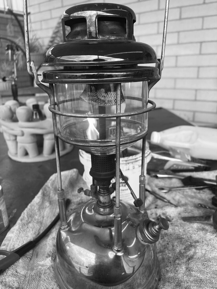

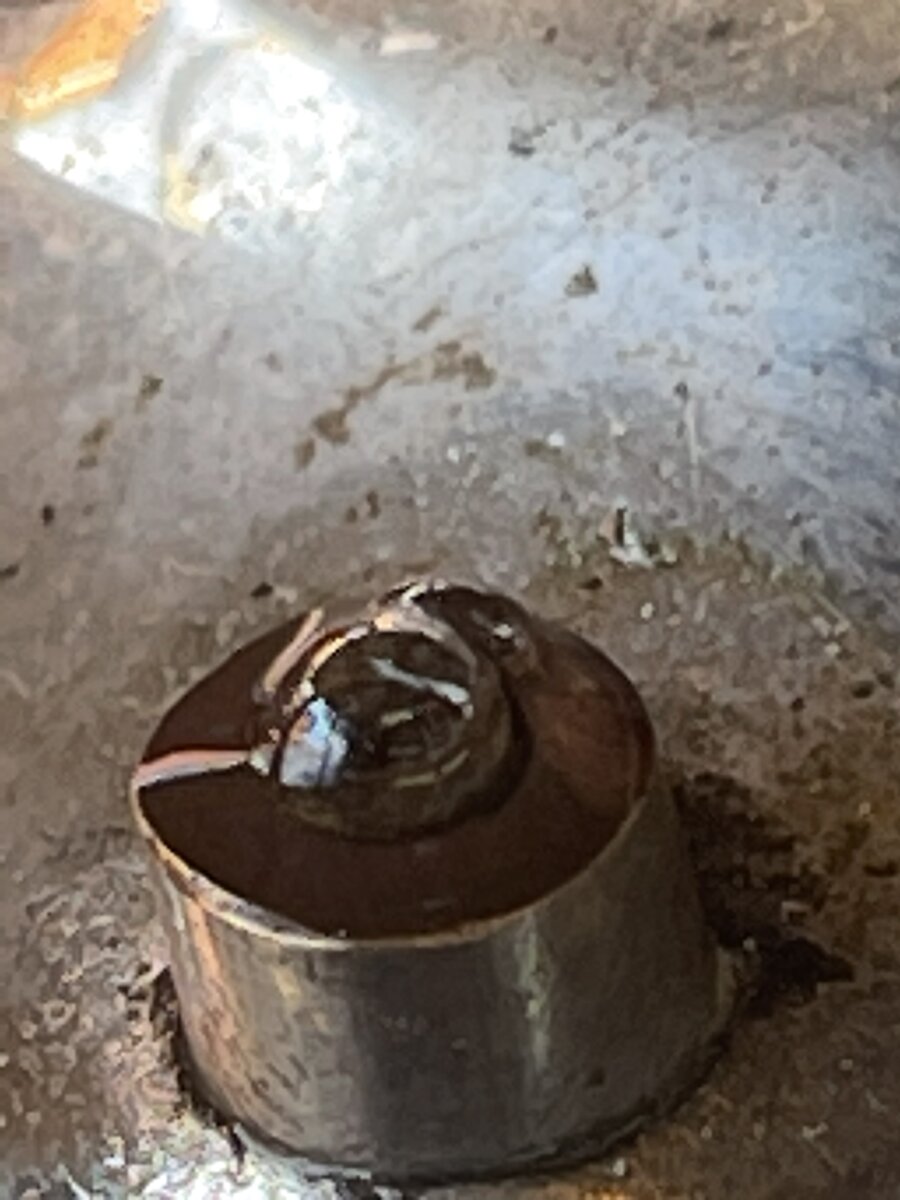

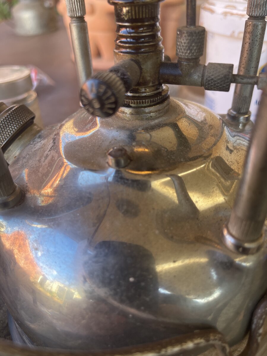

    Hi fellas, this is my BR49 that fell from a great height, I’ve bent it back into shape, new globe and new seals just for good measure, as they take a bit of time to get going I noticed when I pressurised the tank fluid and bubbles appeared, at the pressure pip, is this the end of my tank, I can replace it,
    Would the sudden jolt break/ crack the bellow inside, it has appeared so, any suggestions much appreciated 4D0DE55C-1A5D-4E38-B453-3D78ADA47D60.jpeg 234663F3-9944-4035-BB9E-B01C78FC65B9.jpeg image.jpg

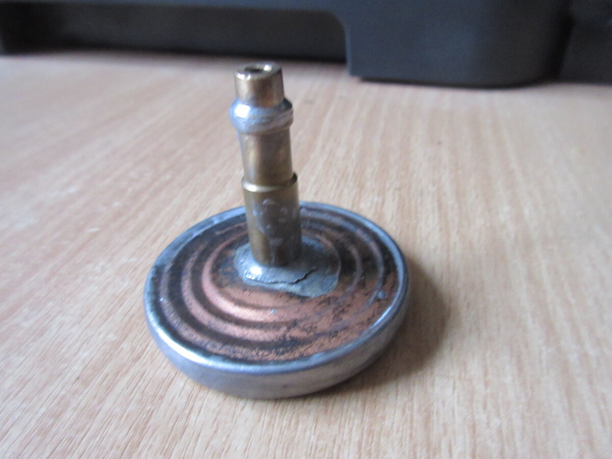

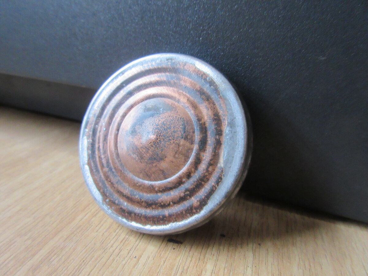

    Hello Darryl. I think it safe to say we all like the indicators when they work correctly. Sadly I have had a few that weep due to some minor leak on the soldering on the diaphragm. A good jolt from the fall perhaps, may have disturbed the neck of the stem where it has a soldered joint into the disc. I think it's also possible that they perish with age, and we can disturb them cleaning the crud out. Below is one I removed from a beyond hope tank a while ago. Maybe seeing the design might help. I have used Holts/Plastic padding "Super Steel" to block the hole a few times rather than solder. Works well but you need to clean and graze the inside surfaces of the pip to ensure a bond. Cheers, Roger
