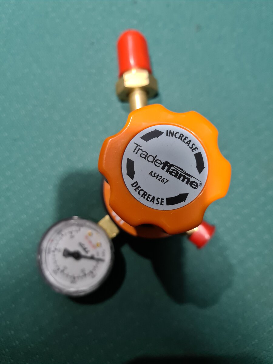

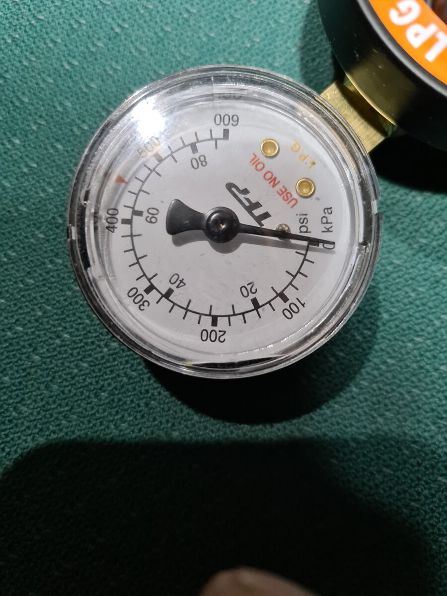

    @Buggerlugs, could you show the regulator specs for the one you got please?

  19. Buggerlugs
    @Anthony, I have an adjustable regulator, which on the advice from malcolm race, he told me to use 1bar, which is about 14.5psi.
    My photo doesn't do my lamp justice, its actually a white light
    and is very bright, next time I will take a photo at night, to show it's full potential.
    Here are some photos of the regulator.
    16050928246894846414786744467498.jpg 16050928488234342180536700168168.jpg 16050928853727394009095353440389.jpg
    Sorry that's all I have as I throw the packaging away, I hope that helps you.

    I didn't know an adjustable regulator was a thing. :thumbup:
