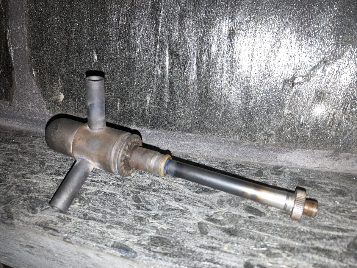

    Here it is as it came out of the vapouriser. How does it look?

    Jon, I read that full thread last night and found it fascinating. One thing I’ll say is that my experiences with X246B’s have been very displeasing. I have a very early Guardsman that I use all the time and it’s in an entirely different league in terms of quality, reliability and performance. I hope the Guardsman I’m currently restoring will be just as good once I’ve sorted out the vapouriser issue and fitted one that doesn’t have problems with it.
  12. JEFF JOHNSON
    16,924
    Yes, the older Tilleys were built to last and I have heard that many Tilleys were exported to Finland, this link shows a post where I mentioned how I improve the performance of X-246-B lanterns, just scroll down the page.

    Looking at the photo I think that the spigeot has failed. It should have more thread showing than is apparent. This may have allowed flame to be directed back between the vapouriser and spigeot. I can see it is one of the modern made ones, where the jet end is tig welded in place. in addition the needle is friction welded to give the hard wire near the jet, and softer wire running to the spring. It also serves to retain the spring. you can see where the friction weld is off-centre. Generally these original things go on for ever - the failure rates are quite low. However the vapouriser was designed to be a consumable.

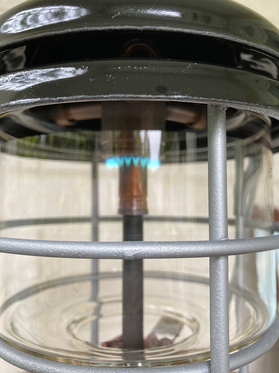

    I’ve done all I can do with the Guardsman now, I think. The original vapouriser is installed and I’ve done a test burn with my brand new burner from Juliands. I pressurized the fount with 30 strokes of the pump and this is how it burns. Is this mantle-worthy?
    I recorded a short video clip to give a better view of how it burns, but sharing it seems impractical. There is some pale orange flame that flares down to just below the spigot, but none of the streaky yellow blasts that I’ve seen elsewhere. The hissing is constant and the burn seems overall very consistent.

    The blue flames in the photo look fine to me.
