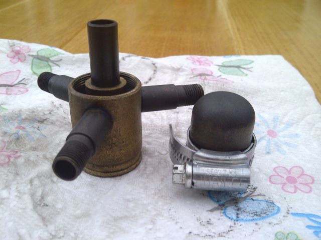

    I used a hose clamp to grip and compress it slightly. The hose clamp could be put in a vice to unscrew the dome.

    4,096
    I have found that the hoseclip method squashed the dome and left marks so I made a tool, a collar that was a good fit with lugs welded on so that when it was tightened it nipped the dome but didn’t mark it
