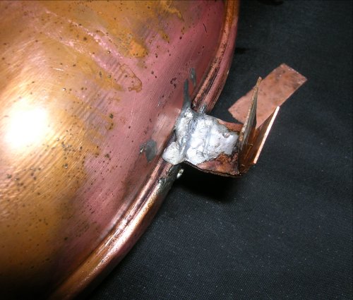

    I think you will have difficulty with such a thin piece of metal, as you need quite a bit of force to push out the dent.
    If you're going to paint the tank you could always just fill the dent in.
    Otherwise I have had some success by soldering a metal tab onto the dent and then pulling the dent out from the outside.
