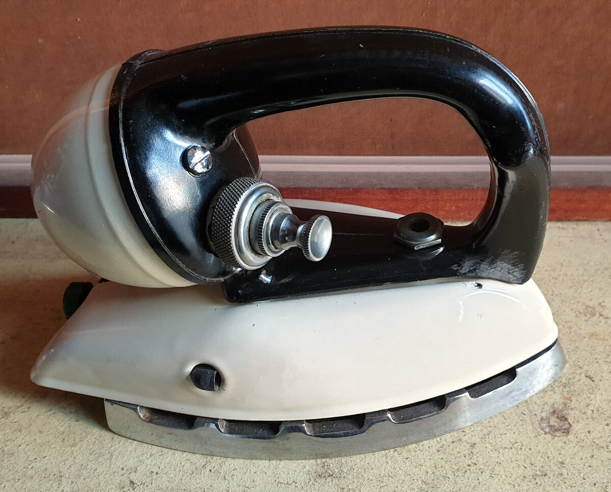

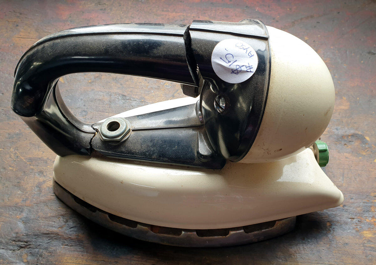

    The DN. 250 after the overhaul.
    The Broken Handle that came with the iron and was replaced with a new old stock handle.

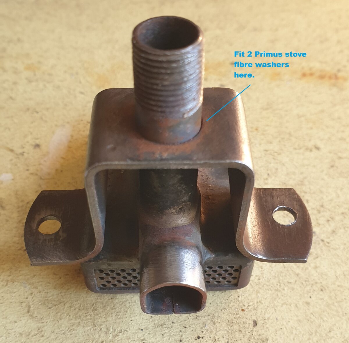

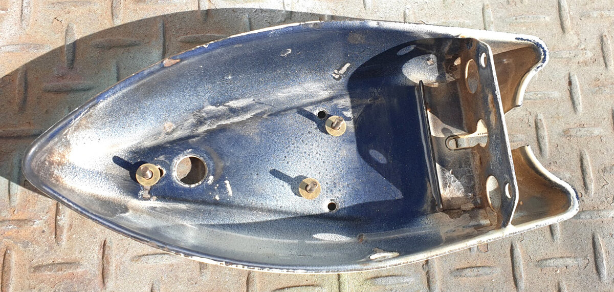

    The burner needed two Primus stove large washers.

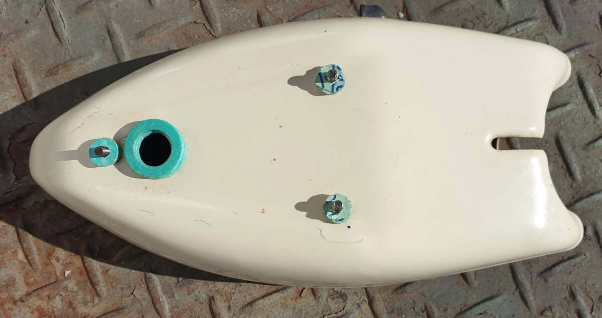

    The three internal washers shown here can be replaced with small M4 brass washers.

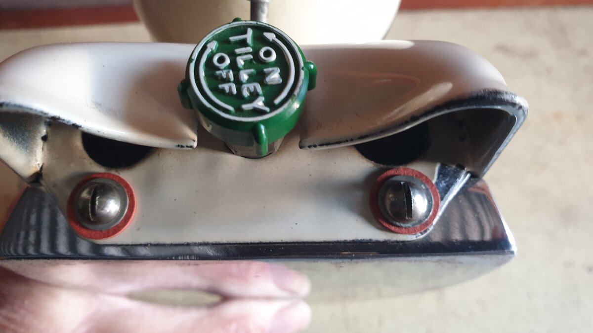

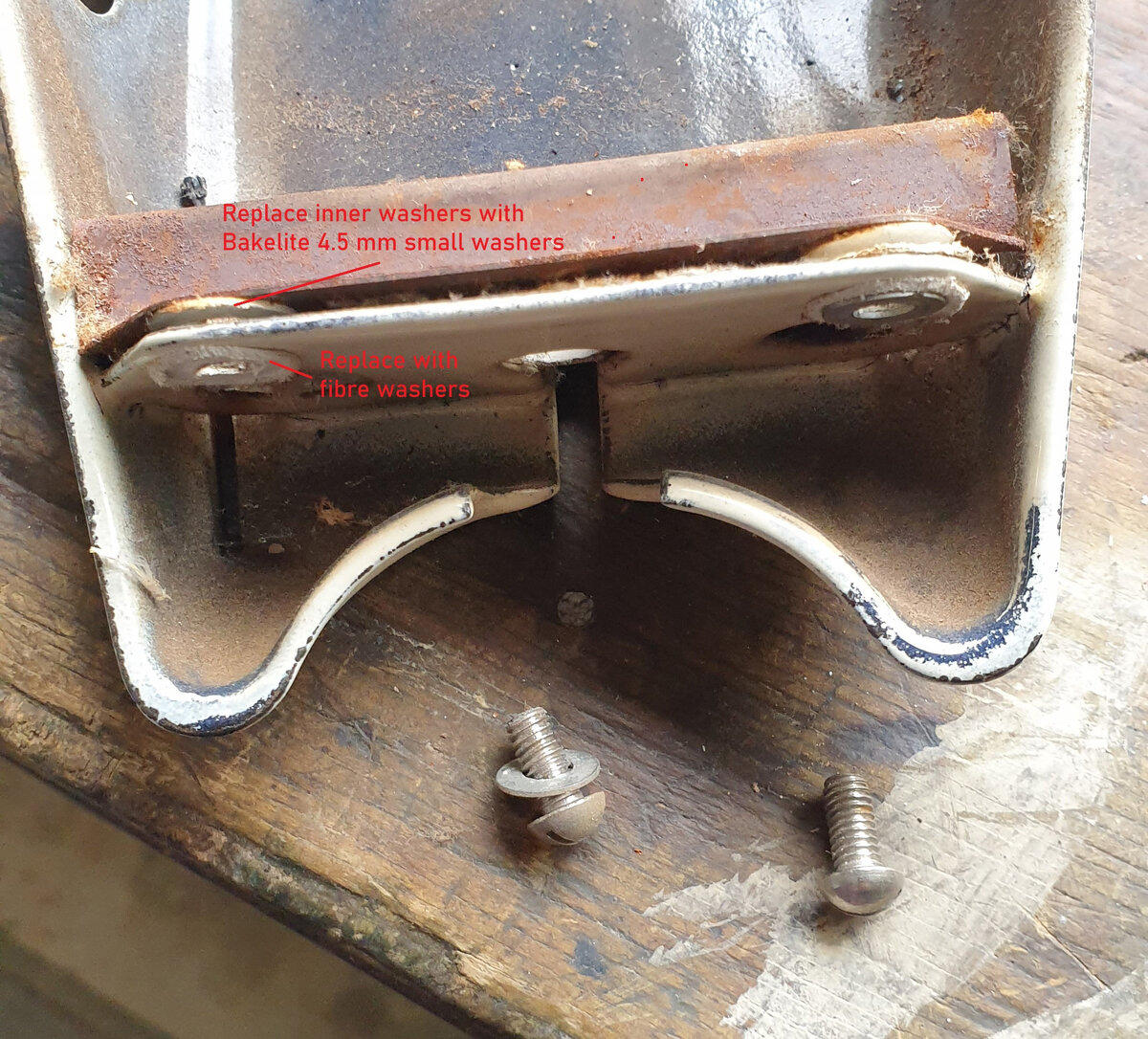

    The rear bolts keep the metal washers (DN. 250A does not have these), but you need to replace the two outer asbestos 4.5 (ID) by 12.6 (OD) and 1 (T) with red fibre washers 5 (ID) 12.8 (OD) 1 (T)

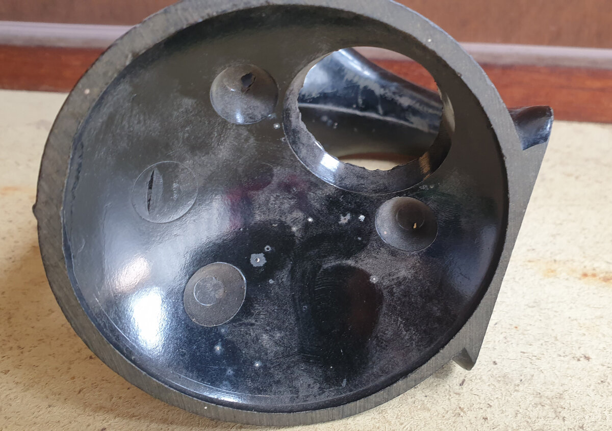

    These washers go between the handle and the cover.
    Replace 3 groups of two asbestos washers 3.5 (ID) 10 (OD) 3.2 (T) with three single Garlock 2500 gasket washers 3.5 (ID) 9.5 (OD) 3.2 (T).
    Use a hole punch to cut the outer washer and drill the hole for the three small bolts.
    Use three more Primus stove large burner washers stacked upon each other. ou need to use a large drill bit to help center the washers whilst putting the handle on.
    The new handle needed to have three holes drilled out for the retention machine screws.

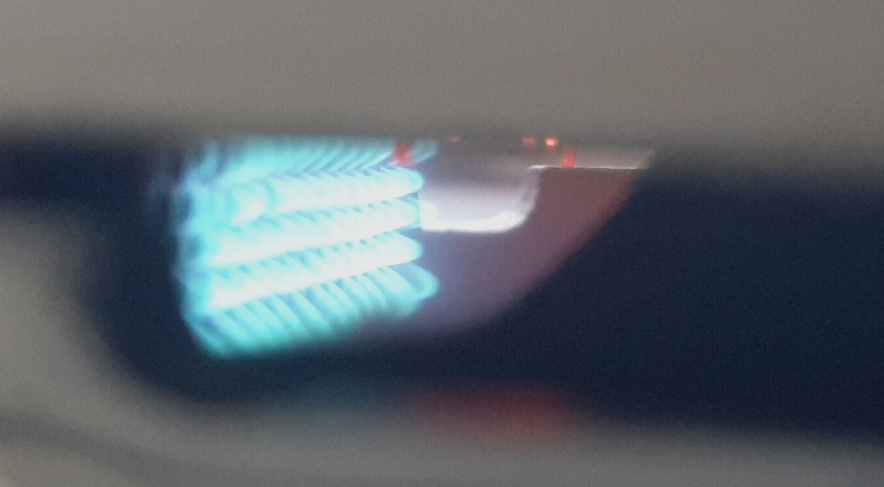

    Firing It Up
    I gave it a go and it worked well. I really don't know how long the washers will hold up for but it seemed Okay.
    A hard photo to get. It works and job done.
