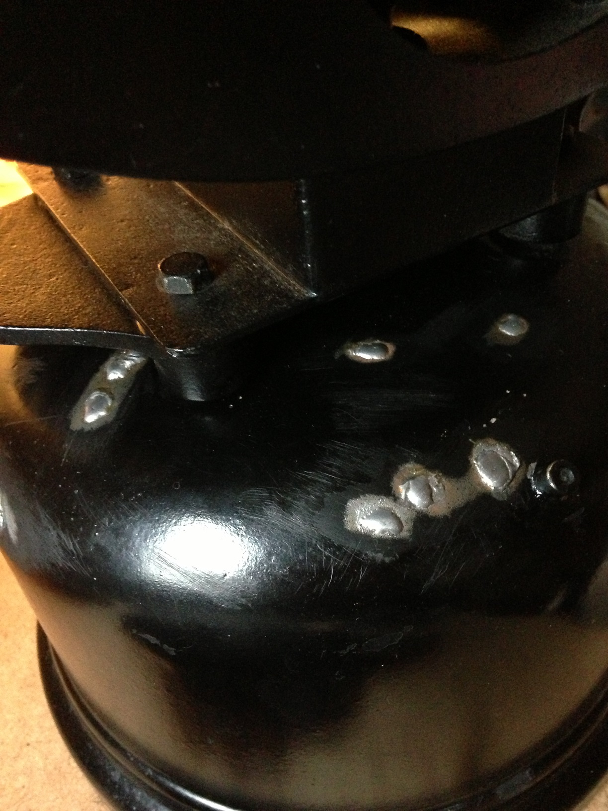

    Quick update: I have now soldered up around twenty pinholes, and whilst it doesn't look too pretty the tank is now airtight. A washer kit and some mantles have arrived and I will be aiming to fire it up later today. I'll post a couple of photos if all goes well.

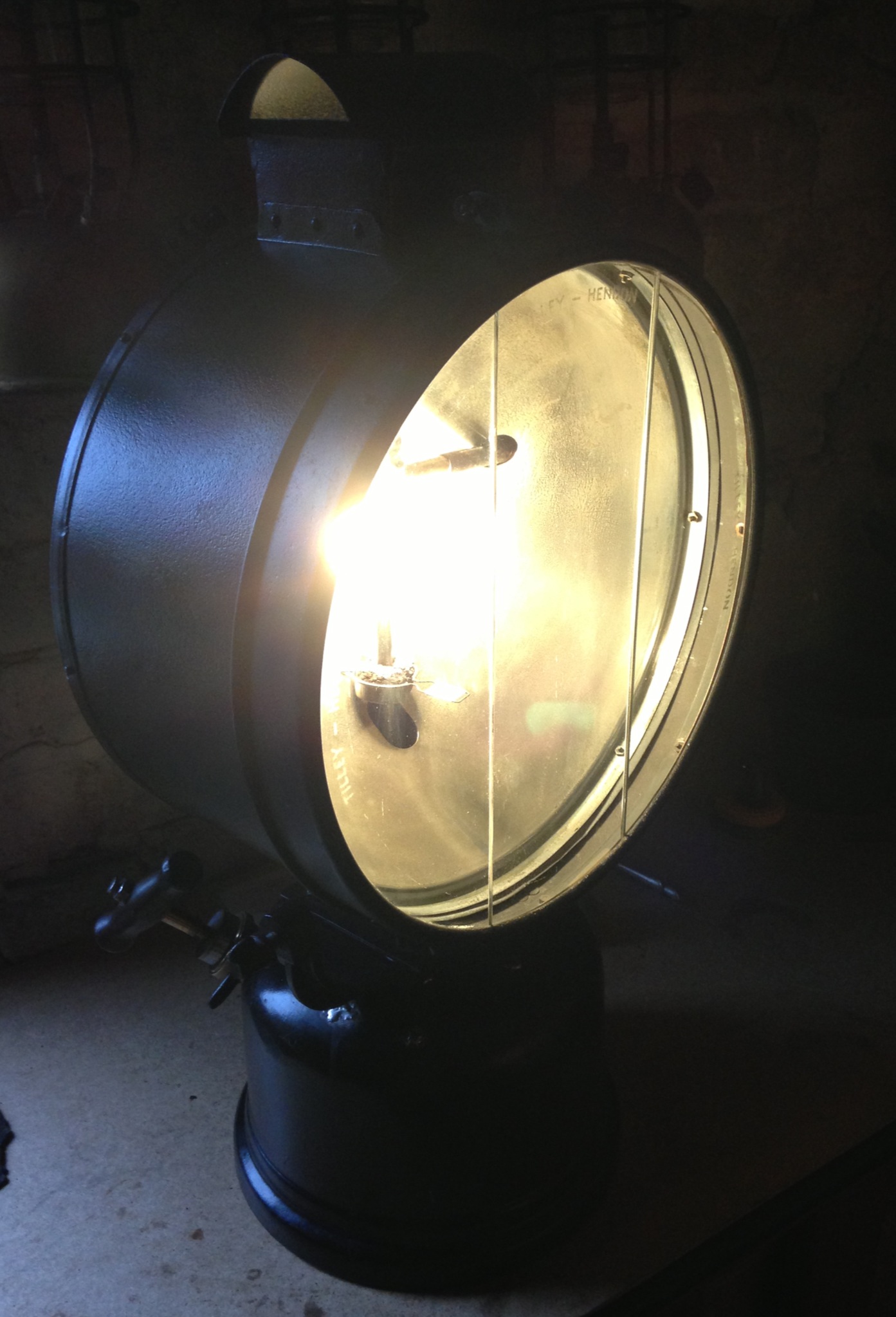

    I achieved first light this afternoon! I still have a small air leak from one point around the threaded pump connection, where the brass insert is soldered into the steel tank, but the soldering of the pinholes appears to have been 100% successful, so that's something to celebrate I suppose :mrgreen:
    Phil

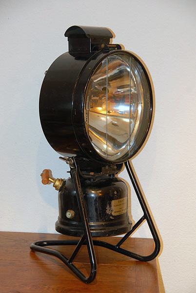

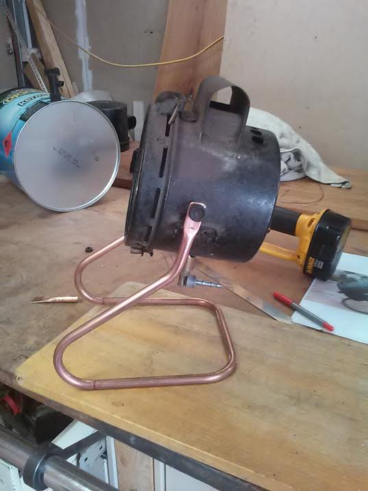

    Thank you Jeff. One thing I'd like to do is make up a stand, to replace the one that's missing. Can anyone please post some pictures to show me what it should look like? I could probably bend some 1/2" copper pipe into shape.

    Thanks Matty. Does the original stand look anything like this? If so, I should be able to make something suitable.

    Hello Phil, there is another style of short stand and the link below s hows it.
    http://0flo.com/index.php?threads/2716

    Phil yes.
    I know it was his first time having a go at pipe bending etc, and it really turned out well. If you have any experience it should be a piece of cake.
    I cannot for sure say if he used copper or brass pipe but I 'think' it was copper from memory.
  21. Matty
    Mar 22, 2015
    2,586
    Queensland, Australia
    Phil,
    This is the one that was made, though not for an FL6.
    Anthony made it in 40 minutes at his first go at pipe bending. He used 1/2" copper pipe.
    On the FL6 stands they have a supporting strut. I suspect if you use copper you will most certainly need that strut.
