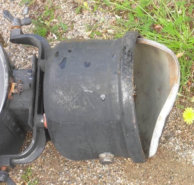

    The event was an annual pig roast which had been a regular event for some years and attended by about 50 or so relatives and friends of the host.
    The lamp in question is a Tilley FL6 made sometime in the 1950s. It was mounted on a tripod which is not a Tilley extending type but made of grey painted wood and is possibly a Danish Civil Defence issue type. The lamp was about 6 feet above ground with the controls at about head height.
    As it became dark the host of the event lit a Tilley FL6 mounted on a tripod to illuminate the area. After some time the lamp began leaking fuel which was burning as it flowed over the tank of the lamp and dripped onto the ground. One of the young ladies present attempted to extinguish the flames by throwing some water over the lamp and ground from a bottle of water she had been drinking from. When the bottle was empty she turned away and as she did so there was an explosion and a big ball of flame which engulfed her causing severe burns. She was rolled on the ground by some nearby people and the flames extinguished before she was taken to hospital. Although badly burnt she survived the incident. I don’t have details of the injuries sustained but in May 2016 the insurance company paid out compensation of $500,000 which may indicate the severity and long term effects.
    The host of the party indicated that he went to try to shut the valve off before the explosion but was unable to do so as the flames appeared to be leaking out of the valve itself. There had been some fire extinguishers in the area earlier in the day but at the time they seem to have been removed because none of the witnesses recall them being anywhere near and they were not used in this incident. One of the witnesses also attempted to turn the lamp off but the burning fuel prevented this and the lamp’s owner went to either get an extinguisher or a glove to enable him to access the valve but in the event this action was too late to prevent the explosion.
    This is an image of the lamp taken a few days after the event which clearly shows the base plate has been blasted open by a considerable internal pressure induced force.
    Below is my report and conclusions which I submitted to the Lawyer on the 8th April 2016.

    I am in no doubt that the failure of the Tank in this incident was the result of the failure of one of the seals at the control valve which caused a leak of liquid kerosene which ignited. It is possible but unlikely that one of the fixed gaskets between tank and valve or valve and vaporiser failed. These seals once installed correctly are not disturbed in use and if they were not leaking when the lamp was lit are not likely to have failed subsequently and I understand that the owner of the lamp had serviced the lamp with replacement seals as they were required so I would assume that these two gaskets were in fact sound and did not fail. The spindle seal within the gland nut however is subjected to intermittent movement when lighting the lamp and possibly also if it is necessary to operate the pricker when the lamp is working. This seal can therefore seem to be good on lighting but can start to pass fuel after operating and rotating the spindle. In fact it is common to have to tighten the gland nut when lighting the lamp or after operating the pricker. This gland seal is normally only just tight enough to seal the spindle. If it is too tight then it is difficult to operate the valve so it is nearly always only just tight enough and has to be inspected regularly because they routinely leak a little and have to be tightened. The gland nut is knurled and designed to be operated by hand without tools although most operators will tweak the gland nut with pliers. In an FL6 this gland nut can be difficult to access because it is within the casing of the lamp and not always presented facing forwards, it is also not always easy to see a leak here for the same reason that it is partially hidden by the lamp casing. Nevertheless an experienced and prudent operator should be aware of this potential leak point and will inspect it after each use of the control. The leaking and burning fuel then flooded over the tank and dripped burning to the ground. The burning fuel on the tank would have heated the air and fuel in the tank which greatly increased the internal pressure to the point where the base plate solder seal could no longer withstand the thrust imposed on it and the solder seal failed. In fact if the tank heated to a temperature where the kerosene began to boil then the pressure would have increased rapidly to an enormous degree. Such heating would also have softened the solder in the base plate seal and reduced its strength. This failure resulted in a sudden discharge of hot fuel and high pressure air. The combination of high pressure air and fuel atomised the kerosene into a fuel/air mixture which then exploded into a fire ball. Cold liquid kerosene will not burn freely but if it is atomised and warm then it forms an explosive mix.
    In this case I have to conclude that the operator of the lamp failed to notice that the gland was leaking on one of the occasions he operated the valve. It was not mentioned in any of the text I have read but perhaps the pricker was operated after the lamp had been running for a while. Once the leak and fire was noticed I suspect he was well aware of the danger of the burning fuel but perhaps did not consider the fact that the tank is actually a pressure vessel and that the heat was increasing the pressure to a dangerous degree. However there was one action he could have taken which might have prevented the failure. As the control was not accessible due to the burning fuel it might have been possible to unscrew the pump housing which would have released the air within the tank and the resultant drop in pressure would have shut the lamp off and removed the danger of a pressure failure leaving just some free burning fuel which could have easily been contained and made safe. Was he negligent? Well yes because he was the operator and the lamp leaked fuel after being lit and there was no attempt to release the pressure. Not in my opinion gross negligence as it was not because of carelessness but perhaps he was not as experienced a user as he liked to think nor was he aware of the nature of the beast being a pressure vessel as well as a light and that a pressure tank has its own potential for disaster.
    I have considered the suggestion that the small amount of water thrown at or near the lamp by Charleen might have been a contributing factor. This is not credible. These floodlights are Storm Lamps designed to operate in extreme weather conditions and they will happily function in the heaviest of rain storms. In fact it had been or was raining at the time and the lamp would have already been wet. It might have been useful to throw a few bucketfuls of water at the lamp because that might have cooled the tank and reduced the internal pressure but a pint or less would have had no effect at all.
    Throwing water onto a hydrocarbon fuel fire is not a good idea as the burning fuel will only float on the water which just enables the fire to spread faster. However this incident was caused by a pressure failure due to the burning fuel from a leak and not by water in any way.
    There was a suggestion that there might have been some effect of the water on the metal which helped to exacerbate the failure but I don’t believe this is possible either. As most of the lamps I deal with are made of brass I am familiar with how brass behaves under heating and cooling. Under heat brass can either soften or metals in the alloy. The brass in a Tilley tank will harden and can subsequently crack. Either way heating and then rapidly cooling anneals the metal so restoring its molecular integrity. So in this case adding water was in fact the right thing to do because it might have spread the fire a little but would have cooled the tank and prevented the pressure induced failure of the tank but it was too little to have any effect.

    "The fuel tank is made of a spun brass body" - don't you mean steel Neil? Did the FL6 ever come with a brass tank?
    I've always suspected these FL6 tanks are a bit dodgy. They have a base plate with a large surface area resulting in considerable downward force, but unlike say a Coleman CQ table lamp, there is no bar running through the center of the tank to support the center of the base plate.
    Then the rim of the tank is not rolled over the edge of the base plate like on a Petromax. This means there is only the solder joint holding the base plate in.
    Another problem is the FL6 pump cup has a large diameter which helps to pressurize the tank quickly but also allows it to be over-pressurized, as the smaller surface area of the pump on say an X246 lantern limits the maximum pressure that can be achieved by hand pumping alone.
    Are we sure they were using Kerosene and not Gasoline in the lamp?
    If Kerosene was running down from the control cock washer or vapouriser washer then it should not have caught fire unless it soaked into a wick of some sort on the ground and was then ignited (by what?). Unless I suppose the paraffin was coming out of the vapouriser either from a crack in the vapouriser or because the vapouriser had cooled for some reason and started dumping liquid fuel out of the jet, causing a flare-up that was left uncontrolled.

    FL6 lamps are unusual in that the valve is contained inside the lamp casing and there is no cooling air flow at that point so it can get hot enough for a leak at the gland to ignite. The witnesses all agree that there was burning fuel flowing over the tank and dripping down to the ground and causing a fire under the lamp on the grass. I must emphasise that I don't know where the leak was. The lamp was never inspected afterwards by any competent person so I had to speculate on the cause of the leak. I believe I have it right but I can't prove it. What I do know is that under normal use a Tilley tank will not fail in this way. The state of the tank in the image shows it suffered a catastrophic and sudden failure which can only be the result of a massive increase in pressure. Heating the air over the fuel would probably not be enough to do this so I assume the kero had started to vaporise. Boil anything in a confined space and you get a high pressure vapour.
    So it ain't perfect but there is no argument that there was a fuel leak and that the lamp base failed which caused a seriuous injury to a young lady who has to live with the consequence. ::Neil::

    Well yes the solder may have been weakened by the heat but you can see in the image that this was not a gradual failure but sudden and catastrophic. So there can be little doubt it was a shear failure of the base plate seam. That can only have been from a very high pressure in the tank. Just heating the air above the fuel would probably not have achieved such a high pressure so I still believe the kerosene boiled and that would have induced a sudden rapid pressure increase. With no safety release an explosion or failure was inevitable. Boil any liquid in a confined space and when the liquid reaches vapourisation point the liquid flashes into gas. This is the power that moves steam trains weighing hundreds of tons and is not to be taken lightly. ::Neil::
