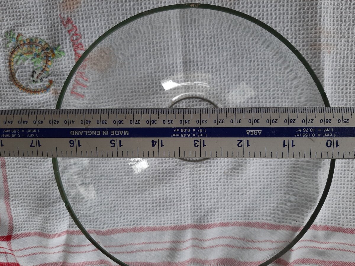

    Would anyone have the exact sizing or measurements for globe for a Tilley GL1 general purpose lamp? Looking to get one made was hoping someone could help. Even though I have the lamp and can do my own measurements just thought someone may have them already off an original globe? Any help would be greatly appreciated

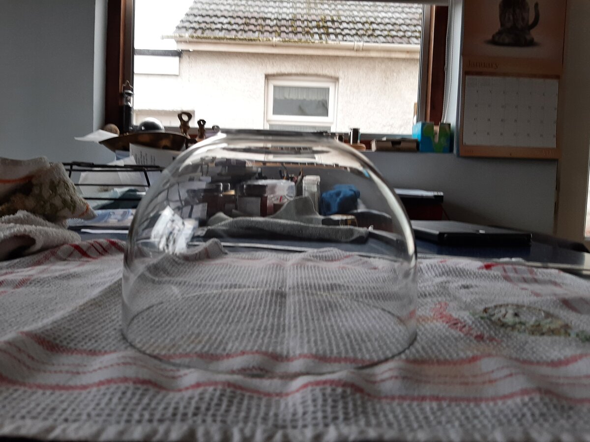

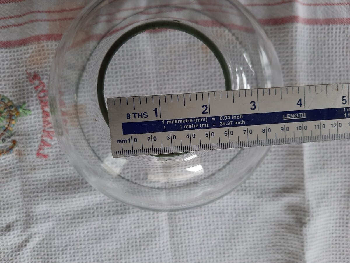

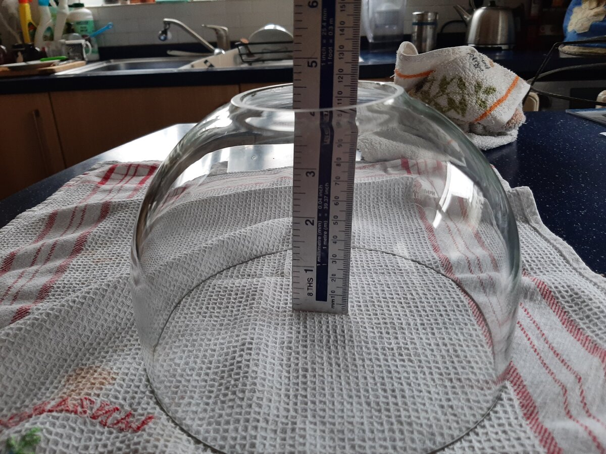

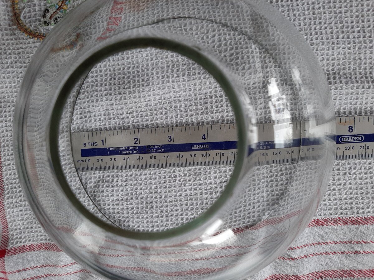

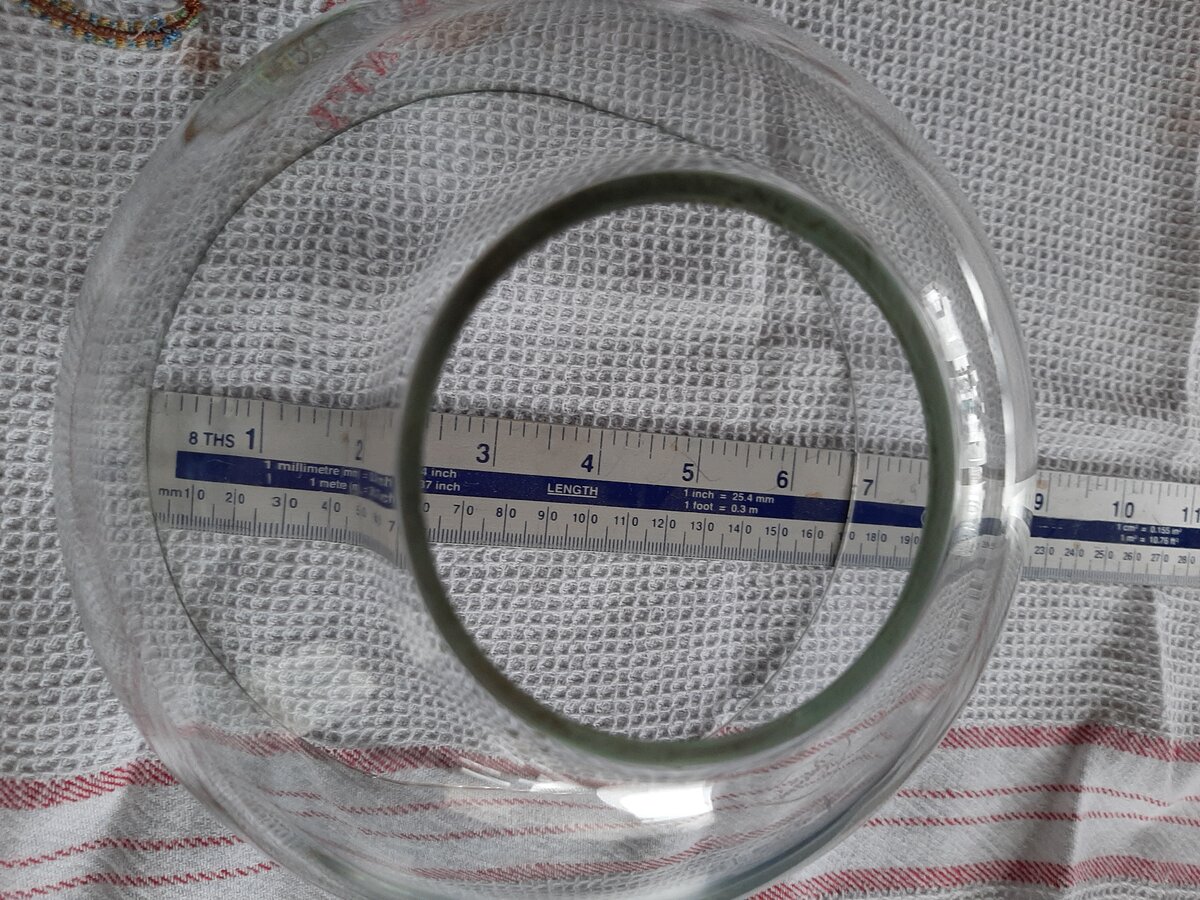

    I have a GL1 with the Correct glass and would be happy to take some pictures and dimensions. Please contact me directly and I'll be happy to help.

    @astroboy
    I know I had some pictures somewhere - just found them.
    Let me know if you need any more.
    And please let me know if you can find somewhere to make a new globe as I have a GL1 which needs one!

    Thank you, @tilleyscout.
    Those measurements are very valuable.
