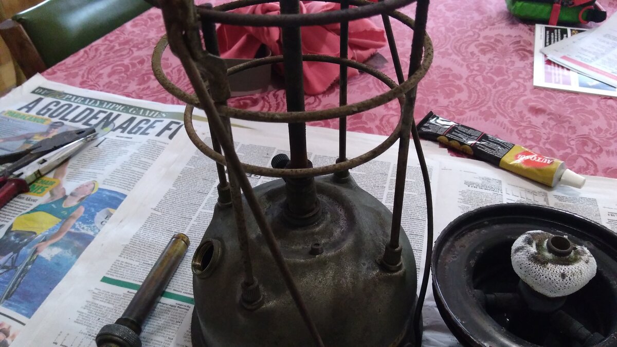

    I have an old guardsman that's been hanging in the garden shed for years. it gets the occasional use as the shed is un-powered and always works well. the last few years its been ignored and due to the environment it lives in has deteriorated some what.
    so thanks to this forum sparking my interest have decided to clean it up and keep it on a shelf inside the house with my small collection of pressure lamps
    on the bottom of the tank is stamped 1060XA. what does this mean? would the 10 designate the month, ie October and 60 is the year as in 1960? XA being a model?
    anyway, gave the old lamp a bit of a once over. I used Autosol metal polish and finished with the same brand but in marine grade metal polish on the fount and I'm surprised it came up as good as it did.
    the frame I wired brush and emeried polished back to bare metal then sprayed it with heat resisting engine enamel.
    the globe seems original, a bit deeper than the newer globes and has a small crack, but I'm not worried about that and the hood is somewhat burnt but still functional and reasonable
    fresh kero and lit it. had it going for five hours last night and held pressure ok. slight leak somehwere near where the cock or vaporisor attaches but nipped it up with a pair of pliers. I'll order a service kit for it just to be sure all is ok and will use it on my next camping trip. have to say these old lamps seem easier to pump than the more modern lamps, or maybe the pump leather is just well worn in
    before shot
    after shot
    in action
