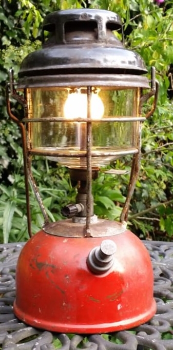

    I have a ratty X246B that runs surprisingly well in spite of the fact that it is quite rusty.
    I noticed that the mantle was acquiring a number of pinholes and I believe these to result from loose rust particles falling from the rusty hood above. I decided to take it apart for a de-rust.
    I used a wire brush on the loose stuff and to discourage the plague coming back I thought some chemical conversion treatment at the rust sites would be worthwhile. I had a choice of some Jenolite, very old and not much left, or some Hammerite Kurust which looked unopened. I picked on the latter.
    It is thicker than Jenolite and it could be applied with a paint brush and left to soak. I did that, also applying some to the lower part of the vapouriser which was red rusty too. I came back to them around 5 hours later.
    I had expected that the bare metal/rust sites would be dark - they were. I did not expect the enamel to be affected. It was. Where there was a good quantity of the Kurust sitting as a puddle the enamel appears to have lifted. The vapouriser sat inside the hood (somewhere for it to drip) and it was stuck to the rim by black goo.
    It was all easily removed but now the enamel is stripey in appearance (no worse than the rust was) but I really did not expect this. I thought it was vitreous and so would be pretty immune to anything like that.
    I don't think it had been over painted with anything else. I wonder what goes on?
    Have I accidentally found a way to remove the enamel from hoods? It can't be.

    As the lamp in question is not from the mid 1960s but probably more like the 1970s I begin to think the hood is not vitreous coated at all.
    I have been looking up Fusion Bonded Epoxy Coating - also known by the short name powder coating.
    (seems to date from mid 1960's onwards)
    I'm not yet sure whether that might handle the operating temps of a hood, but it does say it will coat steel when it is applied at temperatures between 180-250C. Once it has cured it is irreversible - oh yes? Up to what temperature we wonder?
    Maybe that is what Kurust can attack and soften? If so maybe some powder coating can be found to make repairs to hoods? This one looked OK except where the rust had broken through. Here is a before picture.
