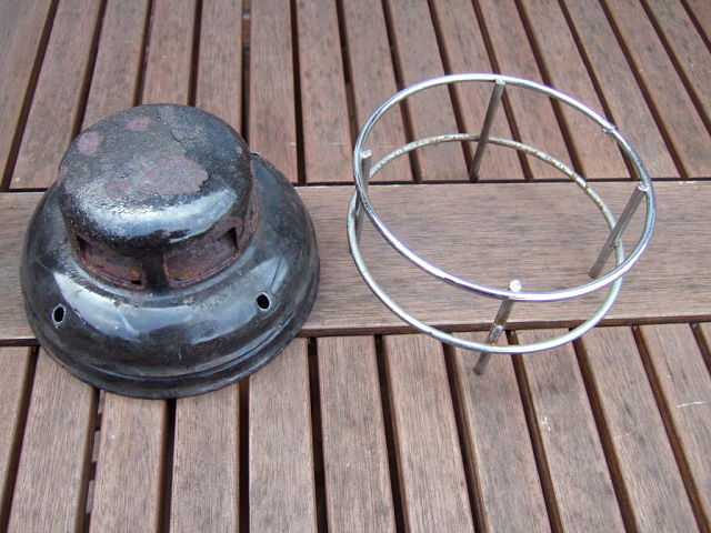

  23. David Shouksmith

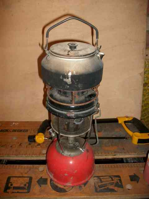

    Well, I went shopping in Aldi today and by coincidence, they had cheap Chinese hacksaws for sale. Hence I bought one and I'm just off to the garage to perform some non-elective surgery on an X246/A/B globe cage. I've been busy otherwise I would have done it earlier.
    So watch this space also... :lol:
    Edit:-
    So there we are - "a true modern rarity" (or not, as the case may be). I suspect not because it slips around all over the place and is hardly safe for boiling or cooking anything on. At first, I left small legs about 5mm long at the bottom but it was unstable so I cut them off, thinking the lower ring would get a better purchase on the enamel top. If anything it's worse. :doh:
    It's going in the bin... :roll:
    Further edit - looking at the original pictured above, has it got an annular metal plate at the bottom to locate it around the taller part of the ventilator..?

  25. loco7lamp
    loco7lamp Subscriber
    Sep 21, 2011
    778
    Hi David
    If you look at the left hand rearish side of the pic you can see the slope of the hood air inlet cover so i'm not sure if there is a plate , maybe just dirt looking like it , i may be wrong but the hood may be drilled to accept some longer bits of the stub legs you cut off this would make it very stable & useable , what do you reckon :?: :D :thumbup:
    & don't bin the ring :shock: put a pop can stove or some other meths stove under it for a great little stove :thumbup: :D
    Stu :D
  26. David Shouksmith
    True, but if you look at the other side, it looks flat. Also there seems to be a distinct 'edge' where the vertical side of the upper hood meets the horizontal-ish lower part - it's usually a small radius curve there.
    But as someone said, it's not a good pic and we'll see when the lantern arives...

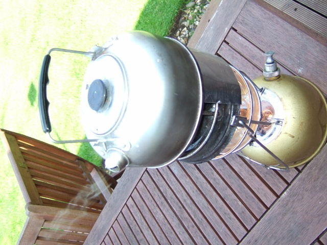

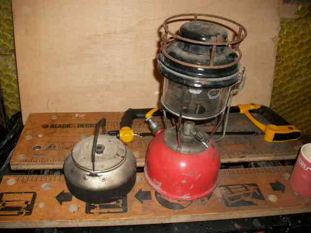

  28. loco7lamp
    Sep 21, 2011
    778
    Hi All
    Tried out the Tilley top rail heater idea today , it does work but took 20 mins to boil a pint of water :doh: . I drilled some 5.5mm holes to locate the rail this made it super secure , The leg stubs were cut to 3/4 inch length :D :thumbup:
    It did work a little faster when i made a simple one sided wind break to help keep the heat from being blown away , a complete wind shield around the inside of the rail with a 3/4 inch exhaust gap around the top would seem to be the way to go :D :thumbup:
    Pic's :D :thumbup:
    Stu :D
  29. JEFF JOHNSON
    16,656
    Hello Stu, neat fettling! :thumbup:
    I rigged something similar many years ago and it worked well enough in the shed, but for outside use your idea of a complete windshield is the way to go, Jeff.
