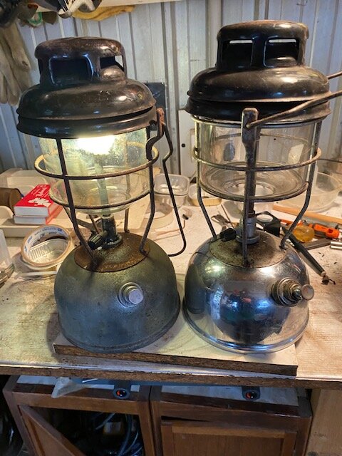

  19. Julian Whittaker
    Dec 9, 2021
    287
    Greendale Vic
    THX Tony. Here's 2 of mine. The cosmetically challenged one on the left burns beautifully, -it had a leak which I've fixed. Are they X246 or X359?
    Can't find a model number stamped on them. Next I'll work on the prettier one - which was the one I referred to in my previous post! (unless the dragon kicks up a fuss! :rage:)
  20. Tony Press
    They are both X246B.
  21. Julian Whittaker
    Dec 9, 2021
    287
    Greendale Vic
    Thanks Tony. I'm going to have to investigate mine further, as the good one is quite inconsistent. One day it'll run really well, the next day it won't want to run. Though I must admit I'm using a 'lash-up' mantle. Maybe that's the problem.
