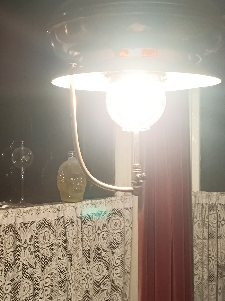

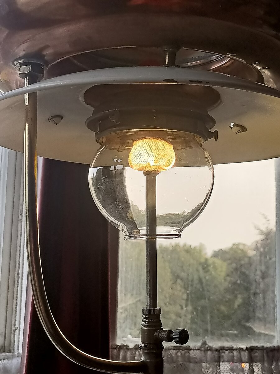

    I must admit after doing many procedures and experiments, I do not understand what is going on here!

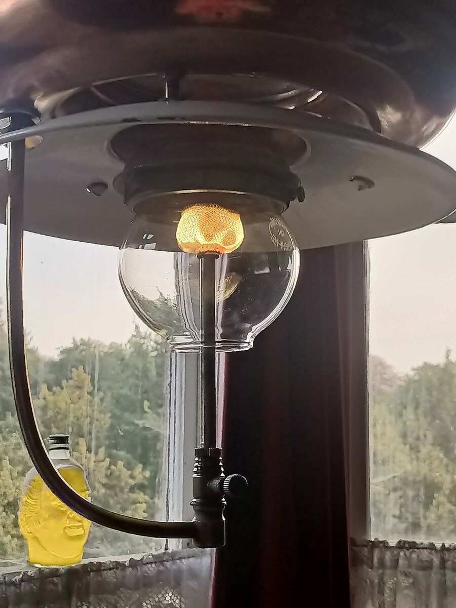

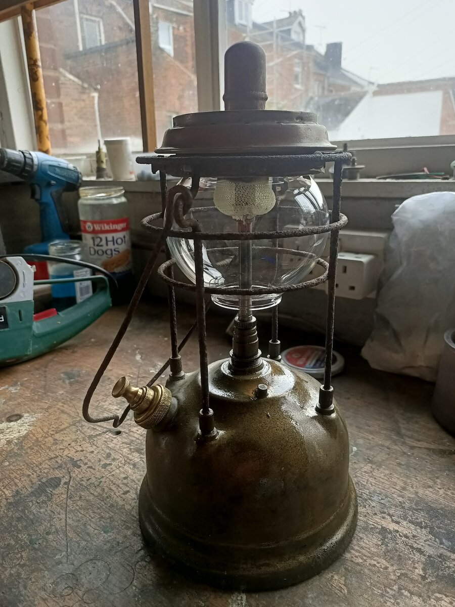

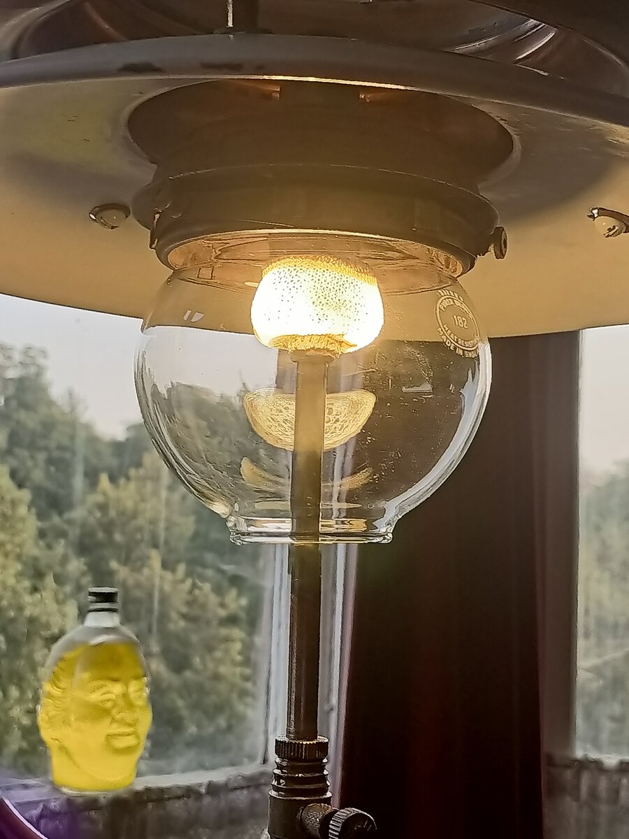

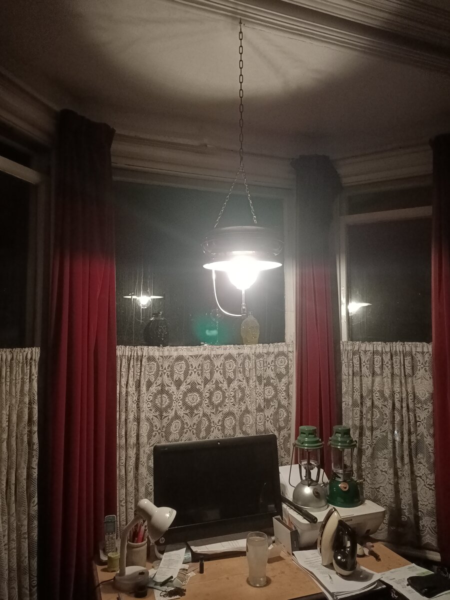

    The mantle (70s vintage) in my overhead IL47 lamp lights up good and bright, but after around 3 minutes, whilst still making the same hiss, the mantle is no more of an uneven orange colour. Can anyone explain what is going on?
    The paraffin is the same stuff which burns well in other lamps, the tank was rinsed out, and I'm using a new old stock vaporiser which had also been rinsed. I am also pretty sure that the burner was tested on another lamp and was ok. I attach photos.
    PS when it has gone dull, waiting and relighting starts of bright again!? Photos attached. Really grateful for some help on this! IMG20230906191839.jpg IMG20230906192332.jpg IMG20230906192141.jpg IMG20230906192013.jpg

    When the symptoms occur does the burner dome glow red or faintly red? It may be a trick of the light in the 3rd and 4th photos

    From your photos I think I can tell that the top of the carburetor is glowing red. This could indicate a problem with oxidation of the fuel inside the mixing chamber. In that case, I would suggest replacing the component and observing if the problem persists.
    I had observed the same problem with an Optimus lantern (though a completely different design), which reliably occurred after a certain burning time. Ultimately, only the replacement of the vaporizer helped, although it was in pristine condition.

    Thanks for your thoughts, as with everyone else's, they are appreciated. Today I did the simple test of trying again with a new vaporiser on another lamp, and lo and behold, the same effect. THIS time I let it run longer, being in the workshop (and not in the night-time, in my bedroom with fire alarms all around) and yes the upper part of the burner GLOWED so I was wrong, and those of you that spotted it were on the ball! I thank you.
    Now I don't care what happens to the burner, if I can't get it apart, because I can substitute it for another, but I AM curious to know what is wrong. I'll try to attach a video which shows clearly what done of you pointed out to me. Again thanks to all concerned.

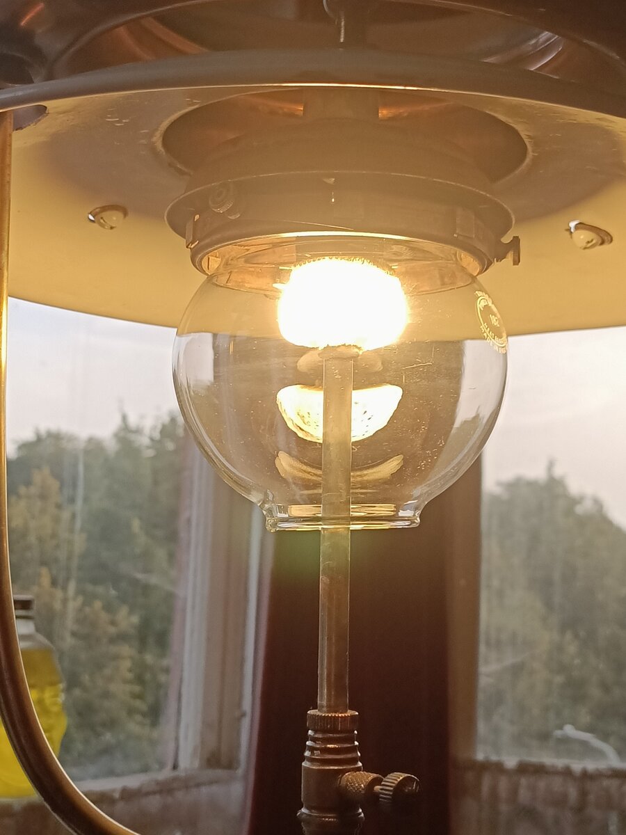

    The mystery had been solved, and I am so grateful for ALL the input from members of the forum. I have gained some valuable insight as to how the Tilley burner works, and how it can fail at the end of its life. I'm still learning, but to summarise what I now feel I know:
    The fuel, mantle, vapouriser and gallery are fine. The amount of fuel and pressure were OK as well.
    The symptoms were: dull burning 2minutes after initial brightness, while normal burner noise, a more noticeable combustion smell (though not TOO powerful) and GLOWING burner dome. The fuel was indeed burning inside the upper part of the burner - maybe like a Bunsen burner does when it "strikes back" causing the chimney the get very hot.
    This burner looked distressed, the breather tubes were bent up a bit, and the vapouriser was rusted into the spigot, needing cutting off and drilling out.
    Maybe everything I'm writing is completely obvious, or well known but I just wanted to record my experience just in case it helps another. So grateful for the help and advice. The photos were taken around 10 mins apart - time enough for things to go wrong if they were going to : and they didn't. Good old Tilley lamps! IMG20230907221213.jpg IMG20230907221758.jpg
