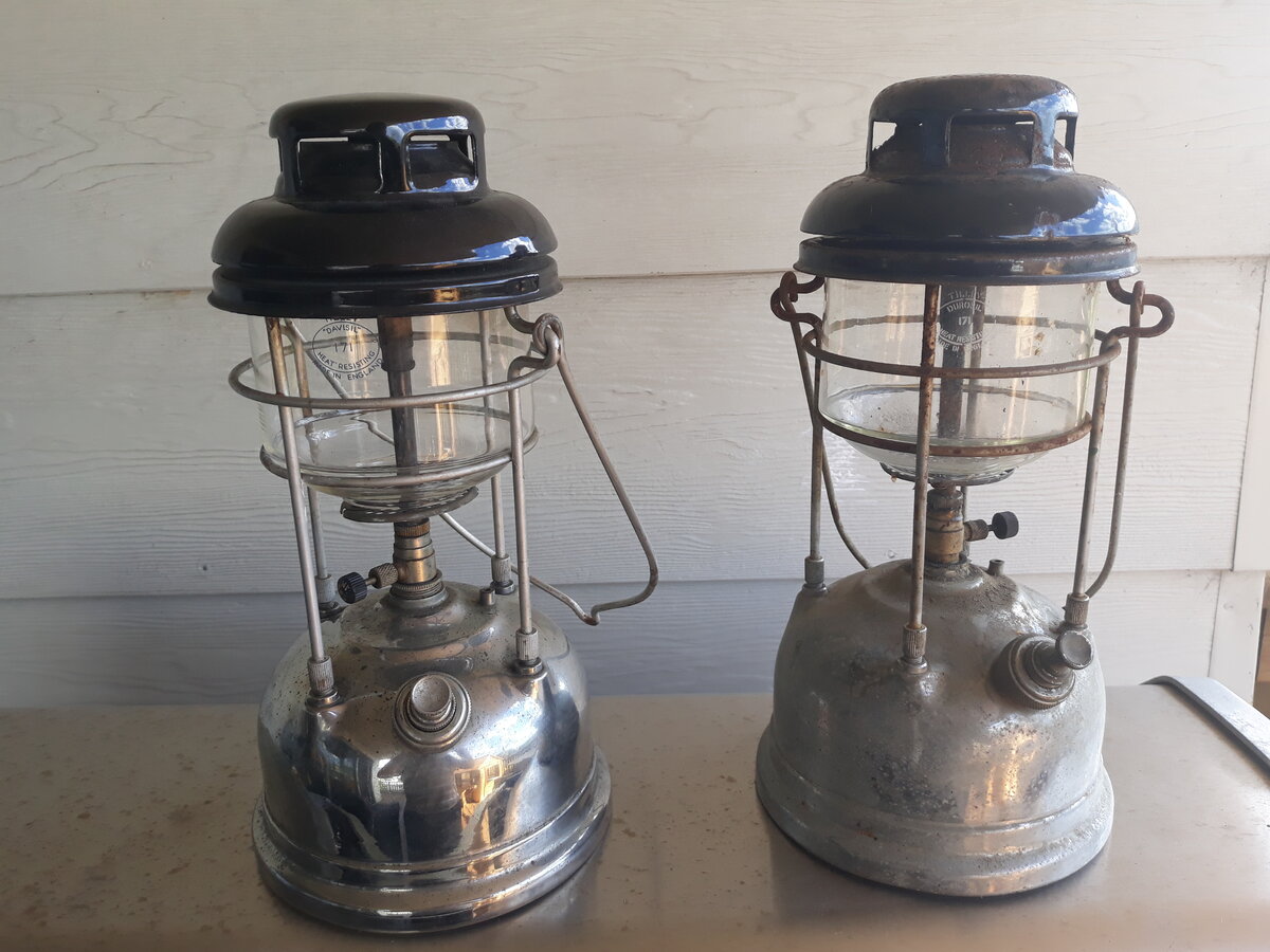

    Hi All,
    I have just bought these two lamps, I've just had a hankering lately to be reminded of the camping holidays I had as a kid with my Mum and Dad.
    It was always exciting watching Dad light the Primus or the Tilley lamps, waiting for the flare up that happened often, lol, though I'm not sure those were the actual brands but thats what we called them.
    I've ordered a couple of service kits from Fettlebox so hope to get fettling soon!
    John

    Those are two nice 246 Guardsman's, dating from 1950 to 54.
    They should clean up nicely. :thumbup:

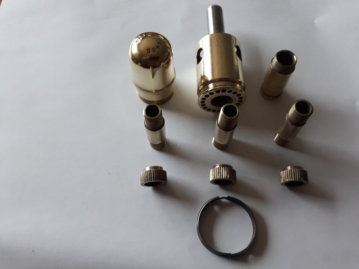

    Hi All,
    I have dissasembled and cleaned both my lamps, the shiny one I decided to clean more thoroughly, polishing the brass fittings and vapouriser tube. On the other one I cleaned the parts with a soft brass brush.
    I have assembled the lamps with seal kits from Fettlebox and did the dunk test, no problems there, which was good!

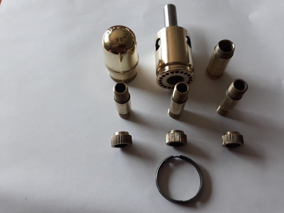

    My one query is on the burner assembly I have a split ring sitting in the groove, I guess this is to hold the mantle but all of the videos I have seen show the mantle being tied around this groove, so my question is do I need the split rings or are they redundant when using tied mantles?
    I am awaiting the pre-heaters from the uk, once I have got them here I will post some photos up.
    Cheers.
  12. BigStevie
    @JohnH
    The split ring on the bottom of the burner is the remains of a Tilley ‘happy’ mantle. These mantles came with the steel ring woven in, you’ll only find these mantles as NOS these days. Modern Tilley marketed mantles just slip on the burner.
    They’re easy to use, I guess costs in manufacturing put paid to the design...
    So, to answer your questions, you don’t need the ring!

    thank you for your reply, I can remove them from the burner assembly then.
  14. Tony Press
    11,061
    Yes, remove them. They get in the way, otherwise.

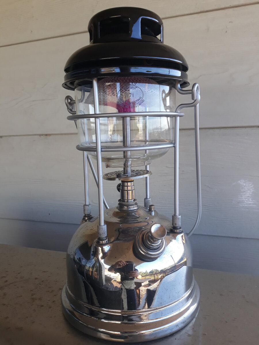

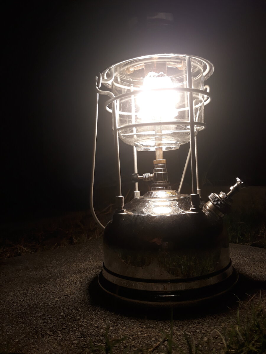

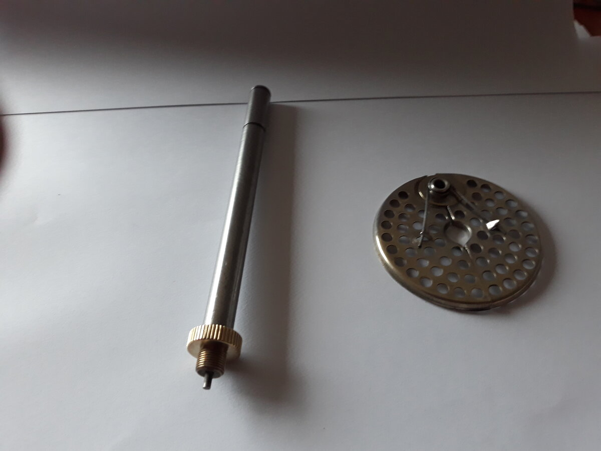

    I completed my lamps today!
    A few photos leading up to the first light up! This is the shinier of the two lamps. I'm quite pleased with the way it looks but not sure if I will keep it polished.
    Burner Disassembled.jpg Burner Assembled.jpg Vapouriser and Insect shield.jpg Finished.jpg First light.jpg
    Thanks to all on here that have commented and answered my newbie questions!
  16. Sedgman
    1,287
    Victoria, Australia
    Very nice unit. Well done. :thumbup:
  17. Tony Press
    11,061
    Good stuff. :thumbup:
    Edit: turn the insect shield up the other way.

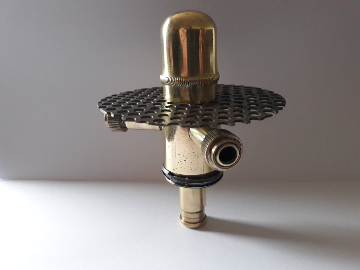

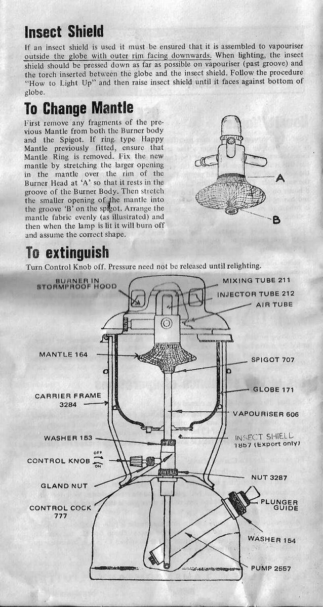

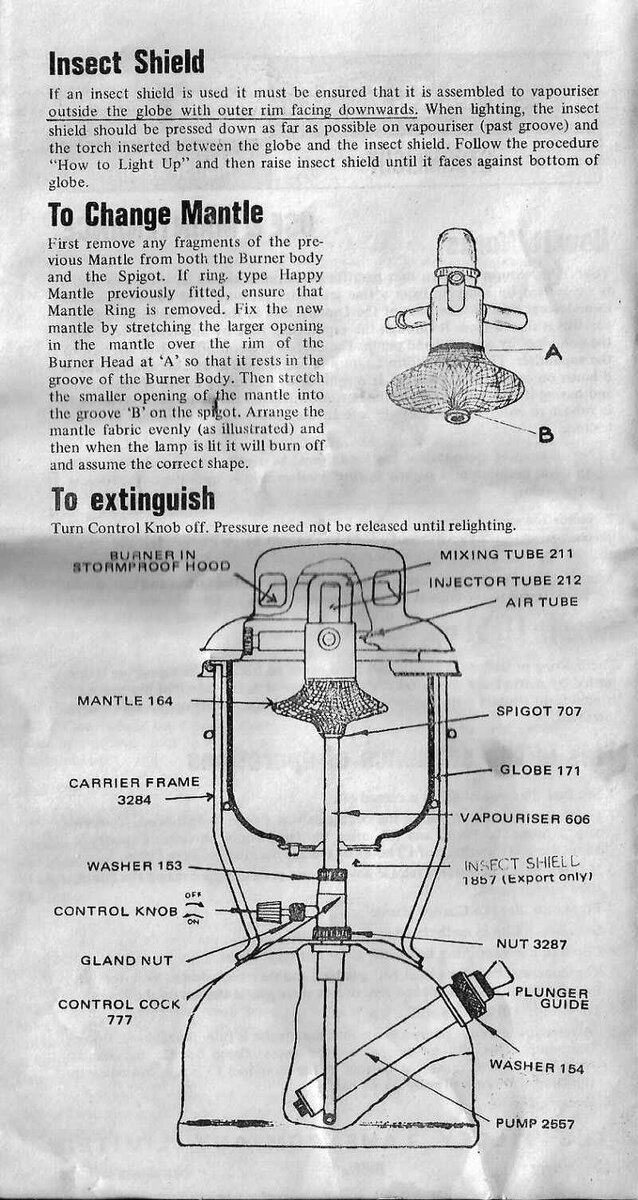

    @Tony Press I thought it looked a better fit the other way up but as I didn't know I followed the instructions for a X246B, or is the bug shield different on them. Or have I misunderstood?
    John
  21. Henry Plews
    3,053
    The modern insect screen as found on the X246B is concave and if fitted with the rim facing upwards there isn't enough room between it and the glass to fit the meths torch.
  22. Tony Press
    11,061
    @JohnH
    I write this yesterday and didn’t press the send button…
    That's a good point... I've not seen that illustration before.
    The later "dished" version is supposed to be placed with the convex side facing the top. The description in the text says "pressed down" and "raised" which you don't need to do with the butterfly insect shield; but need to do with the later version.
    I'll have to look at some other illustrations... I'm quite happy to be wrong!
    Anyway, they do a good job of inhibiting the damage caused by kamikaze moths either way round.

    @Tony Press and @Henry Plews Thank you for the explanation that the X246B shield is different, as I said that was the only reference to it that I found. I have now turned the shields the other way up so that the globe sits within the rim of the shield, which does look more correct!
