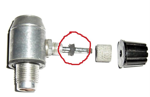

    Still leaking I changed the valve cock seal as well
  2. Henry Plews
    3,073
    Do you mean this one ?

  3. Darren Oreilly Ireland
    Aug 13, 2020
    18
    Ireland
    Yep I changed that one

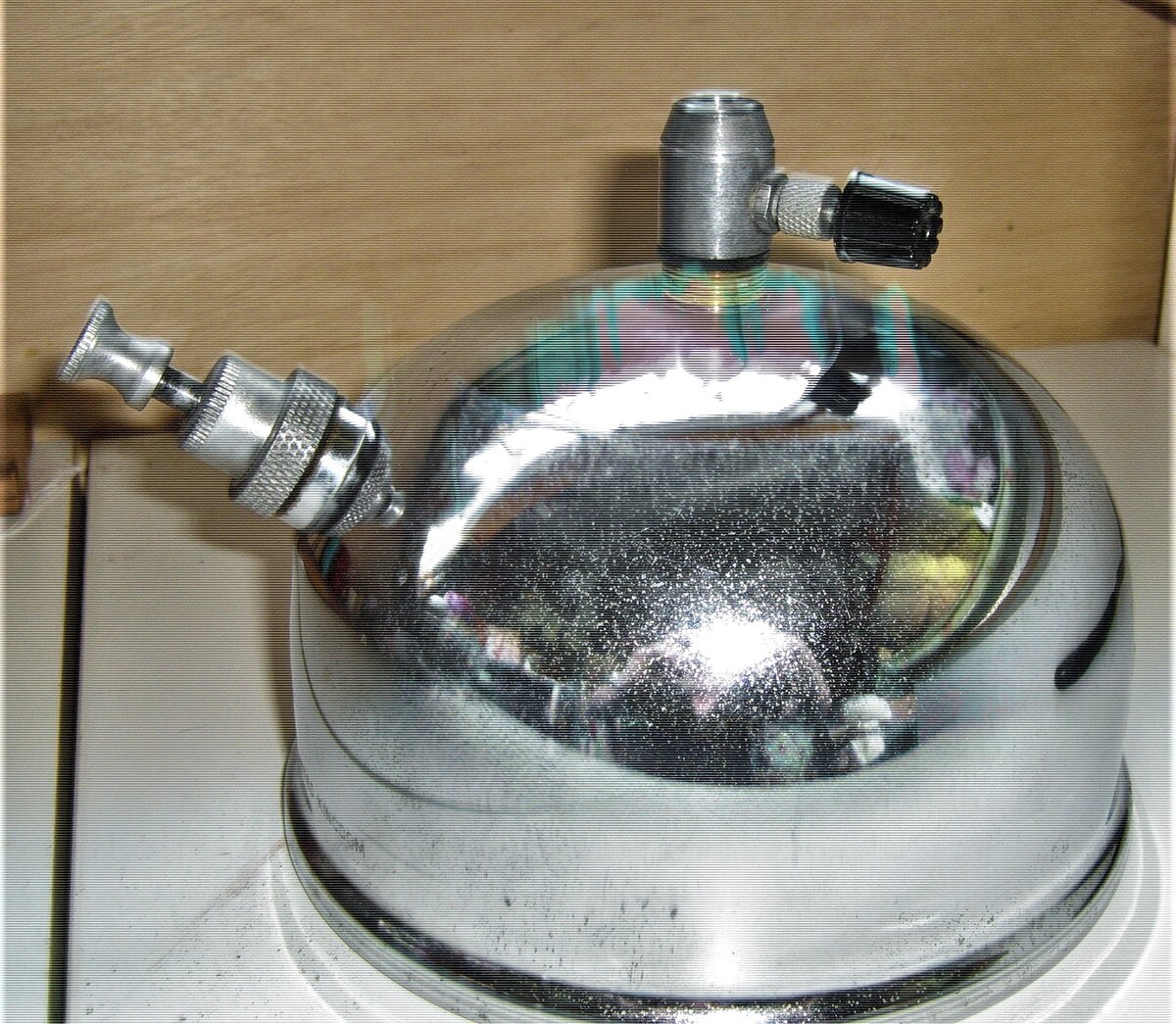

    Make sure the control cock is in the OFF position and give 100 pump strokes.
    Hold the b@$*@%d thing under water as if you are trying to drown it.
    Air bubbles will indicate exactly where the leak is.
    Once we know where the leak is, we can figure out the best way to fix it.
