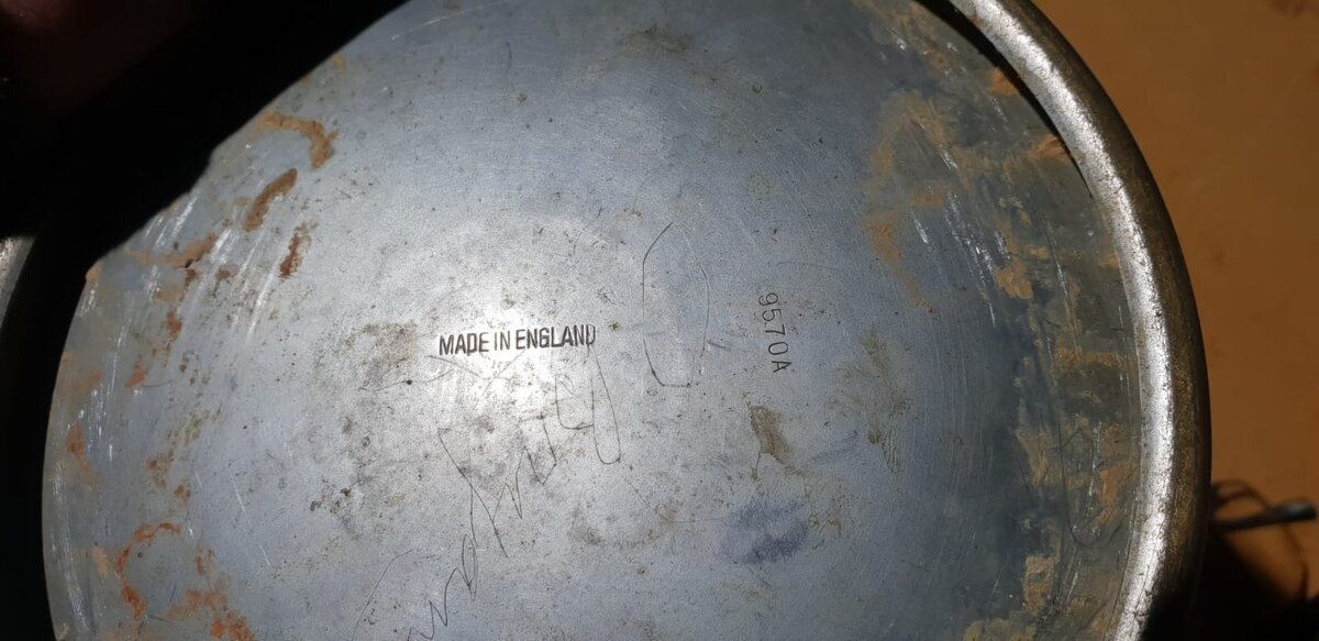

    Need to locate a globe for the attached lamp (will post in the Wanted section) but first I am looking for confirmation it is a Tilley X246 manufactured in Sept 1957. (Date code 9570A)
    Thanks in advance, Graham

  2. Buggerlugs
    It's a X246

    Nottingham UK
    Yup .. X246 Guardsman font with 171 Globe .. Early with its Owl emblem.

    31
    I was wondering the same thing as I believed the Date Code 9570A means it was a Sept 1957 build. Anyone know what the "0A" means?

  7. Buggerlugs
    Maybe the same answer as the XA, which no one knows as far as I have seen on here
  8. Tony Press
    @Graham-Melbourne
    The letters after the numbers on Tilleys have not been deciphered.
    Your date is correct.

    Nottingham UK
    From my understanding, Tilley stopped using the stamped emblem during 'Gaurdsman' style font production, obviously after 57 lol.

  11. David Shouksmith
    That's an X246 as has been said, typical for 1957 but you can't always tell just by a quick glance. There's actually a cross-over model between the X246 and the X246A. See here:-
    1961 (August) X246 'Guardsman' - or is it?
  12. Tony Press
    I still don’t understand your comment.
    The “Guardsman“ X246 was first produced in 1949. Up to at least late 1954 it had no stampings at all. The “owl” came later.

    I stand corrected..:content:
