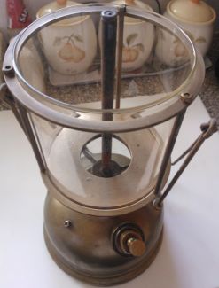

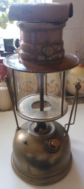

    Hi guys I was hoping someone could help me identify what model this is i'm guessing its a PL52 but i've not seen another like it before even the pump is a little bit diffrent
    The glass is a tilley 2081 if that helps theres no other markings that i can see
    Many thanks in advanced

  2. David Shouksmith
    What's holding up the globe cage - skyhooks? It looks like an early-ish (1930-35 at a guess) PL53 which has been modified for some reason to accept a different globe arrangement.
    The 2081 globe was originally fitted to much later gas lamps...

    Findhorn, Scotland
    It's a PL 52 with some very neatly executed DIY additions. If it came from the factory like that, I will eat my Tilley hat.
    To be frank I do not think it is what it was sold as and I would be raising an 'Item not as described' case against the seller.

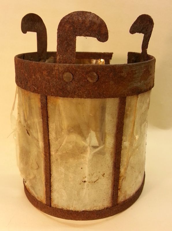

    1,152
    I think there was an eBayer selling PL53s with a Fred Kuntz mica globe on it and passing them off as "rare" PL52s.
    Is there any way to tell a PL53 from a PL52 apart from the presence of the mica shade? Would the PL52 tank have a decal with PL52 on it.
    Does anyone actually own a PL52 with an original shade?

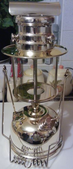

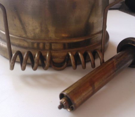

    16
    Thanks for the informaton i've spent the afternoon cleaning it up and really like the way it looks even if its not a factory tilley its still a nice lamp to me i've added some more photos of the under side

    16,886
    It's cleaned up well and whoever made that adaption did a fine job! :thumbup:
