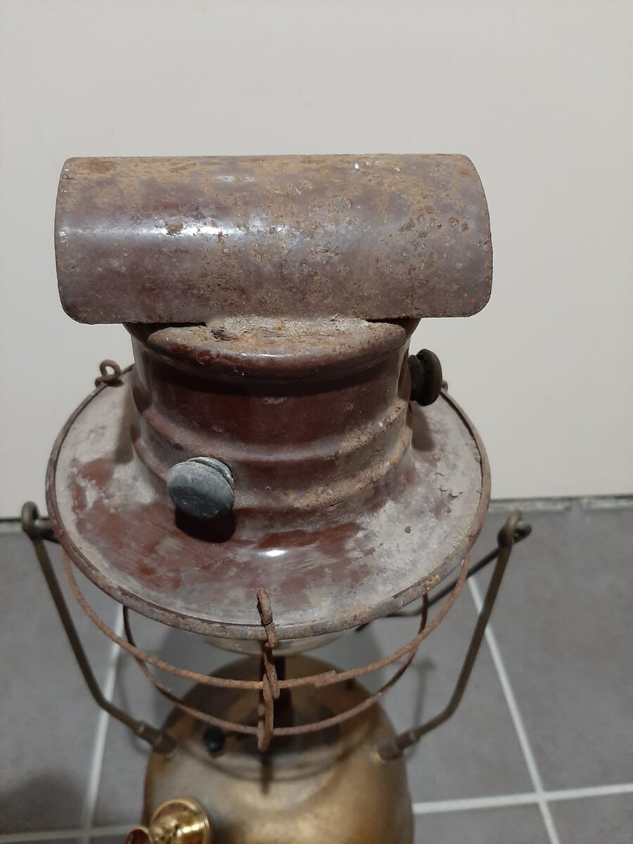

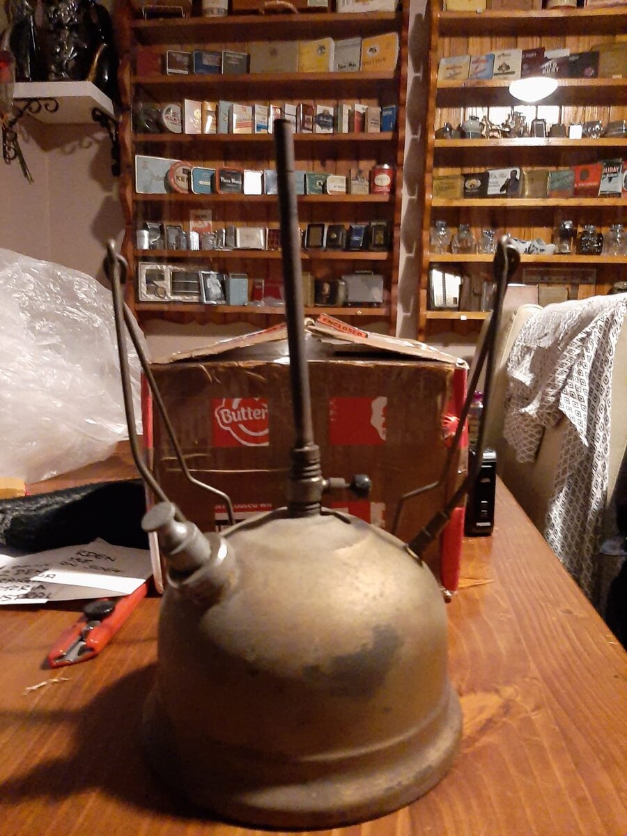

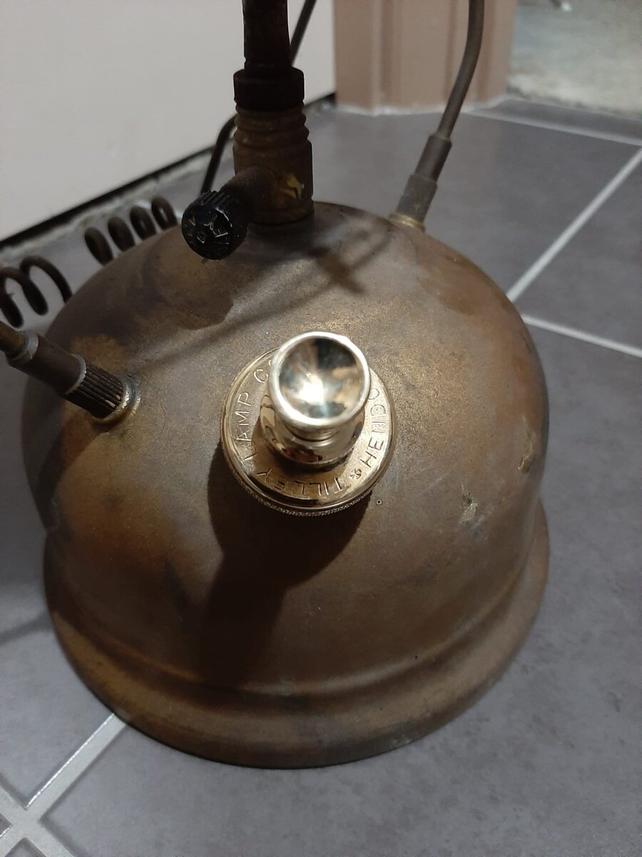

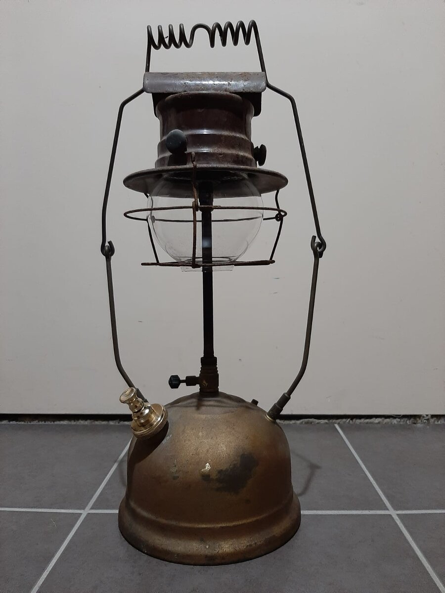

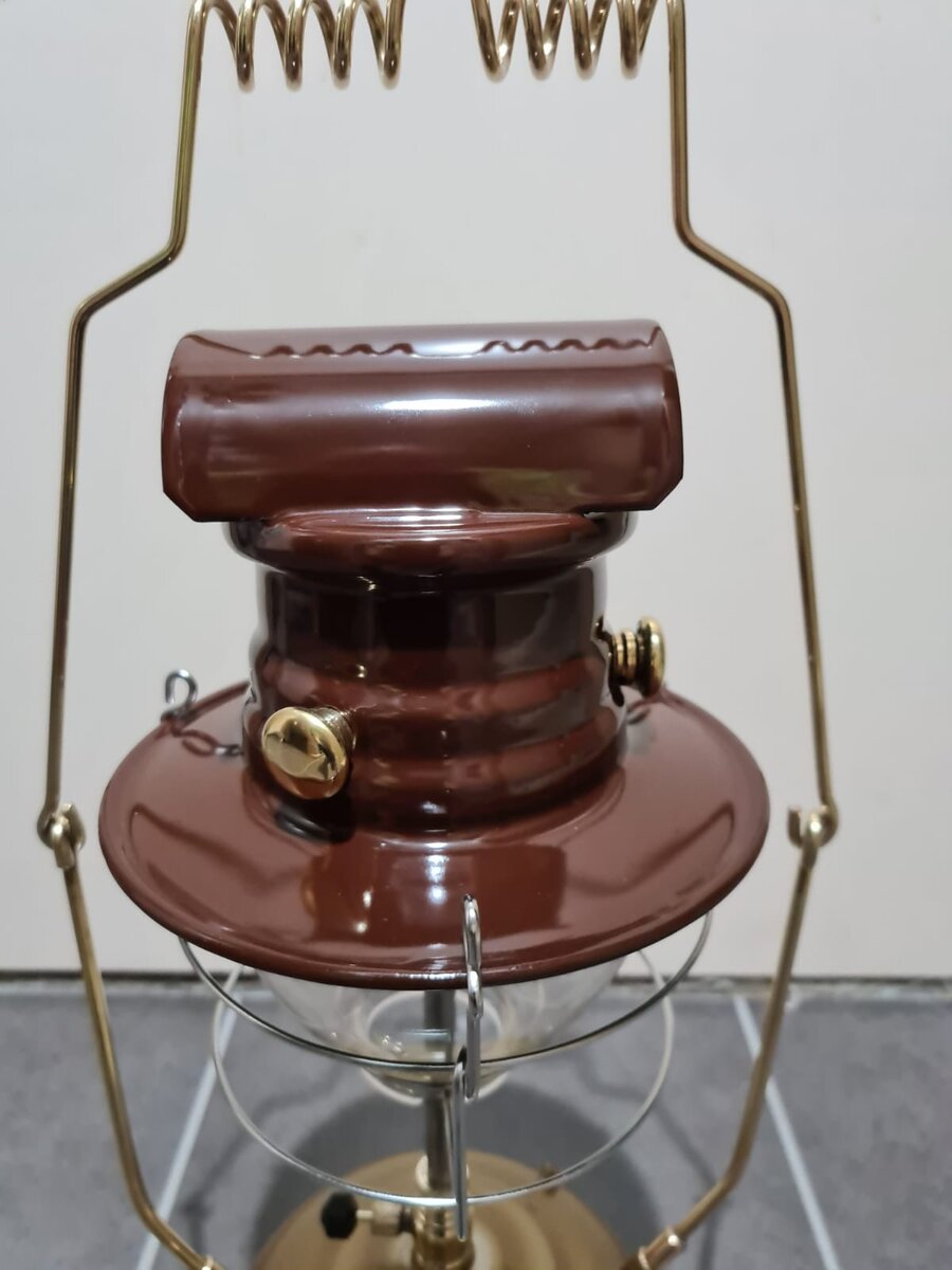

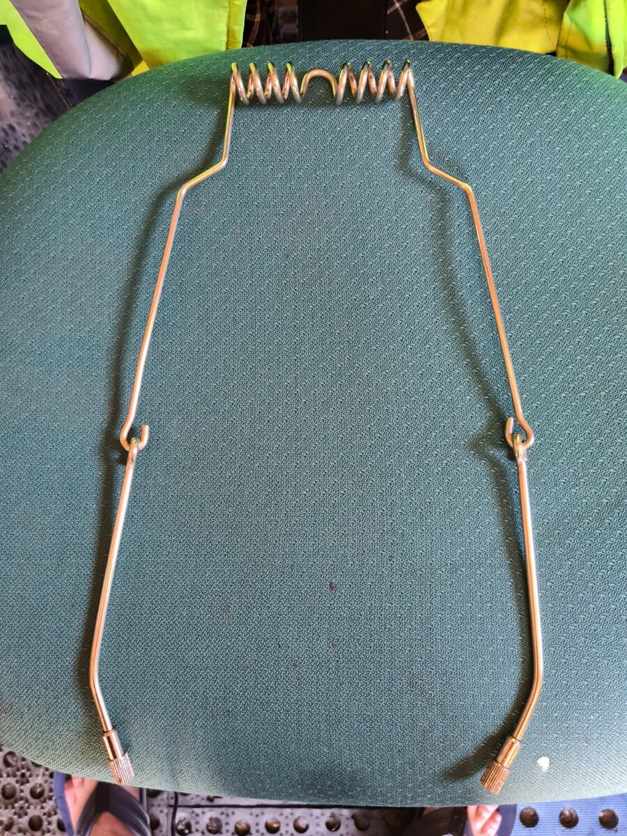

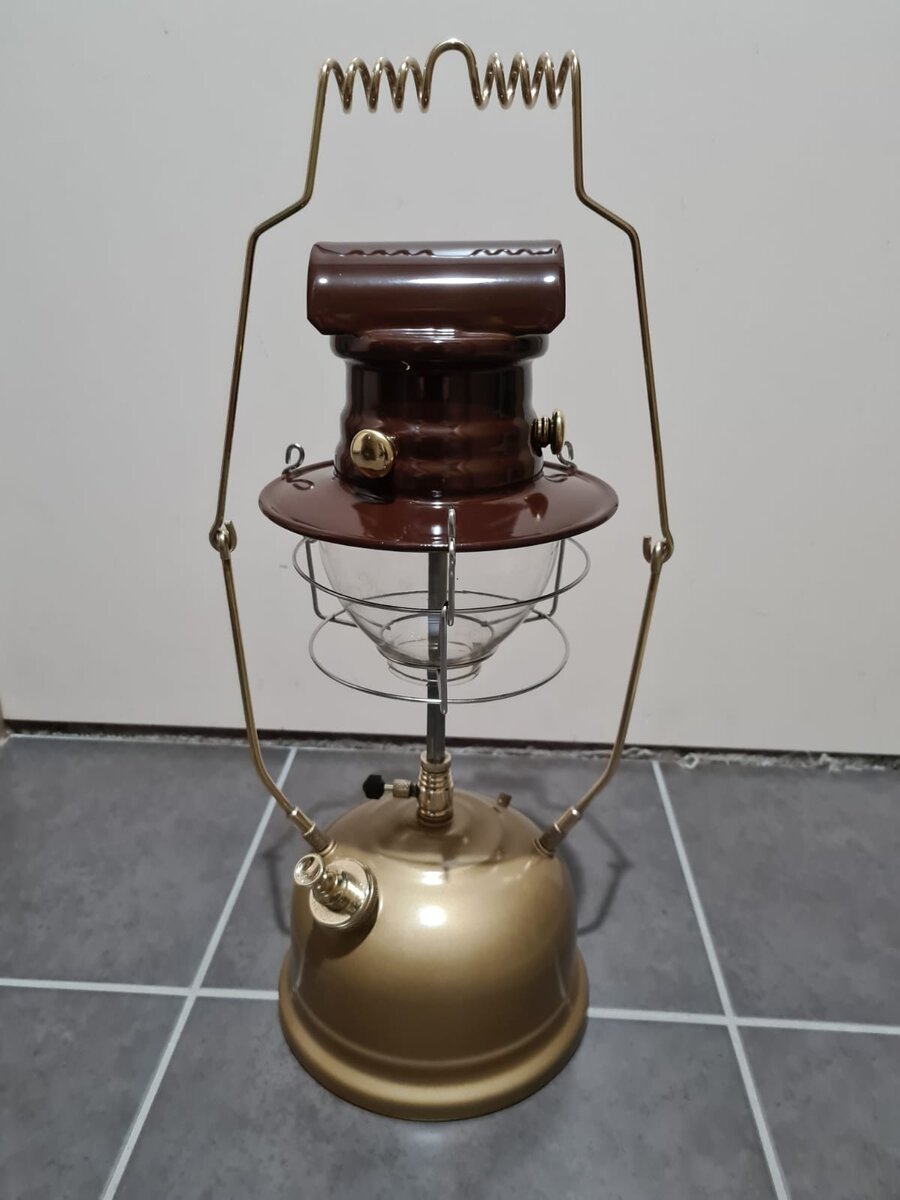

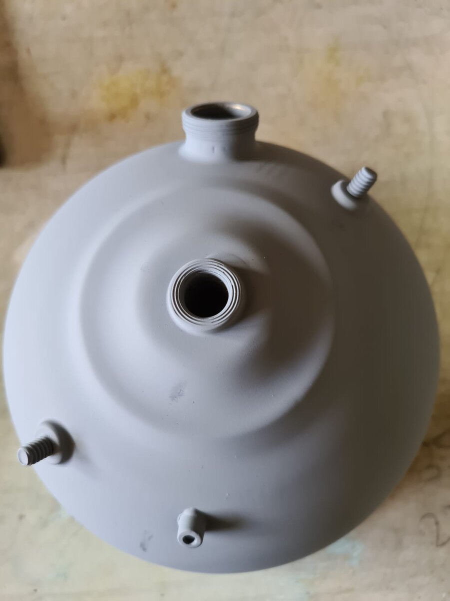

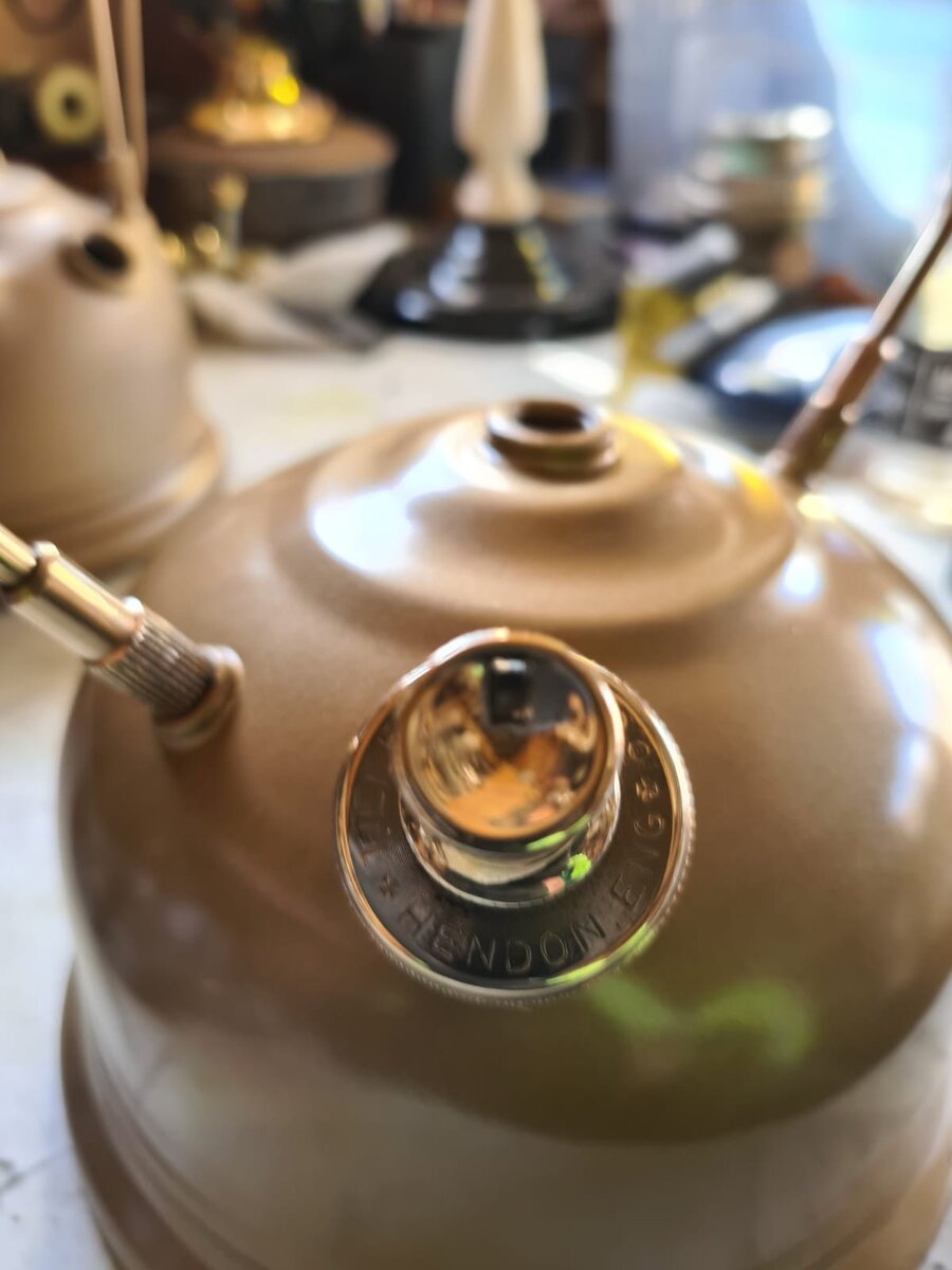

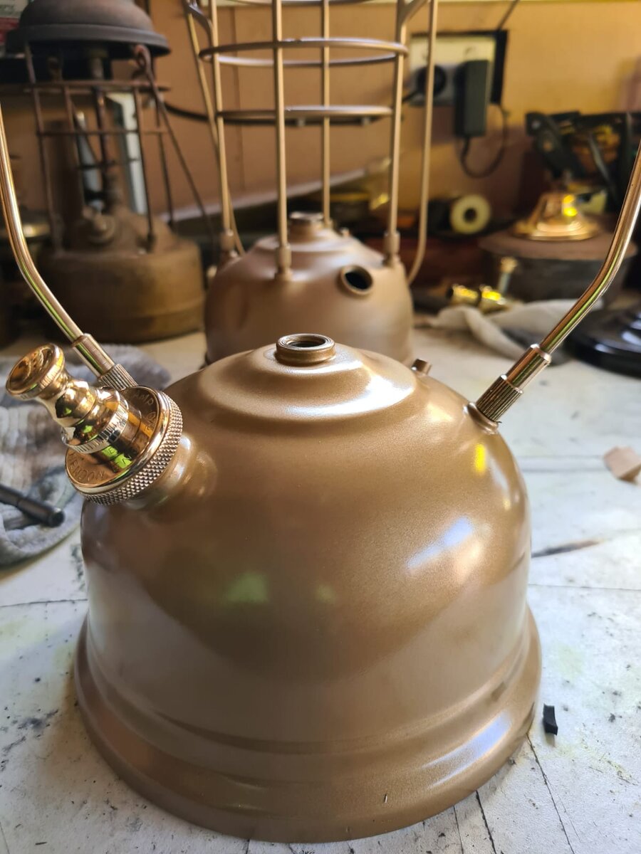

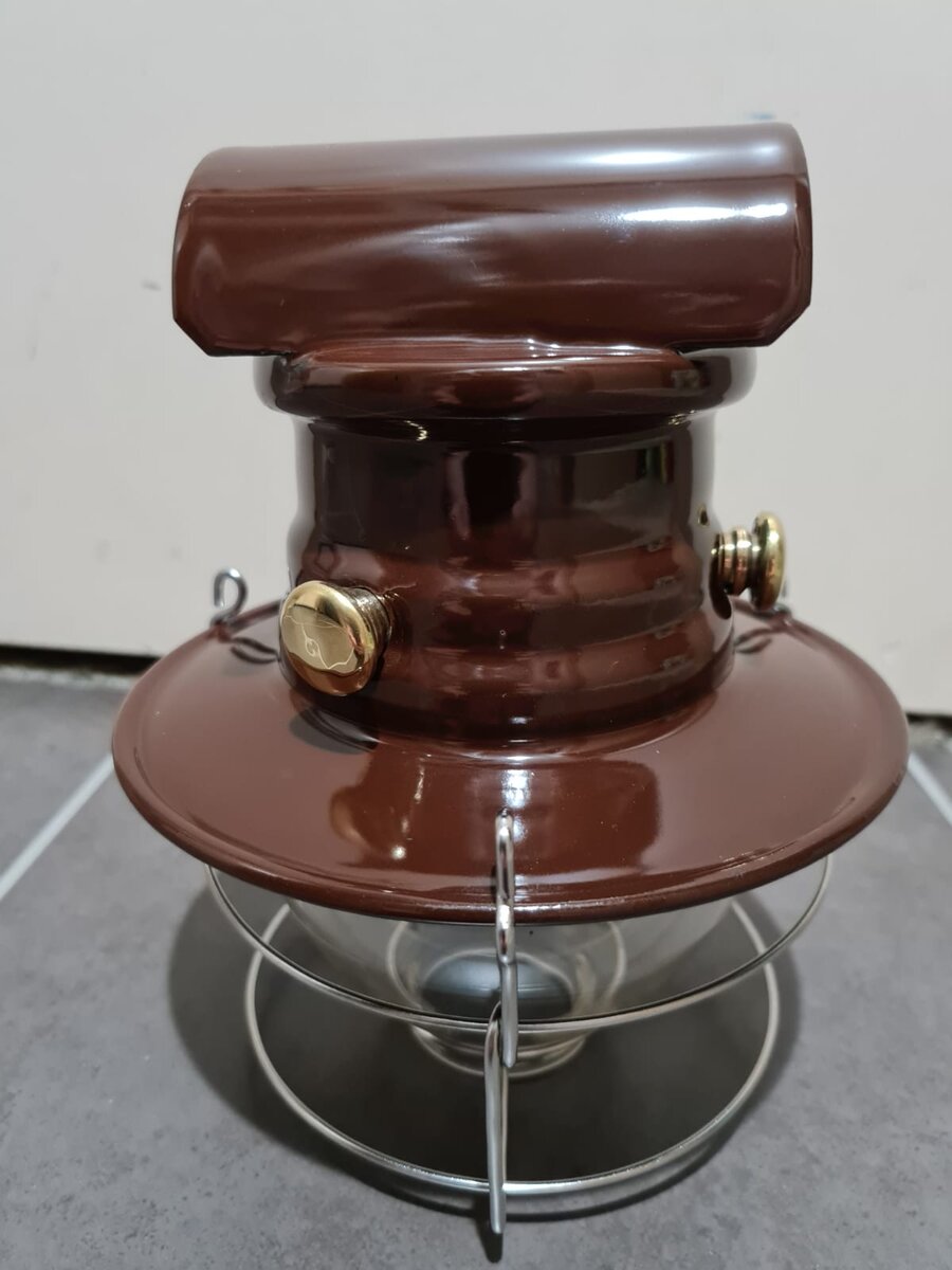

    Hi all I finally got the time to get my one and only PL53 restored, as with most of my lamps we have done a full reconstruction here is how it was sent to me from my mate in the UK.
    PL53 1940s 1.jpg PL53 1940s 9.jpg PL53 1940s 13.jpg PL53 1940s 16.jpg PL53 1940s 17.jpg

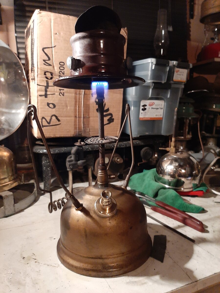

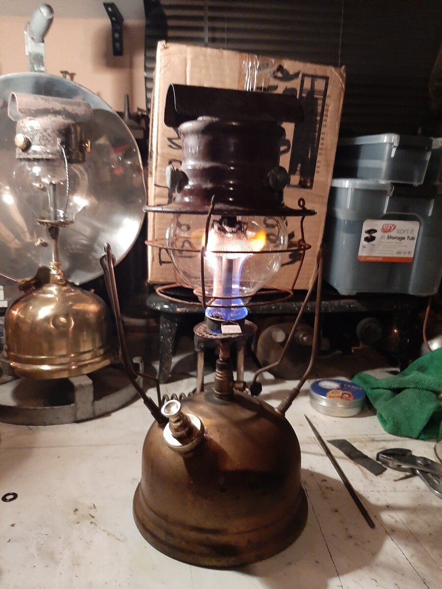

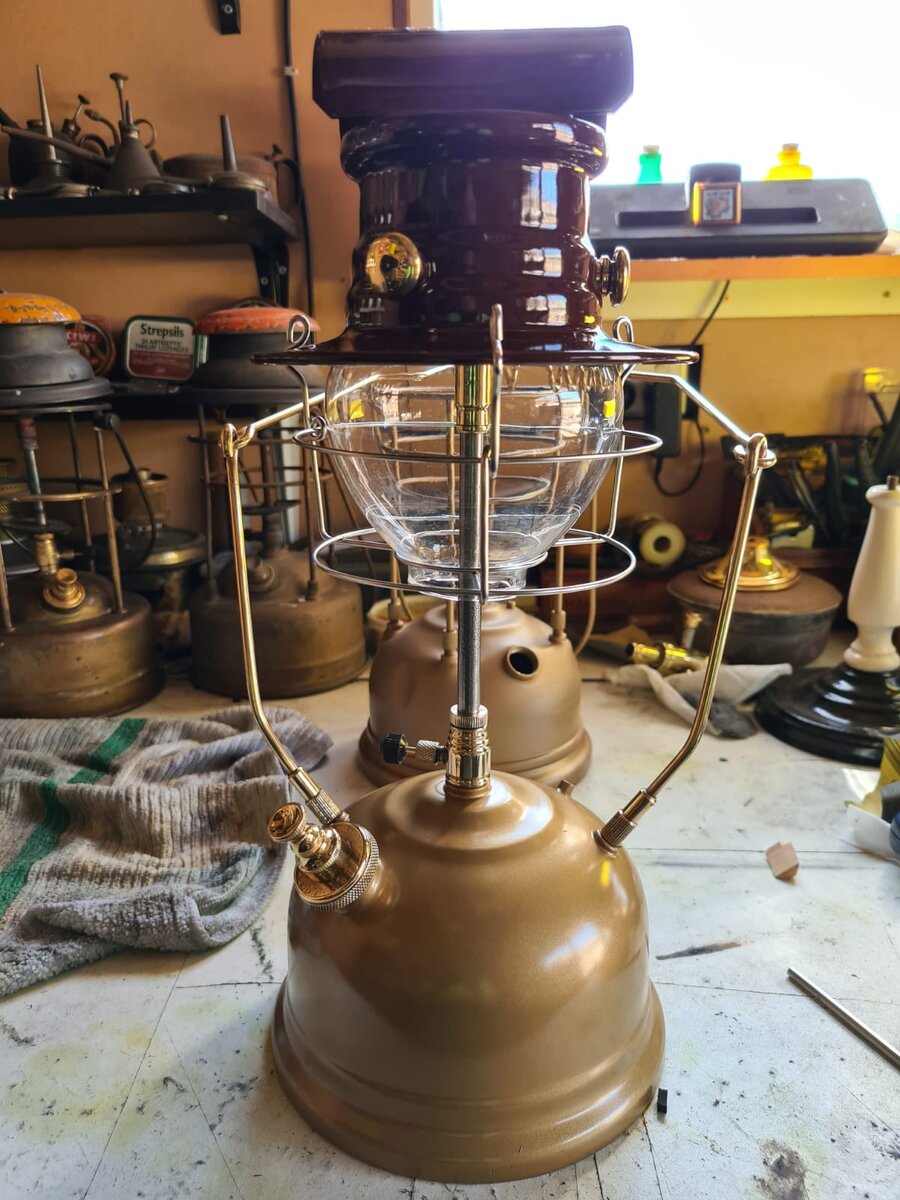

    So off we go time to get her in working order, flush out tank, put wire down flow tube, clean and blow out burner head, oil and clean control cock valve, also check and clean the vaporizer, then reseal.
    Time to put her back together and test the burner out and see what pressure we have.

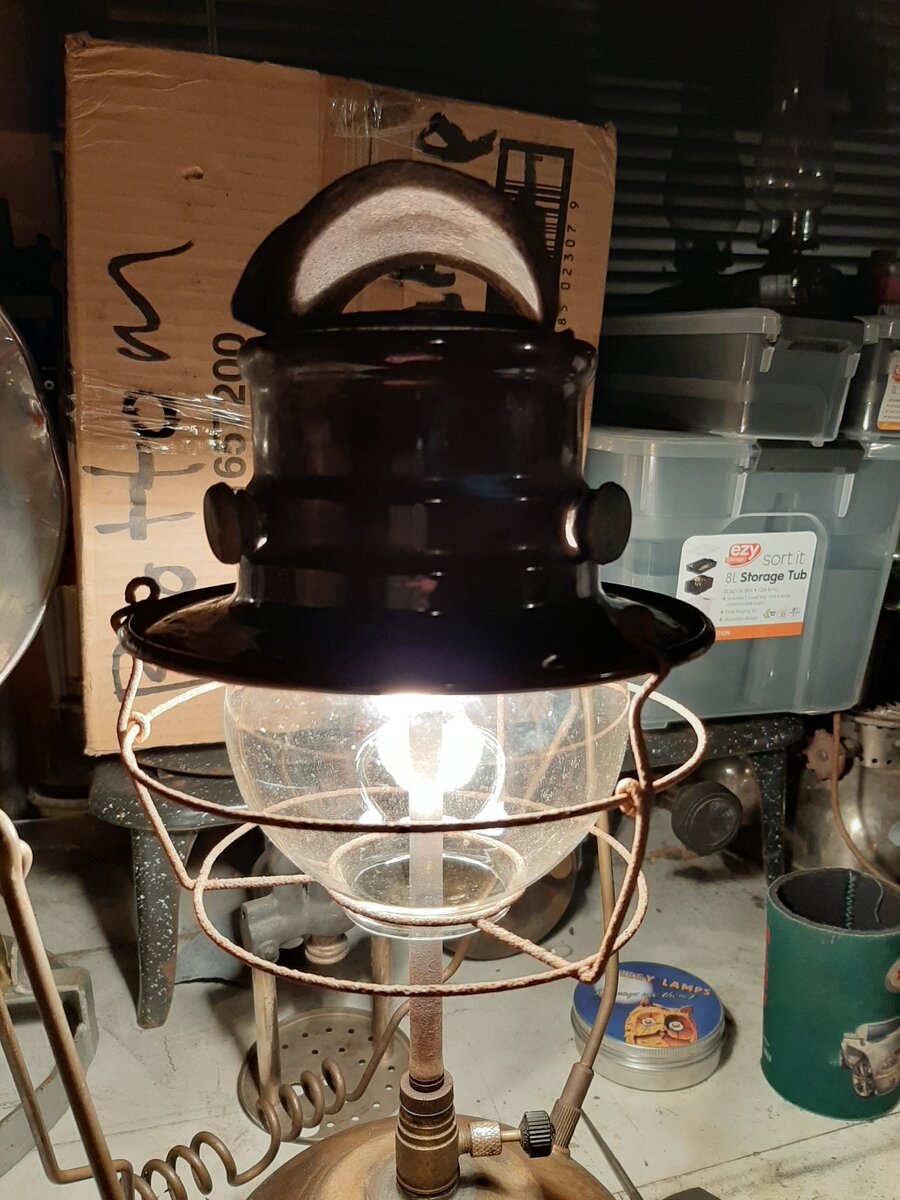

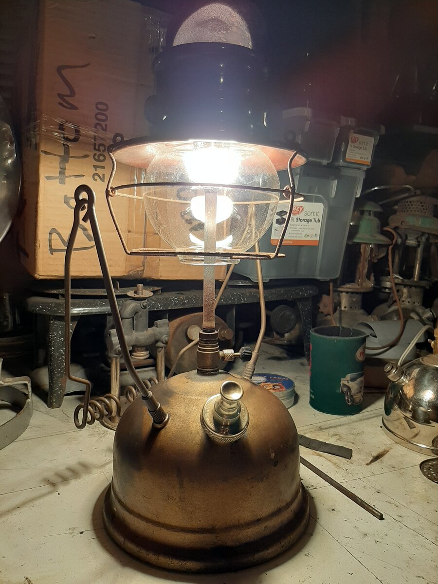

    Seems to work well, okay time for the real test pre burn and el presto off she goes, what a wonderful lamp I can't believe just on 80 years old and bang fires up straight away.
    I WONDER HOW WELL I WILL WORK AT THE AGE OF 80? not that good i'm sure.
    PL53 1940s 19.jpg PL53 1940s 20.jpg PL53 1940s 22.jpg PL53 1940s 24.jpg PL53 1940s 25.jpg PL53 1940s 26.jpg PL53 1940s 29.jpg PL53 1940s 33.jpg

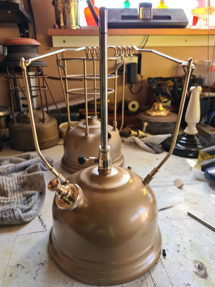

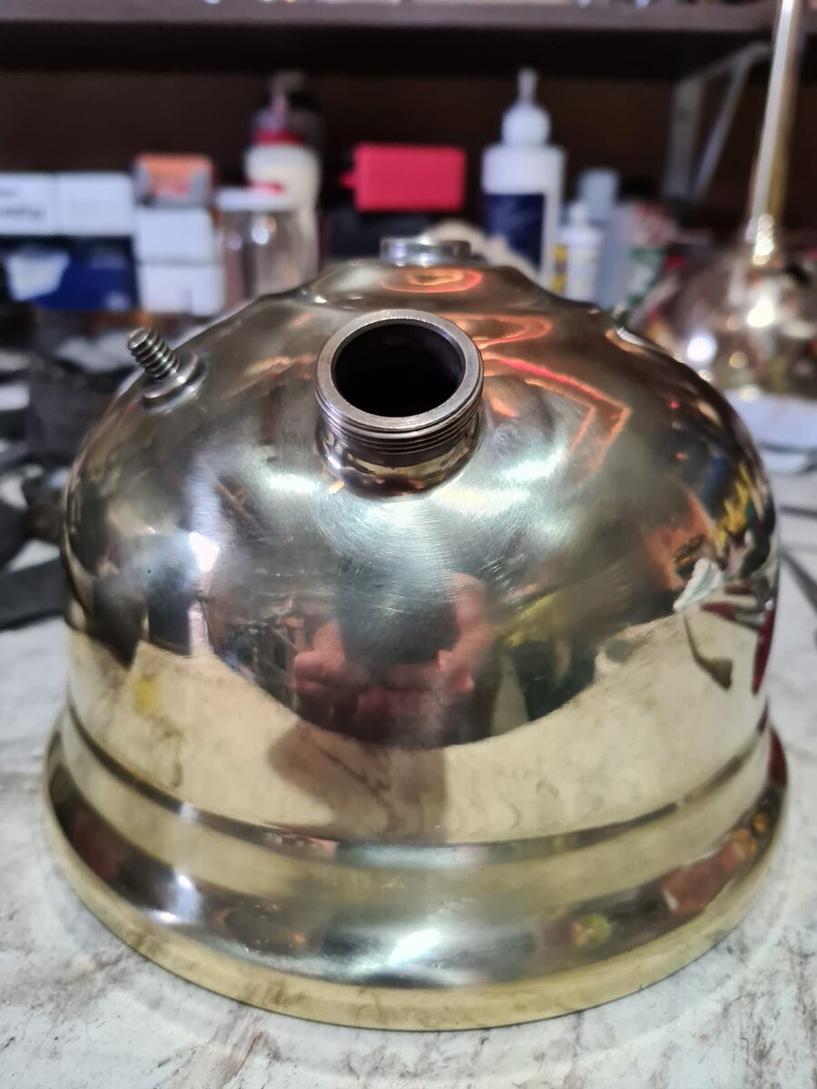

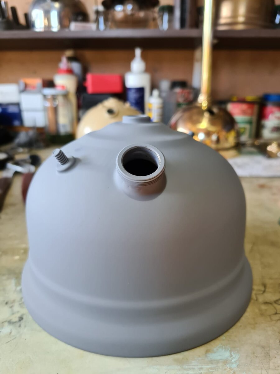

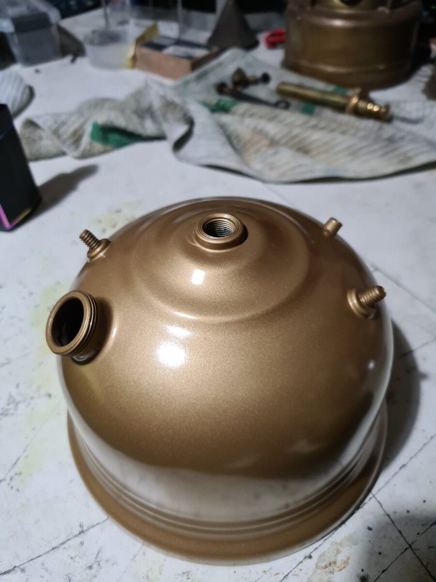

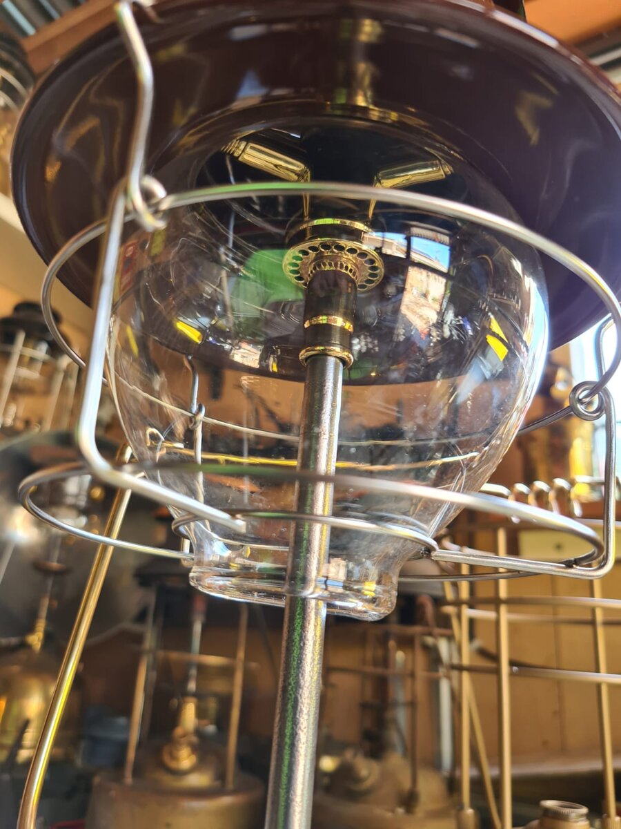

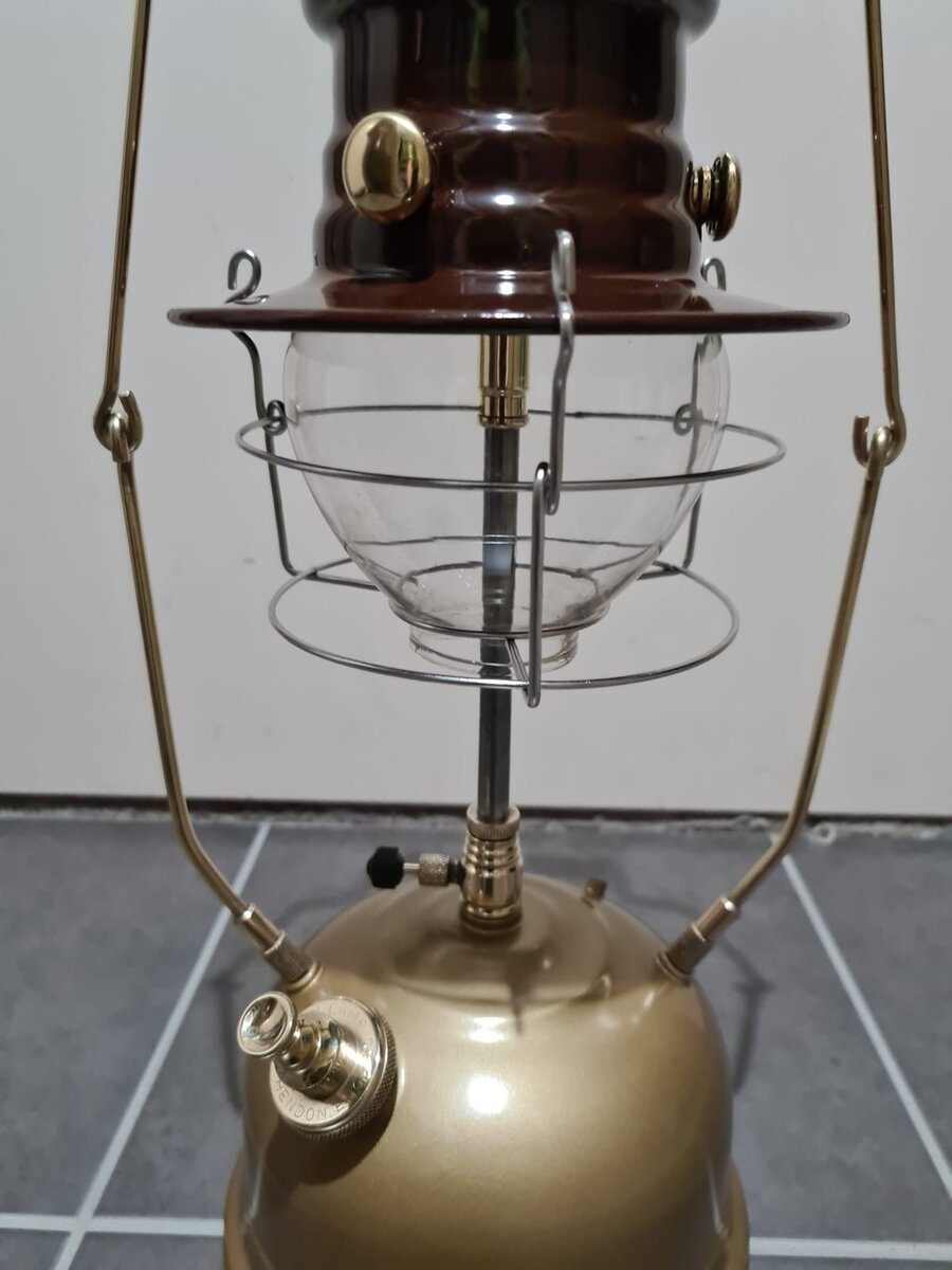

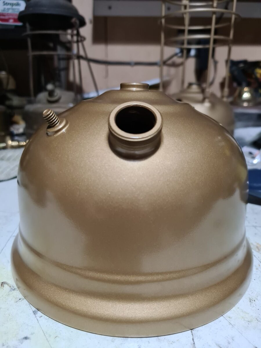

    Now it's time to lose all those collectors that dont like it when a lamp is resprayed, so warning turn away now before it's too late, because here she comes brand new with a reproduction hood and globe holder.
    I will save the old hood and globe holder and leave them in original condition.

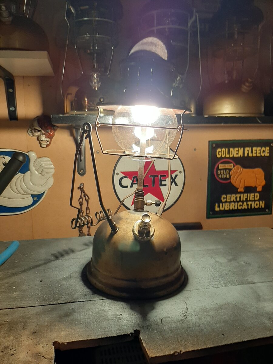

    PL53 1940s 42.jpg PL53 1940s 46.jpg PL53 1940s 47.jpg PL53 1940s 53.jpg PL53 1940s 54.jpg PL53 1940s 56.jpg PL53 1940s 59.jpg PL53 1940s 62.jpg PL53 1940s 72.jpg PL53 1940s 73.jpg PL53 1940s 75.jpg PL53 1940s 76.jpg PL53 1940s 77.jpg PL53 1940s 78.jpg PL53 1940s 80.jpg PL53 1940s 81.jpg PL53 1940s 83.jpg PL53 1940s 84.jpg PL53 1940s 86.jpg PL53 1940s 90.jpg PL53 1940s 92.jpg PL53 1940s Repoduction hood 3.jpg PL53 1940s Repoduction hood 4.jpg PL53 1940s 68.jpg
    There you go she's all done and a excellent Lamp for my collection, hopefully one of many.
