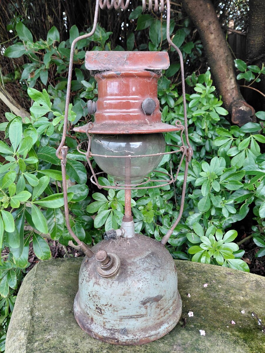

    The PL53 is both the newest, and by far the oldest in my collection, and I can't begin to explain my excitement in finding it!
    I couldn't wait to make a start on it, immediately pulling it apart for assessment - Now I have questions...?
    I have made a start trawling CPL for information and advice, but not finding specifically what I need at the moment. Is there such a thing as a PL Parts List / Exploded Diagram available?
    #1 - Simple question - Does a PL use the same Seals for rebuilding as an X246?
    #2 - Date of Manufacture - From my research and comparison with others on CPL, and because of the Steel Fount I am thinking 1940 to 1946 ish? Having said that, following dismantling for fettling, the Burner Assembly looks to my untrained eyes, to be very similar to the 1930's model illustrated on another post that I'm now struggling to find again! Could it be Tilley using up older parts, or just those pesky Scouts swapping things about again?

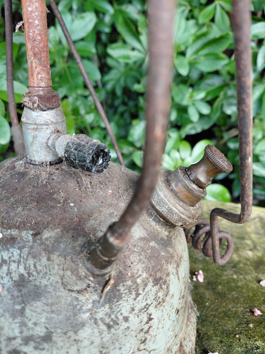

    #3 - Pressure Tit - Mine doesn't have one, is that common?
    #4 - Control Cock - Mine has a late model Aluminium X246 Cock installed. I'm afraid Iv'e not yet caught up on all the different Cock nomenclatures available over the years, but should mine have a Brass Cock like a "Pork Pie" or "Guardsman", or a similar type but with a longer spindle putting the knob further out from the centreline of the lamp, Iv'e seen pictures of both installed on PL's?

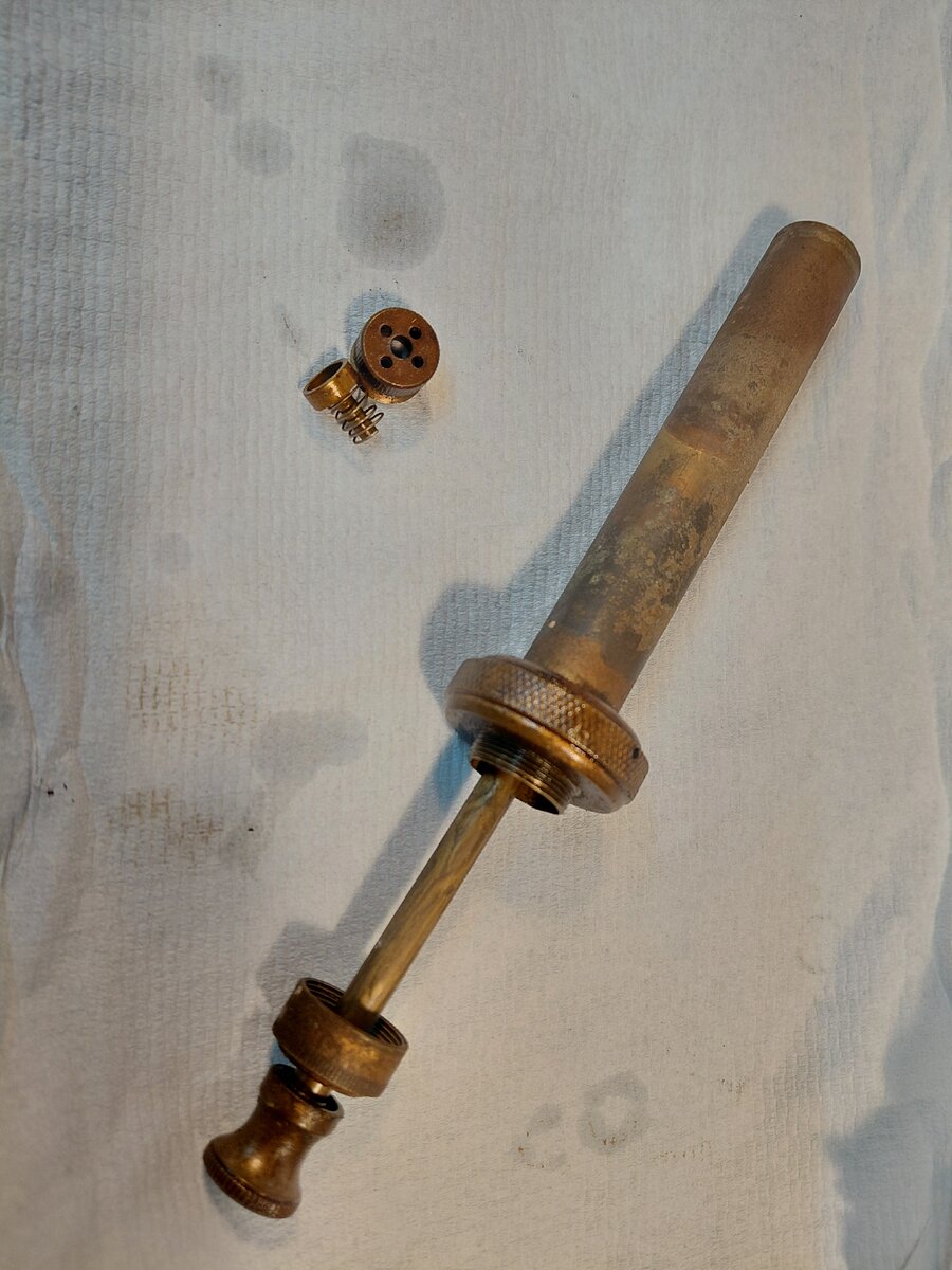

    #5 - Another simple / stupid question - Should the Pump Clamp Ring unscrew from the Pump Tube like a later Tilley, or is it one piece?

    2.its age is near what you have thought .. some steel parts appear to pre date wwll slightly ; the burner is right for yours
    3. for the steel tanks, yes as they were trying to save on brass
    4. the guardsman has a clocking ring and wil not fit as its wider ; you need one the same size as the alu one.. the heater R1 type will fit
    5. soldered in place.. use a small slotted screwdriver or dental pick or both to remove the washer

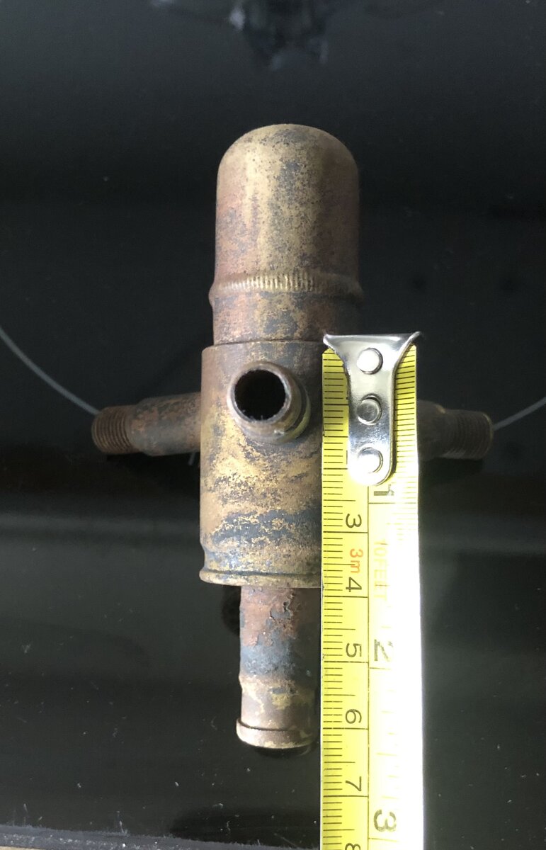

    ps the very early burner has a longer body.. yours should be similar to this poor example

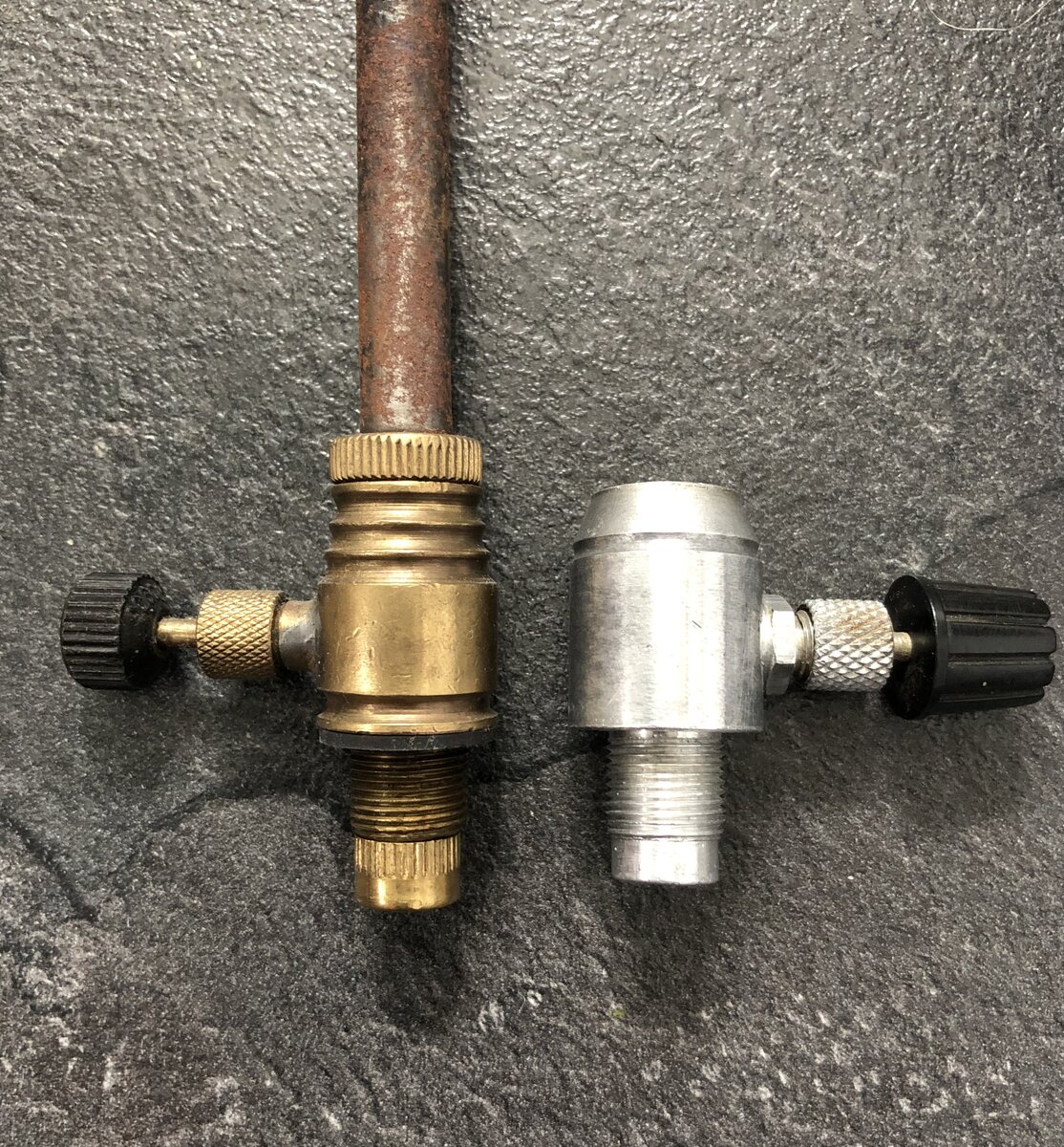

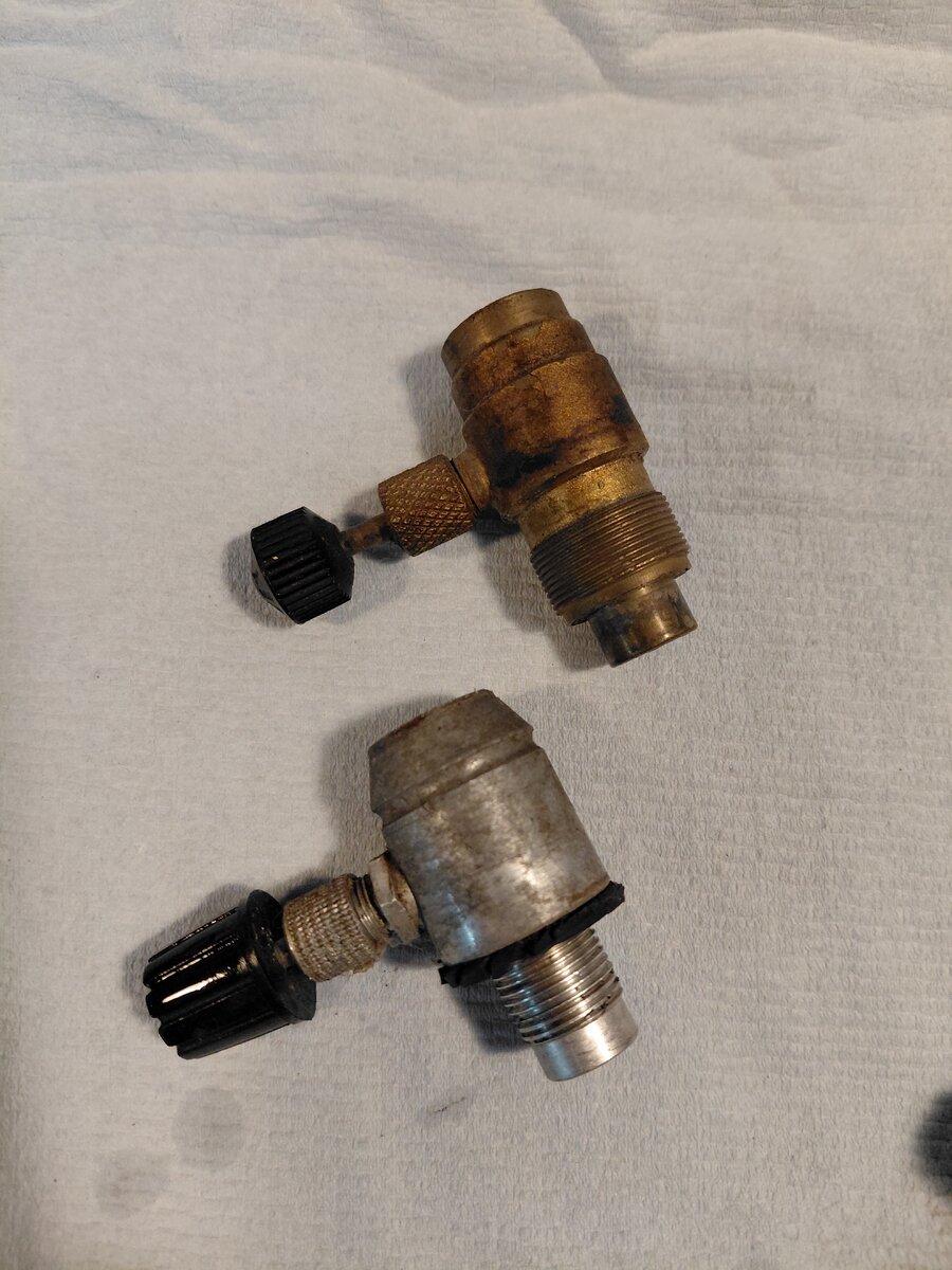

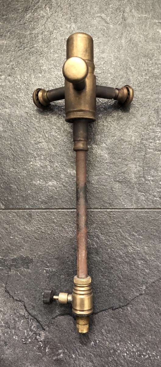

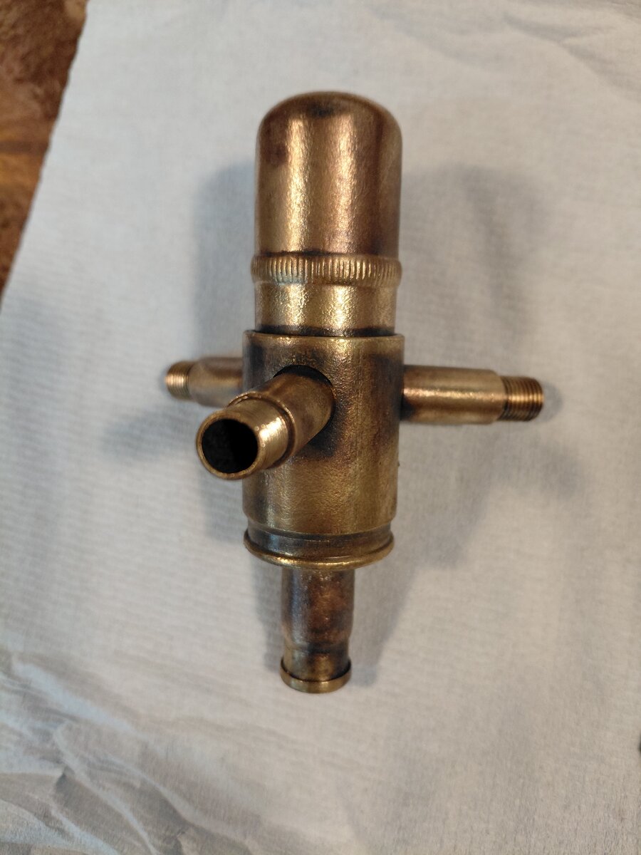

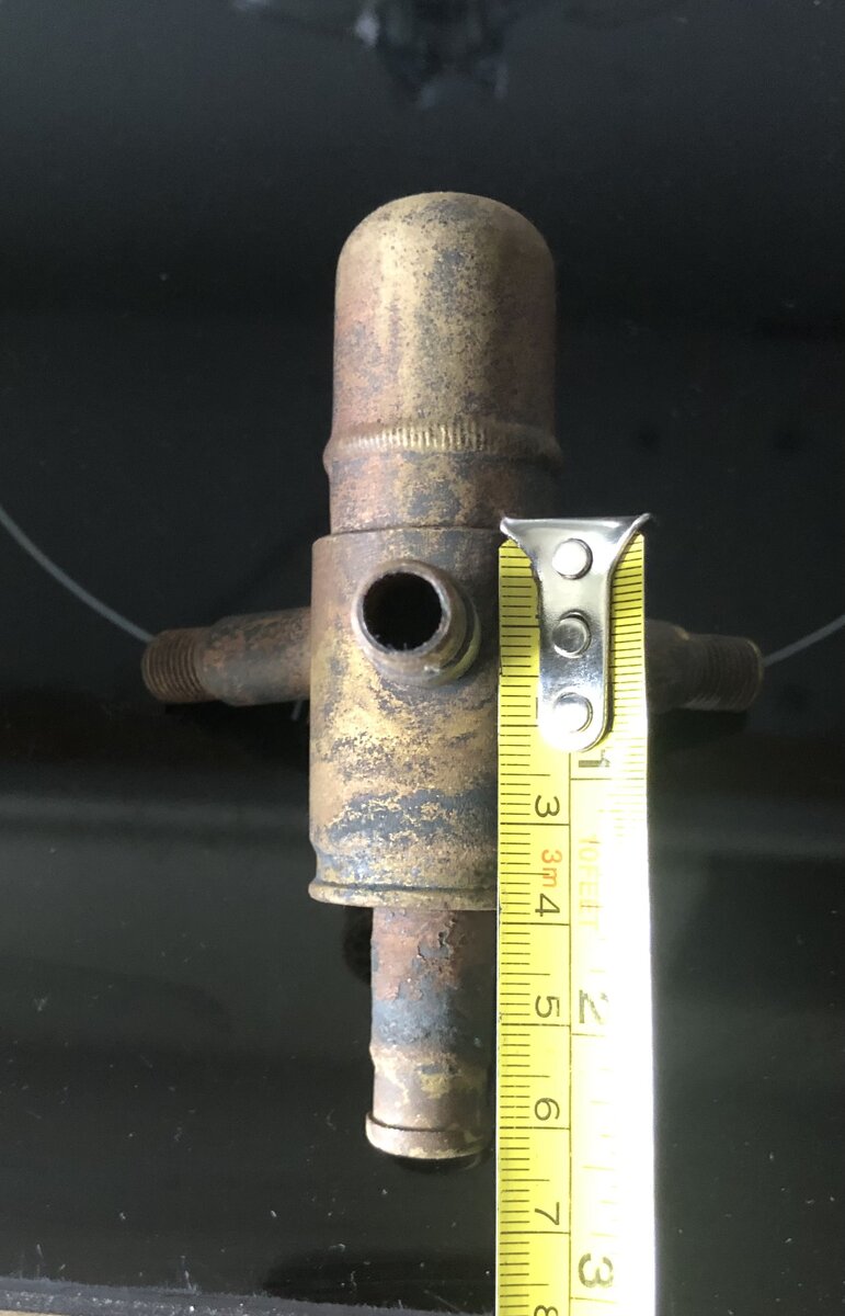

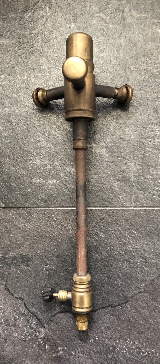

    heres a better condition burner and the other parts with an alu control tap to show the thread size
    you can use the later tap as the previous owner did? it will work ok you just won’t be able to shut it off using the knob as the pips are different but for testing purposes it will be fine :thumbup:
