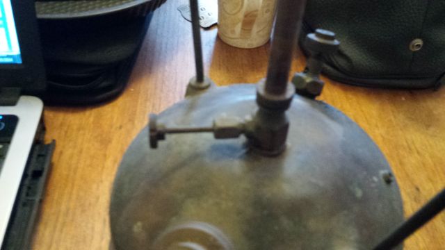

    The tank is the PL53 size and has a flat top later lamp tanks went up and down a bit around the control cock.
    The control cock has octagonal or hexagonal stem great to see , same control cock on early smooth stemed Tilley table lamp from around 1924.

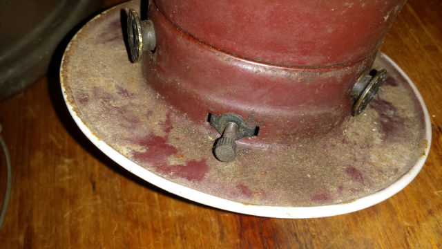

    The hood pics you have sent clearly show a small grub screw added to the hood after the enamel was fired there's three of these around the junction of the hood where vertical meets horizontal !These hold the glass in place.
    The hinged flap on top of hood , I'll say definately home made how ever the valve attached to tank is for real and only present for a few years .Feed pipe from tank goes to this ajustable valve before heading for the control cock !
    Inside hood is an insect guard above the burner assembly.
    A pic of both ends of the pump would be good !

    Yes with that valve unit in the tank it has to be older than 1929. Mick I assume that this would have just a pricker control rather than a valve under the vaporiser? I don't own a Tilley with that style of fuel feed but I have seen a couple and also seen pictures of the inside of the tank. It is certainly a rare and old beast to be preserved and cherished.

    Its got a old burner with the coarse thread spigot I have had a few where the mixing dome looks to have had a piece fixed in the top is this like that?

    Looks interesting idea does the hinge been there a long time if the cap was fixed originally where are the holes or rusty bits
    cheers pete
  15. David Shouksmith
    That looks like factory original to me.
    Perhaps it was hinged to allow access to the insect shield - is that fixed or removeable?
