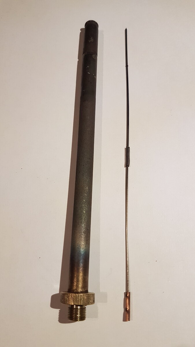

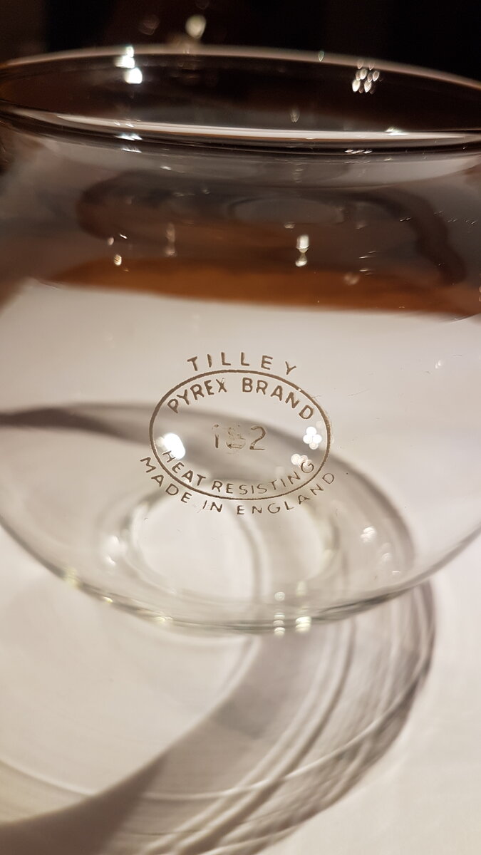

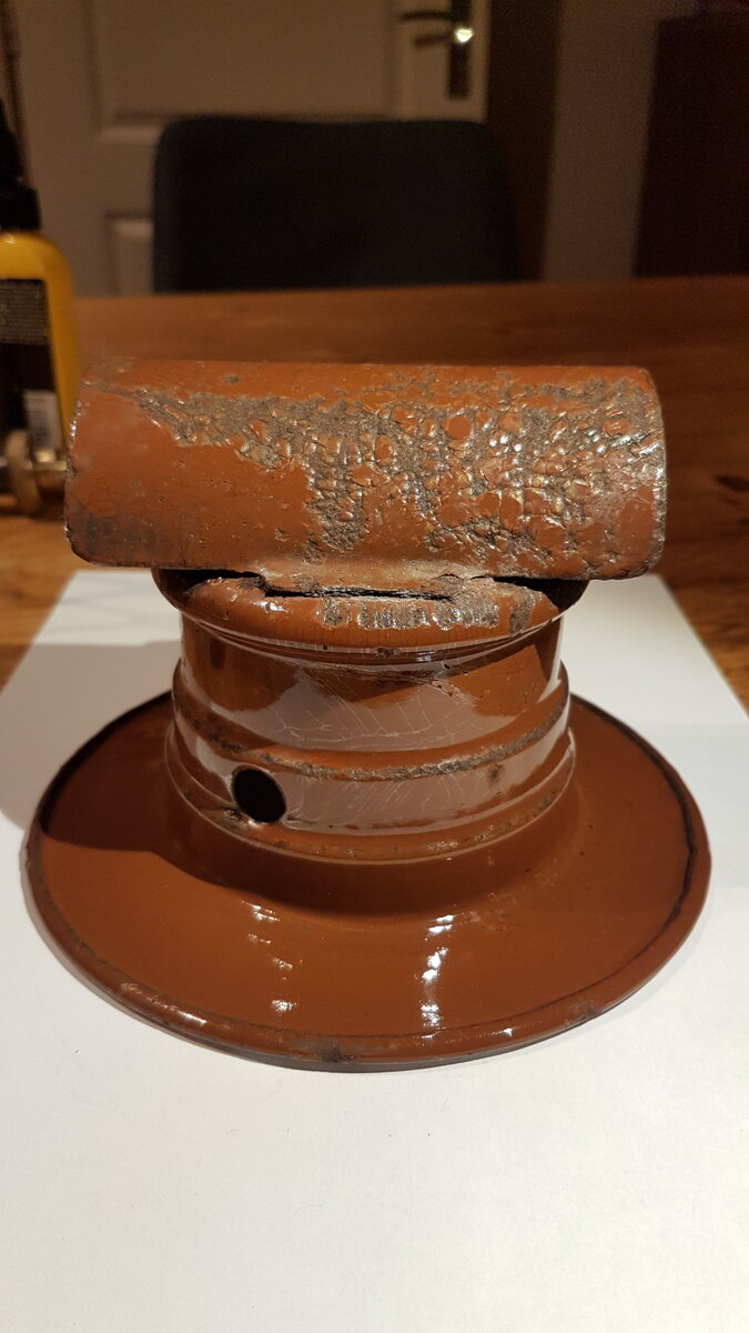

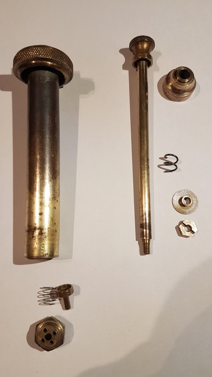

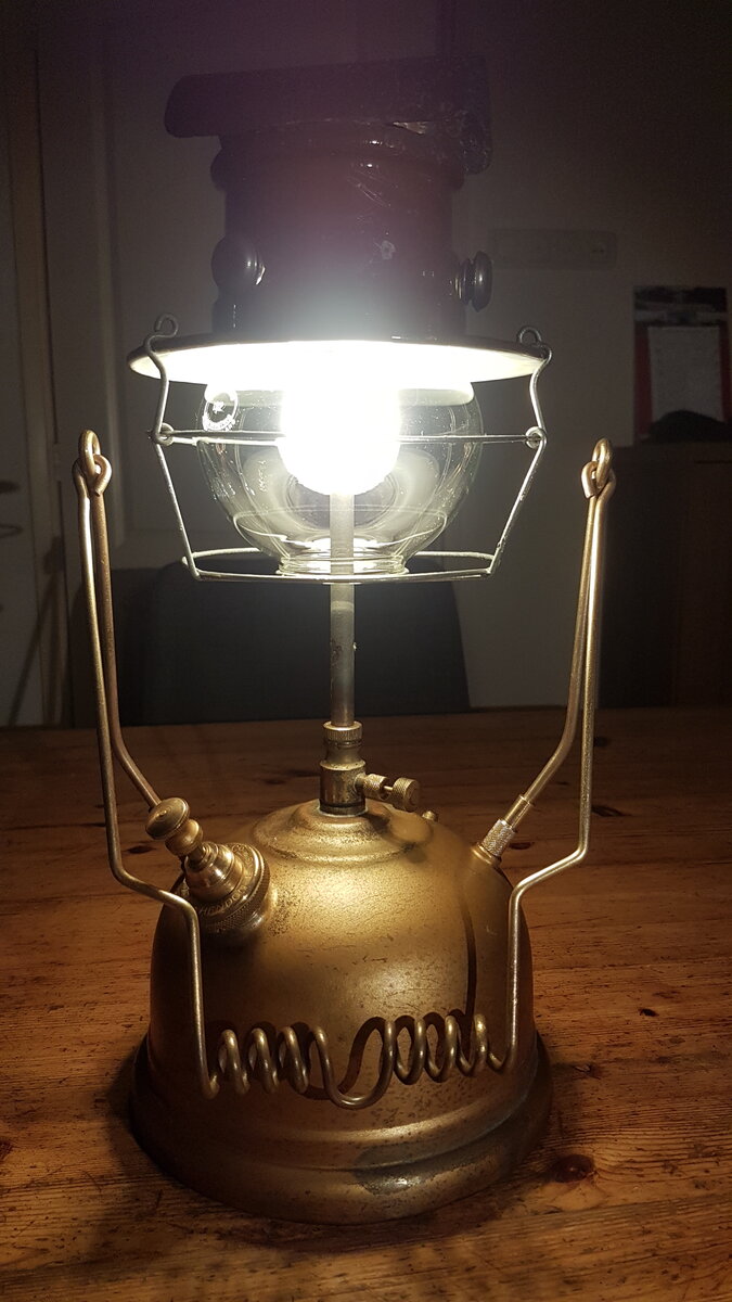

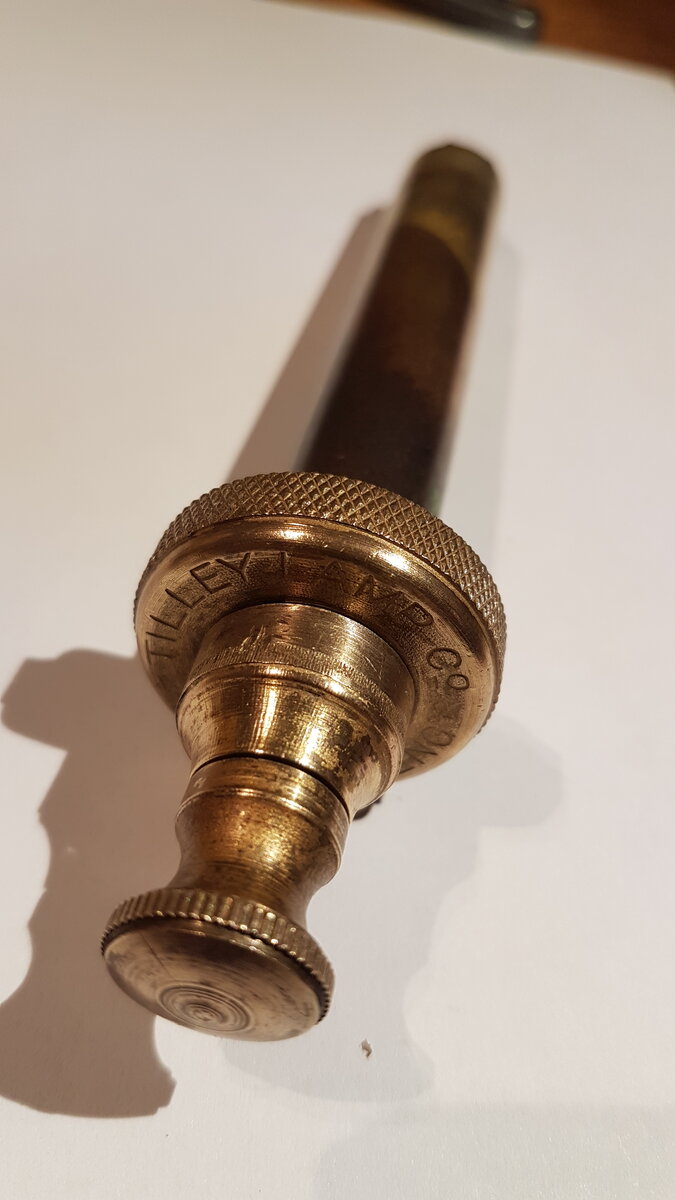

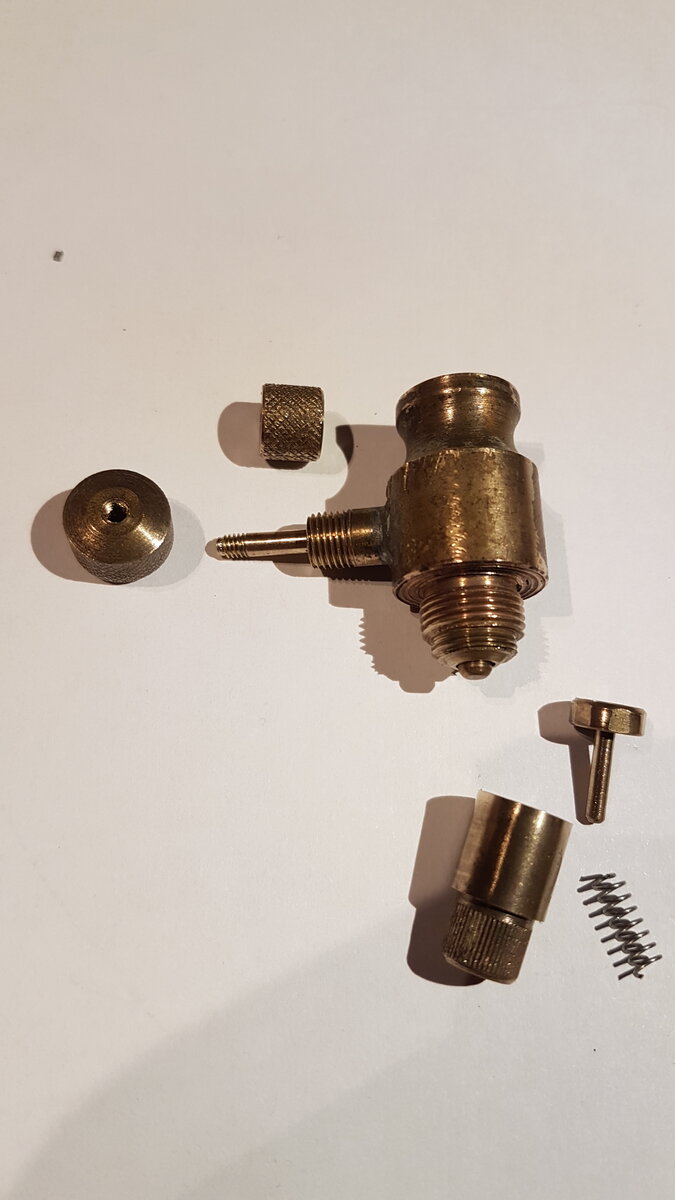

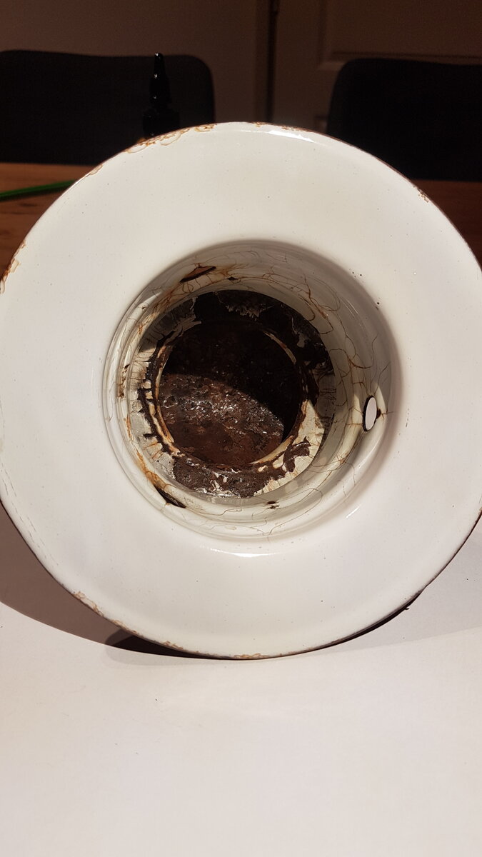

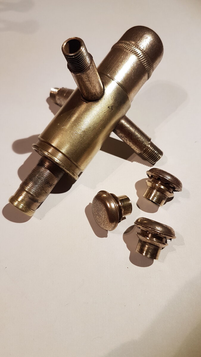

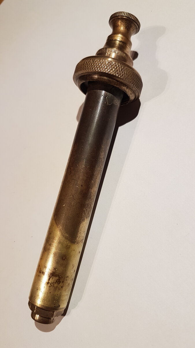

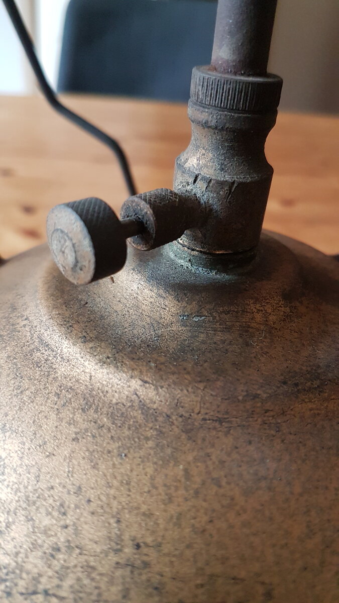

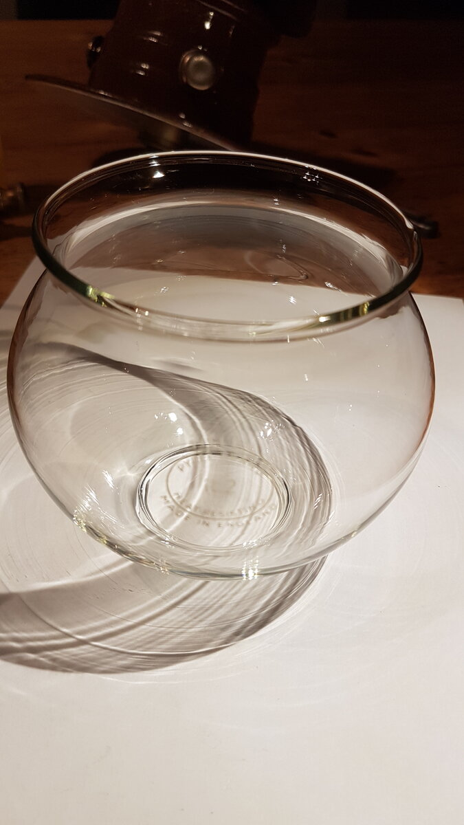

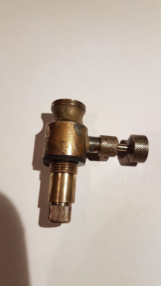

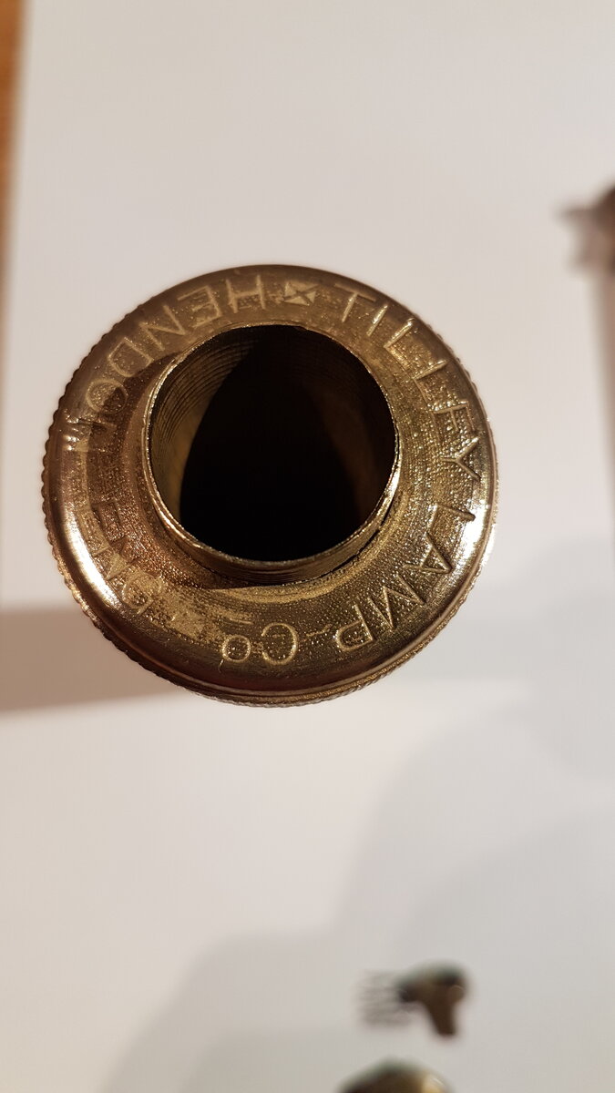

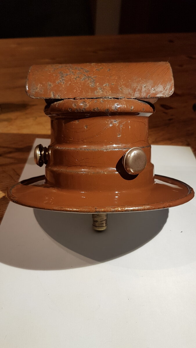

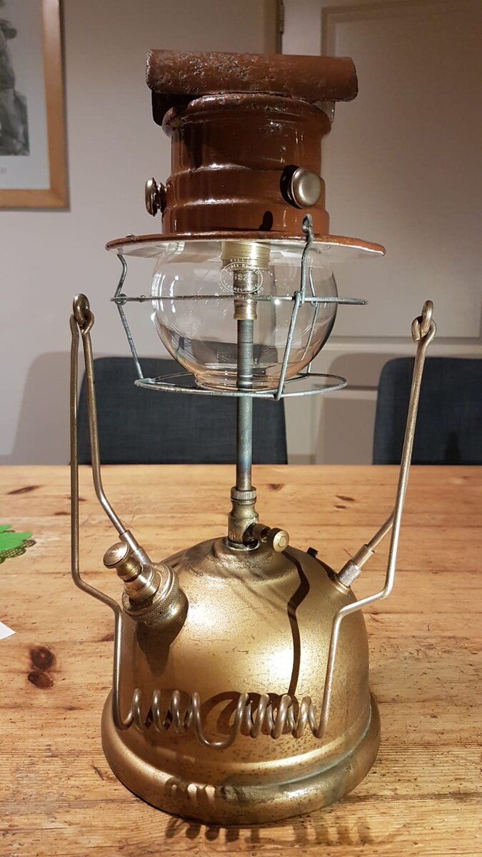

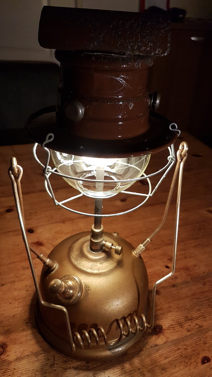

    Here a Tilley PL53, found on an auction site. The lamp was in good condition for its age. Just clean and replace the seals. The vaporiser looked good and was hopefully still usable. Once ready for use, a new mantle fitted and ready to test with good results
    IMG-20201003-WA0006.jpg IMG-20201003-WA0007.jpg 20201003_115433.jpg 20201004_195302.jpg 20201004_195320.jpg 20201004_195420(0).jpg 20201004_200102.jpg 20201004_200109.jpg 20201004_200257.jpg 20201004_200807.jpg 20201004_200840.jpg 20201004_200918.jpg 20201004_202353.jpg 20201004_202404.jpg 20201004_203523.jpg 20201004_203533.jpg 20201004_203543.jpg 20201004_203706.jpg 20201004_204139.jpg 20201004_204147.jpg IMG-20201004-WA0009.jpg IMG-20201006-WA0015.jpg IMG-20201006-WA0016.jpg IMG-20201006-WA0013.jpg IMG-20201006-WA0014.jpg 20201006_194150.jpg 20201006_194214.jpg 20201006_194336.jpg
    16,914
    That is a very lucky find, it's a WW2., PL-53, but it takes an XN., control cock and it has that very old style of burner and it has a brass knob on the control cock.

    What an old beauty! Great find well fettled.

    Well done and well fettled.
    I just love these PL53s. They look good and work well.

    Congratulations Johan, it's cleaned up nicely :thumbup:

    Absolutely love the PL53, you have done a marvellous job there mate, something to be very proud of, well done love the money shots.

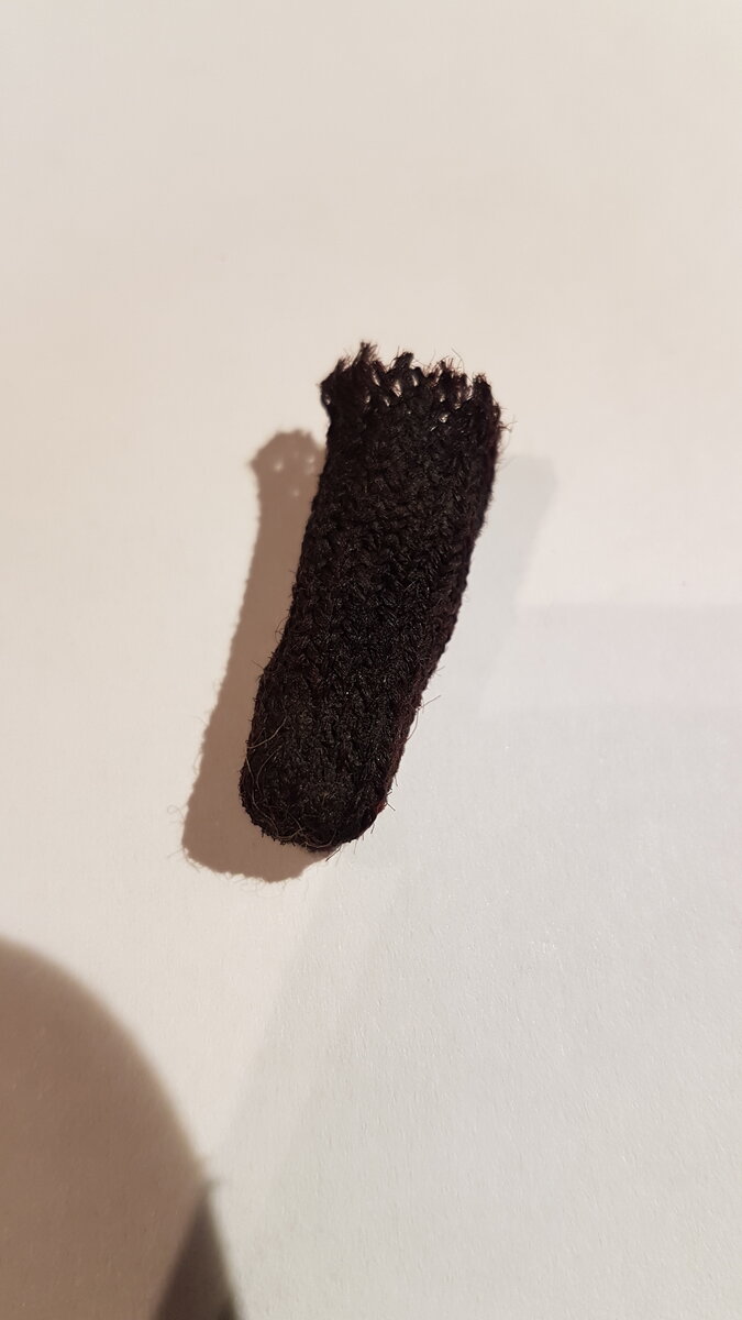

    A lovely looking lamp, but what is this bit please 4655F5E1-60BB-423E-A075-1754EC2726C8.jpeg
  11. podbros
    4,117
    Hi @Darren Holt .. It's the 'sock' filter for those older control taps ... It slipped onto the end of the tap on the left in the small thumbnail pic..
    The recess in the fount had to be deeper to accommodate this type of tap...
    Hope that helps...
