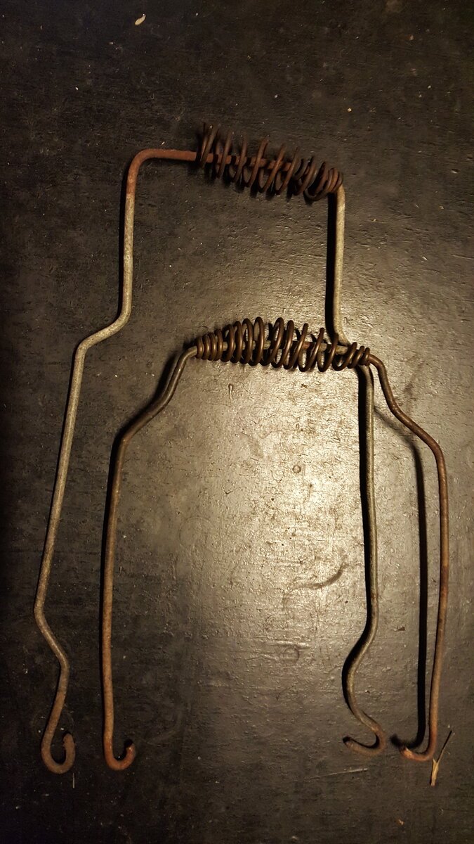

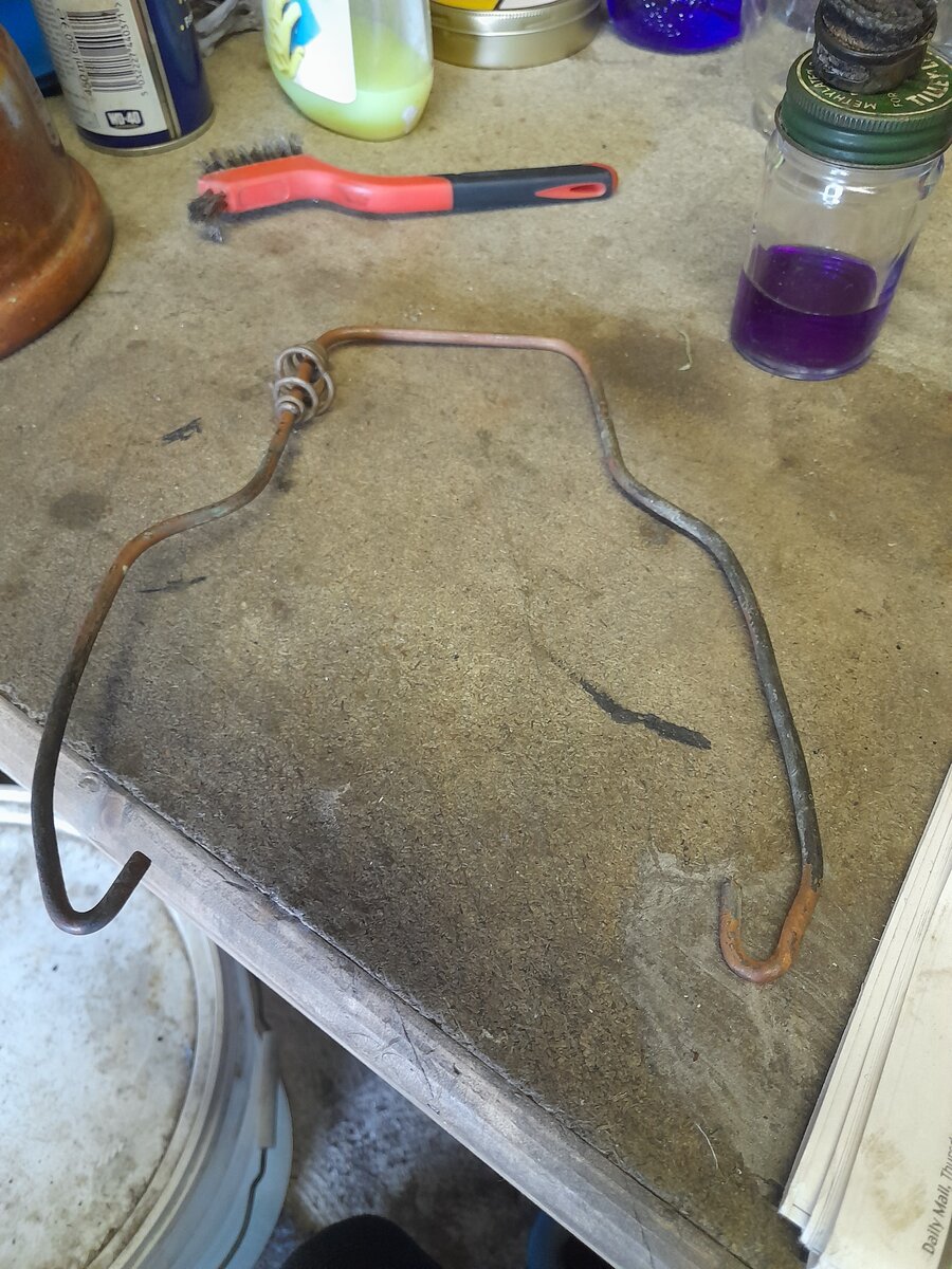

    Great tips thanks I've used plumbers tape it works well, I've got the handle left to do ,can't figure out which way to bend it back into shape looks like its from a later lamp any ideas thanks.

  8. James K
    Nov 10, 2017
    656
    A lovely example of an early 1930's PL53.
    To me it looks all original apart from the glass, I would suggest a reproduction pre war globe from base camp until you can find an original. The one currently fitted does not fit the hole in the cage very well.
    Great work on the fettle it's coming along nicely.
    James

    Nov 10, 2017
    656
    Well done for finding and fettling such a nice original lamp with all the right bits, it looks great in the pictures you have posted of it running.
    Re the handle that you changed over for the final build, your original was unsightly but if it was not original it was not the only one like it, a quick rummage in the shed turned up two that were equally horrible. I didn't use mine either but they can't all be wrong.
    James
  10. col
    col United Kingdom Subscriber
    Mar 23, 2019
    55
    carlisle cumbria
    Hi James thanks for sending the photos they look like the originals for my lamp is it 5mm thick brass? If it is I think your right and I will try to reshape mine many thanks.
  11. James K
    Nov 10, 2017
    656
    The handles I have are 5mm steel
