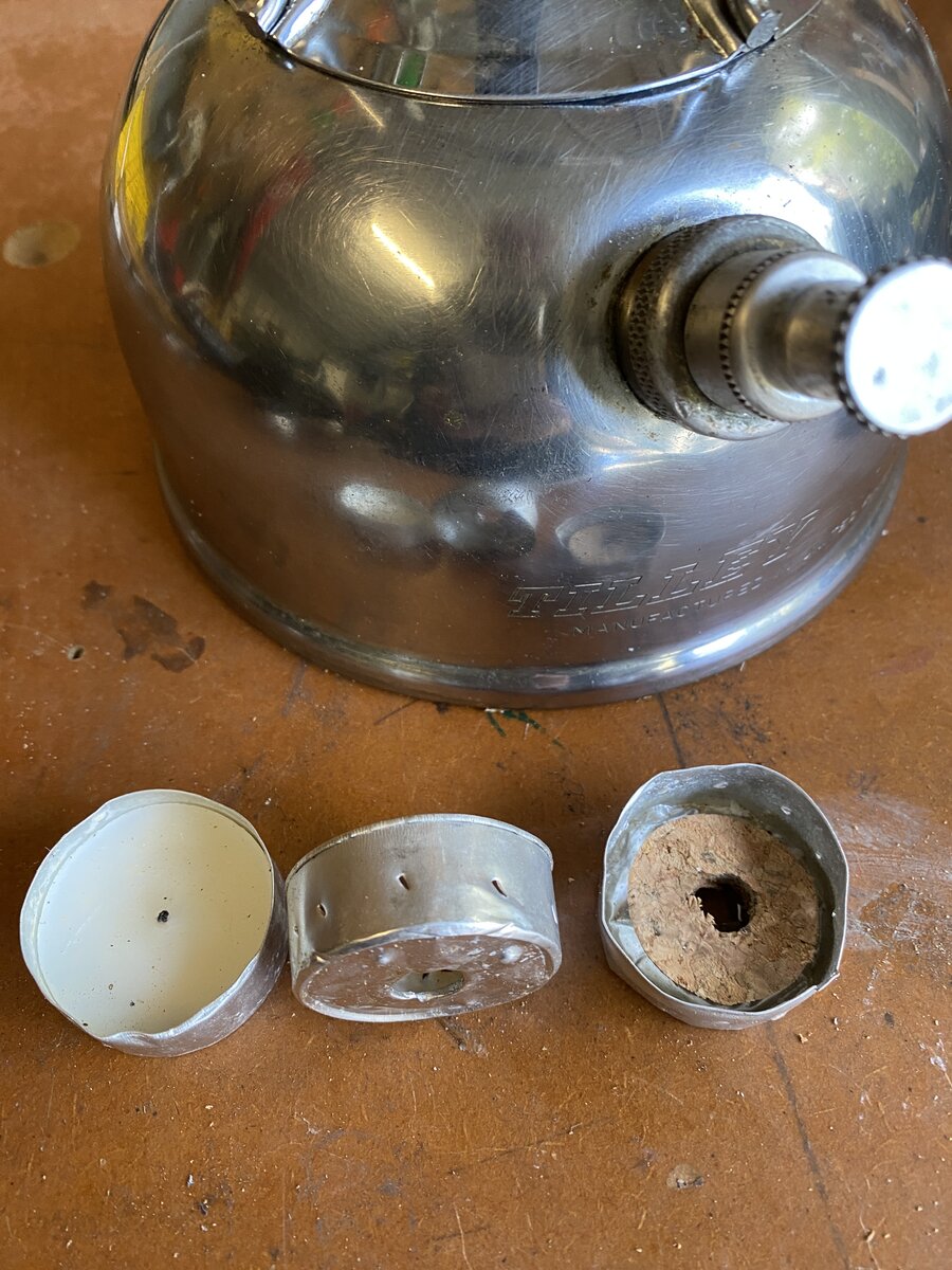

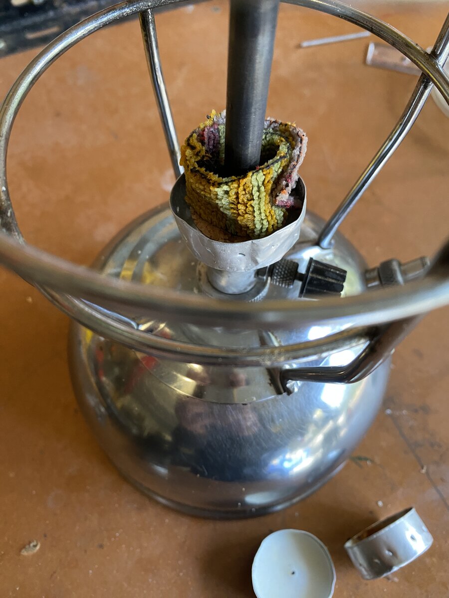

    I lost my Tilley pre-heater years ago.
    A simple alternative is to use a an old tea cup candle. Empty the wax, then make a hole in the middle to Slide Over the vaporiser tube. Hold it secure with a slice of cork, also with a hole in it.
    It stays in place, no need to ever remove unless it gets damaged.
    Cut a strip of thick cloth, about the same length as your longest finger.
    Dunk in Metho, then drop into tea cup and light.
    It should burn for around 2 minutes, enough time to heat the upper parts and light of the mantle.
