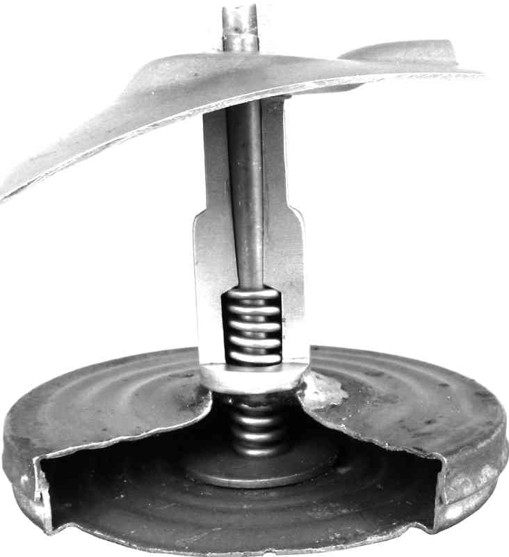

    The pressure indicator's tube is soldered to the pressure plate/bellows and sometimes the solder joint cracks and that causes leakage.
    This link shows a Tilley cutaway lantern and the bellows is shown clearly.
    Tilley X246 Cutaway (early 1950s)
  11. Mackburner
    OK here's a pic of the beast showing how it is made. Image by Dr T. Marsh.
    Hollow inside so when it is compressed it has to shove some air out. Normally you would not see this but if there is any moisture in the tube then you may see bubbles showing. That is quite normal. The diaphragm is copper and pretty flexible but might crack. However if it is cracked then the gauge won't work and push the rod up but it will leak air and drop the pressure in the tank.
    If you do ever play about trying to solder it closed then be careful. Warm things up too much and the whole thing will drop into the tank. This of course solves any leakage problem from the gauge but perhaps os not the desired result. ::Neil::
