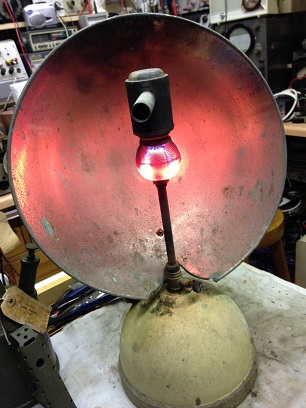

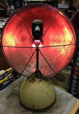

    The plating on my reflector seems pretty fragile. After gently washing with warm soapy water and a sponge, the copper was starting to show through where the plating has pitted. So I desisted!
    As the before-and-after-cleaning photographs show, the heater is not in good cosmetic condition but it certainly works well.

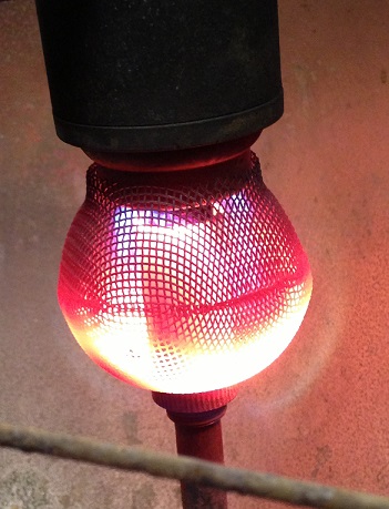

    Can I ask a question about the slight flaring outside the gauze? The flames look nice and blue and steady but I'm wondering if the vapouriser jet might be slightly worn. This is the first R1 I've worked on, so I'm not sure what normal combustion looks like!
    Thanks for any advice.
    Phil
  6. Mackburner
    Yes you might get a little halo outside the mantle. Maybe the vaporiser is a tad worn but in a heater this is less of a problem than in a lamp. Since you are only interested in heat output an over fueled burn is not important and so long as it runs then it is OK. ::Neil::

  8. JEFF JOHNSON
    16,883
    Hello Phil, the halo usually disappears once the heater has been on for a while, Jeff.
