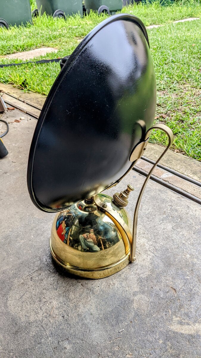

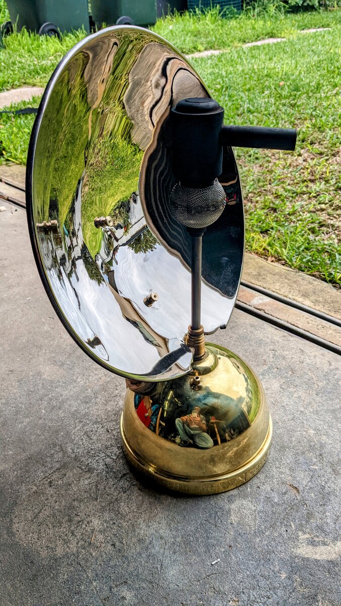

    Thanks guys for the valuable advice. I've ordered a vaporiser directly from Tilley for the first one. I've spent so much on the fettle that I've come too far to abandon it now. Spent ~$200 getting the reflector replated. Here's a couple of Wip photos
  6. ColinG United Kingdom
    4,816
    It's looking very handsome indeed. Even if you've spent quite a bit on the fettle, you'll have a stunning heater when it's finished.

    @MozzoSA
    A very nice job you've made too, i would be too afraid to use it!

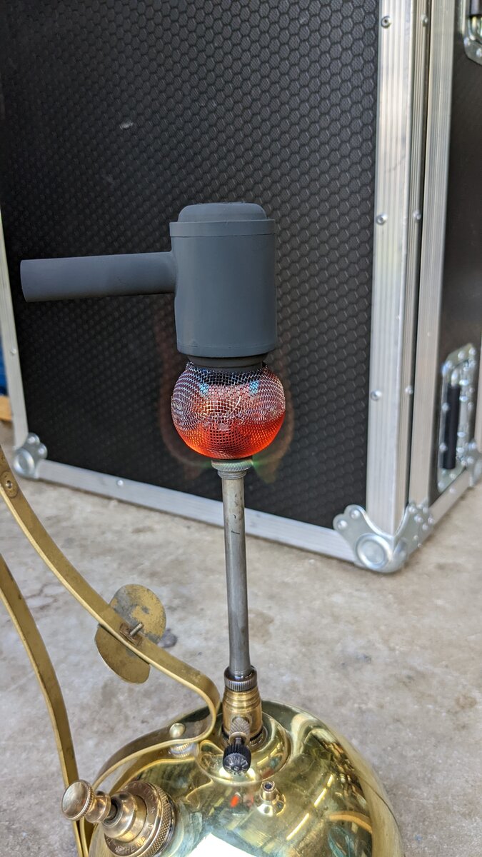

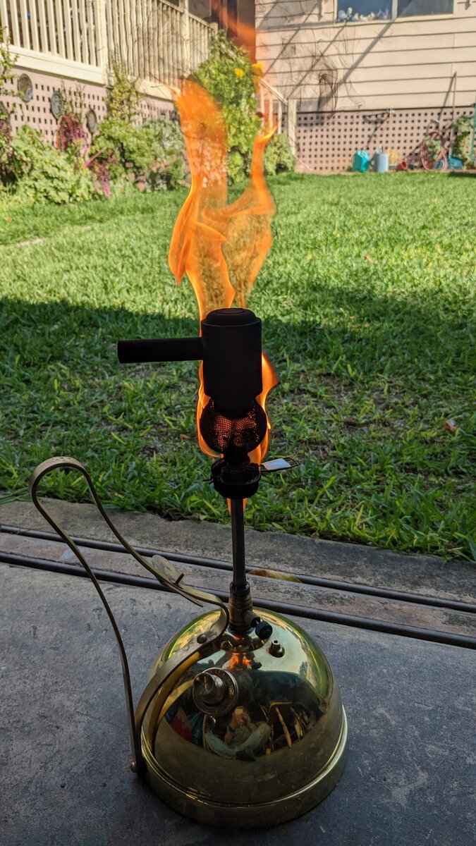

    Well I ordered a new vaporiser directly from Tilley. Quality not great but it does work. I'm surprised how darn long it takes to heat these R12 up. I took the reflector off for the big test. Don't want to spoil it.

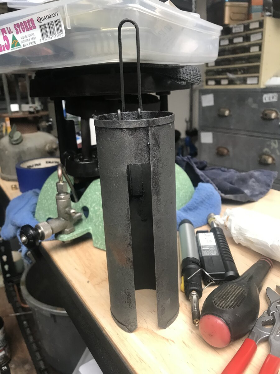

    Priming outside will always be a struggle, especially if you haven’t got a windscreen/heat concentrator.
    If you want to make one I could measure it up for you. I usually don’t use the windscreen indoors except when it’s really cold.

    Is that one made from a piece of galv downpipe, or manually rolled from sheet?
    I recon I can make one myself if needs be.
  12. Tony Press
    11,105
    It’s made from steel sheet - a Tilley original.
  13. Tony Press
    11,105
    PS. Some folk make them from a can like a paint spray can.
