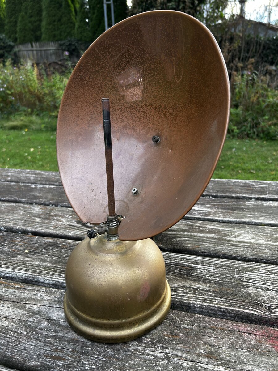

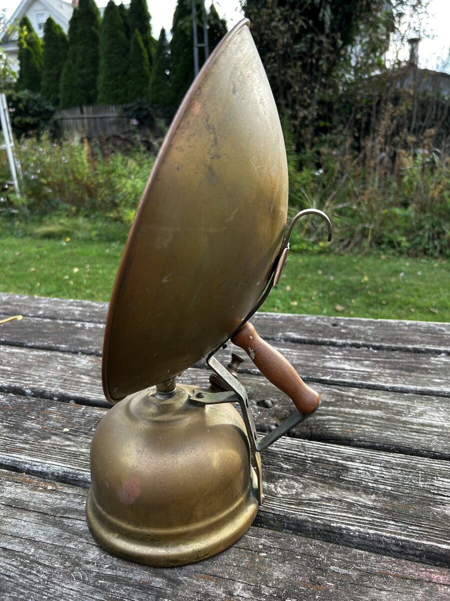

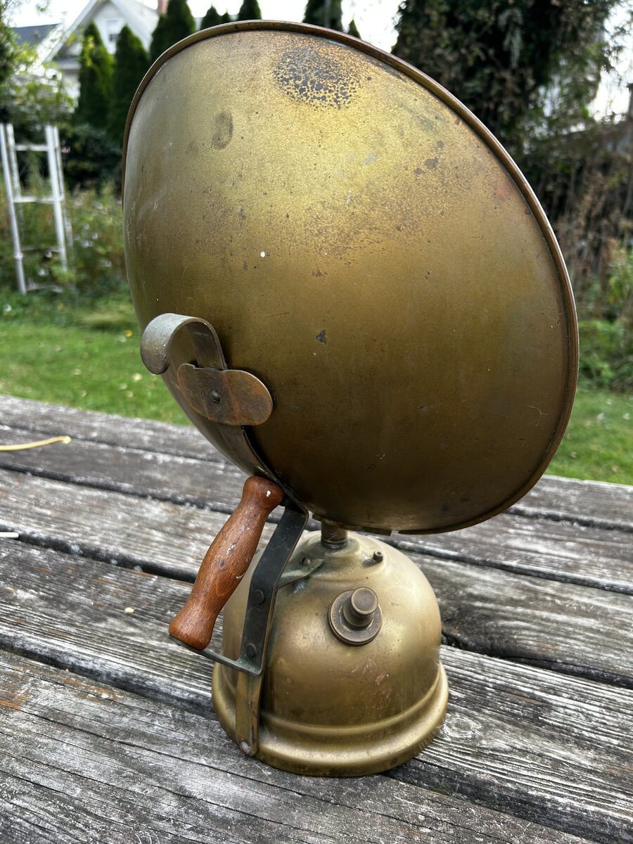

    IMG_6495.jpeg IMG_6494.jpeg IMG_6493.jpeg Found Sunday at a Connecticut barn sale. So is this a 1930s R1?
    I’ve never found an all brass one and this one is in great condition except for the missing burner head. Any info would be appreciated. Thx
  2. Buggerlugs
    Hi mate, with that control cock and reflector, looks like post 1945- 54ish, in my opinion.
  3. PaulH
    PaulH Australia Subscriber
    Jan 6, 2023
    19
    Australia

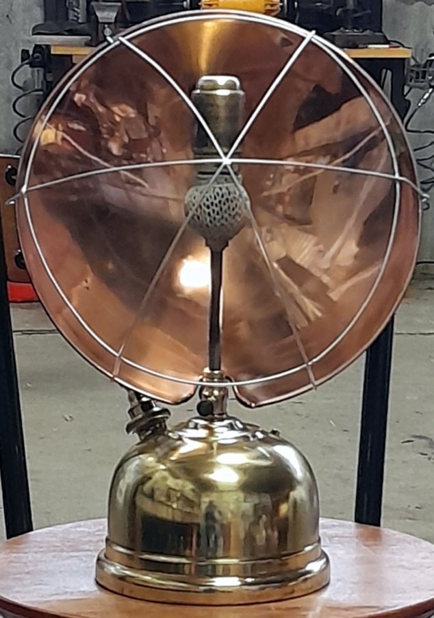

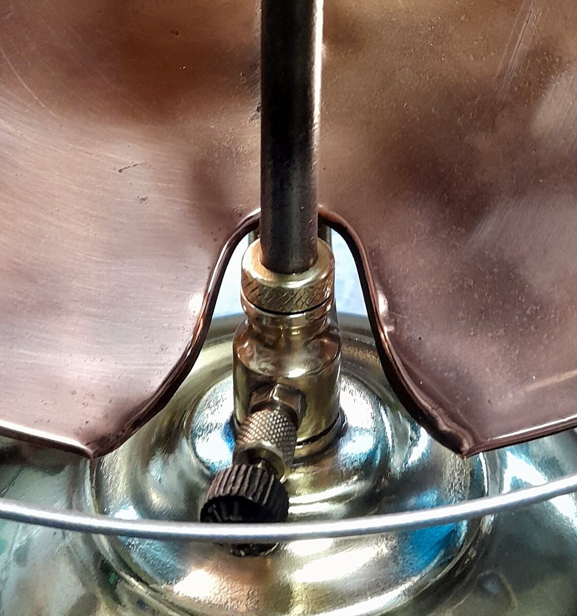

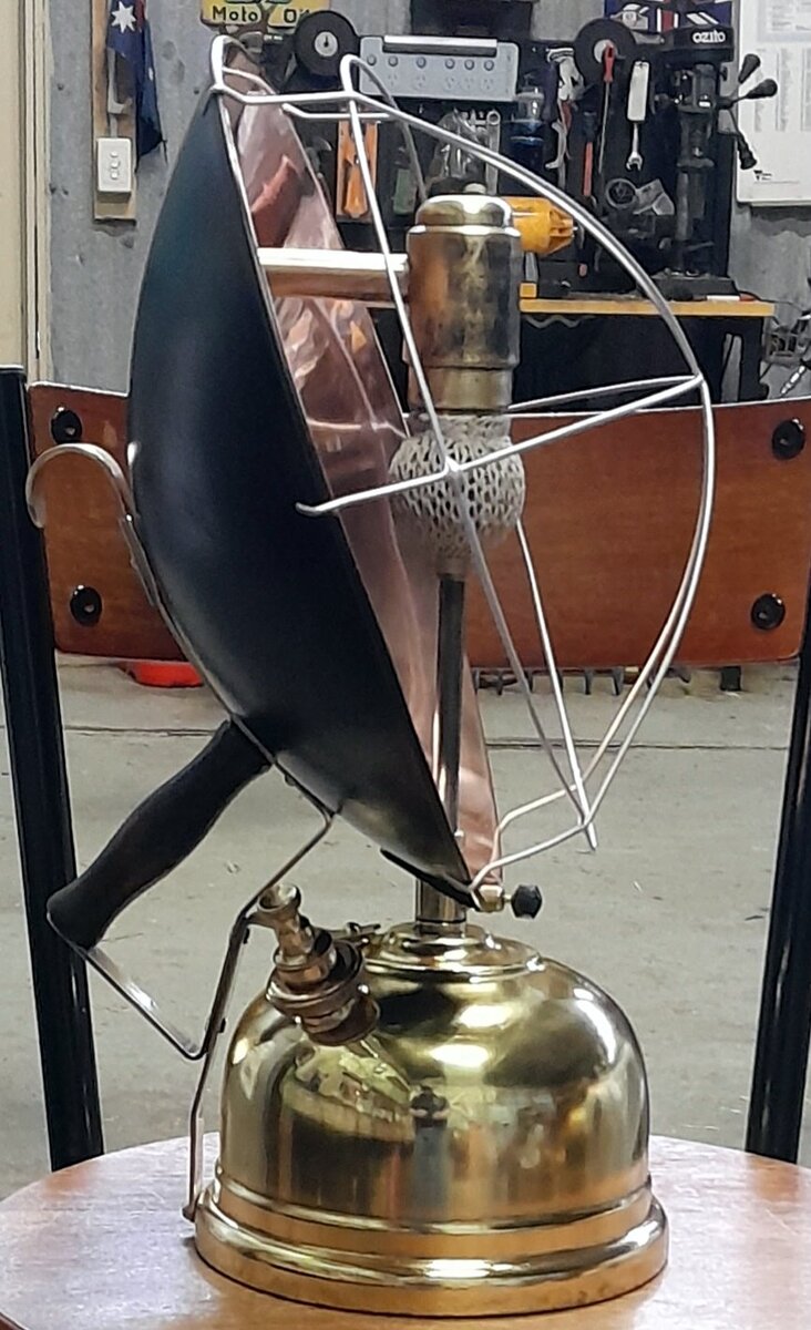

    Hi, I agree the control cock is from 1940 onward, I have a 1930's R1, I will post some photos, although the burner and vapouriser are post WW2, almost certainly serviced and updated to keep it going between 1946 and 1950 approx. Great find and work great I've used mine most of this winter, but with a wire mantle.

    They are very efficient heaters and the copper reflector the best option, reflects almost 100% of the heat produced. Hope you find the parts you need Sands can be contacted via email sandsman@ozemail.com.au .

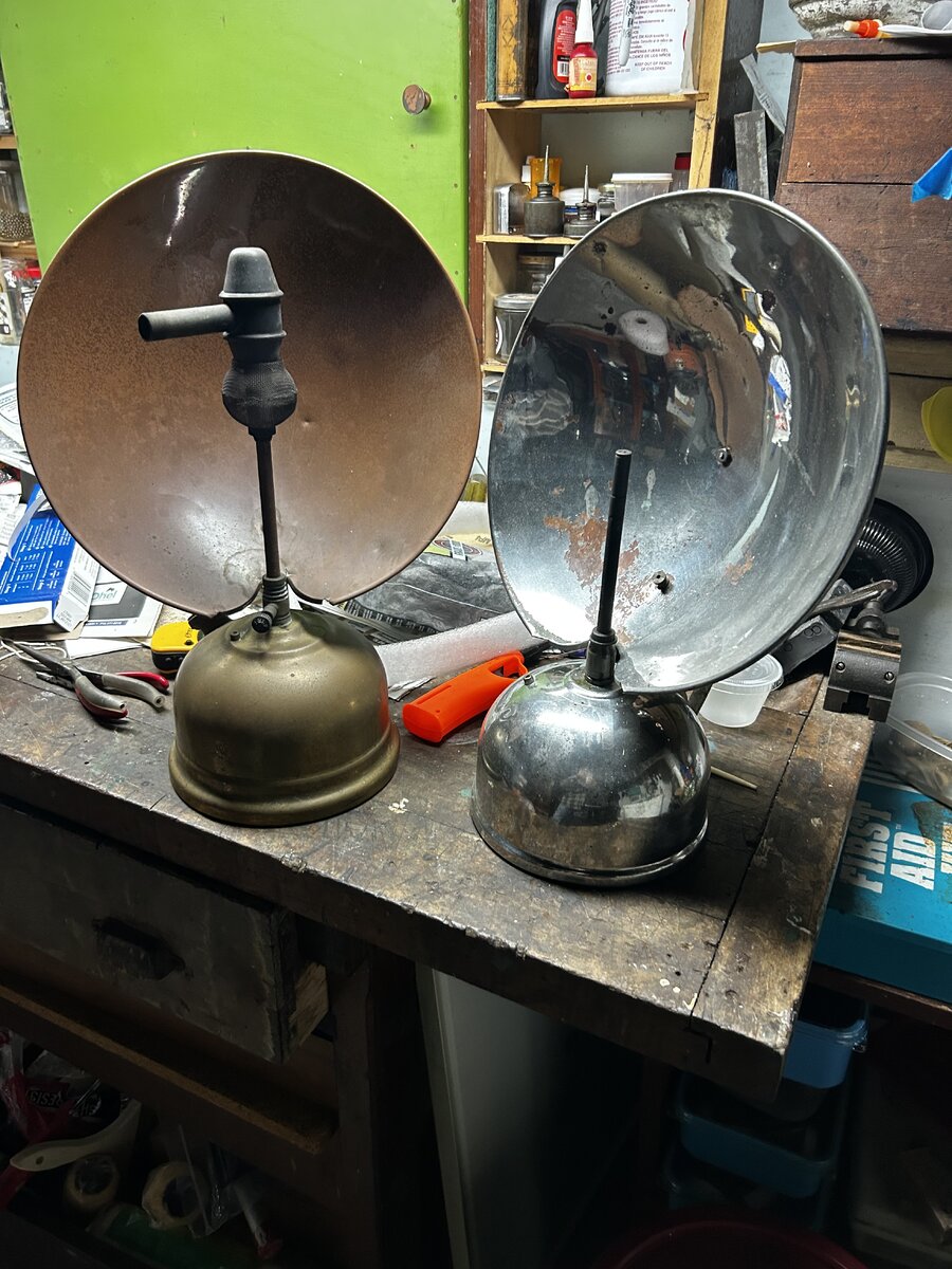

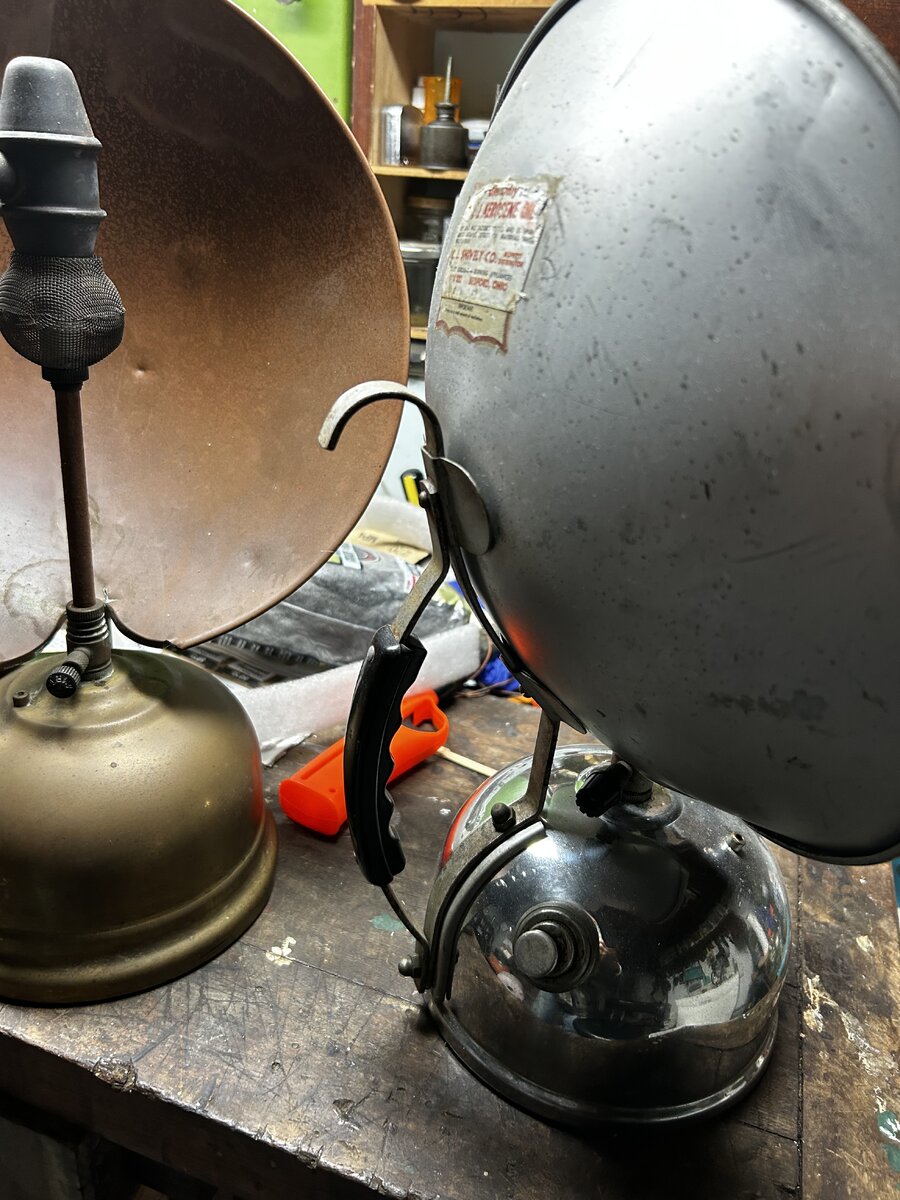

    So I moved the burner from another later model heater over to the brass R1. Will this be compatible?
  7. Sedgman
    1,267
    Victoria, Australia
    Compatible as in 'Will it work?' - Yes
    I believe your angled burner is from the mid-50s onwards.
  8. PaulH
    Jan 6, 2023
    19
    Australia
