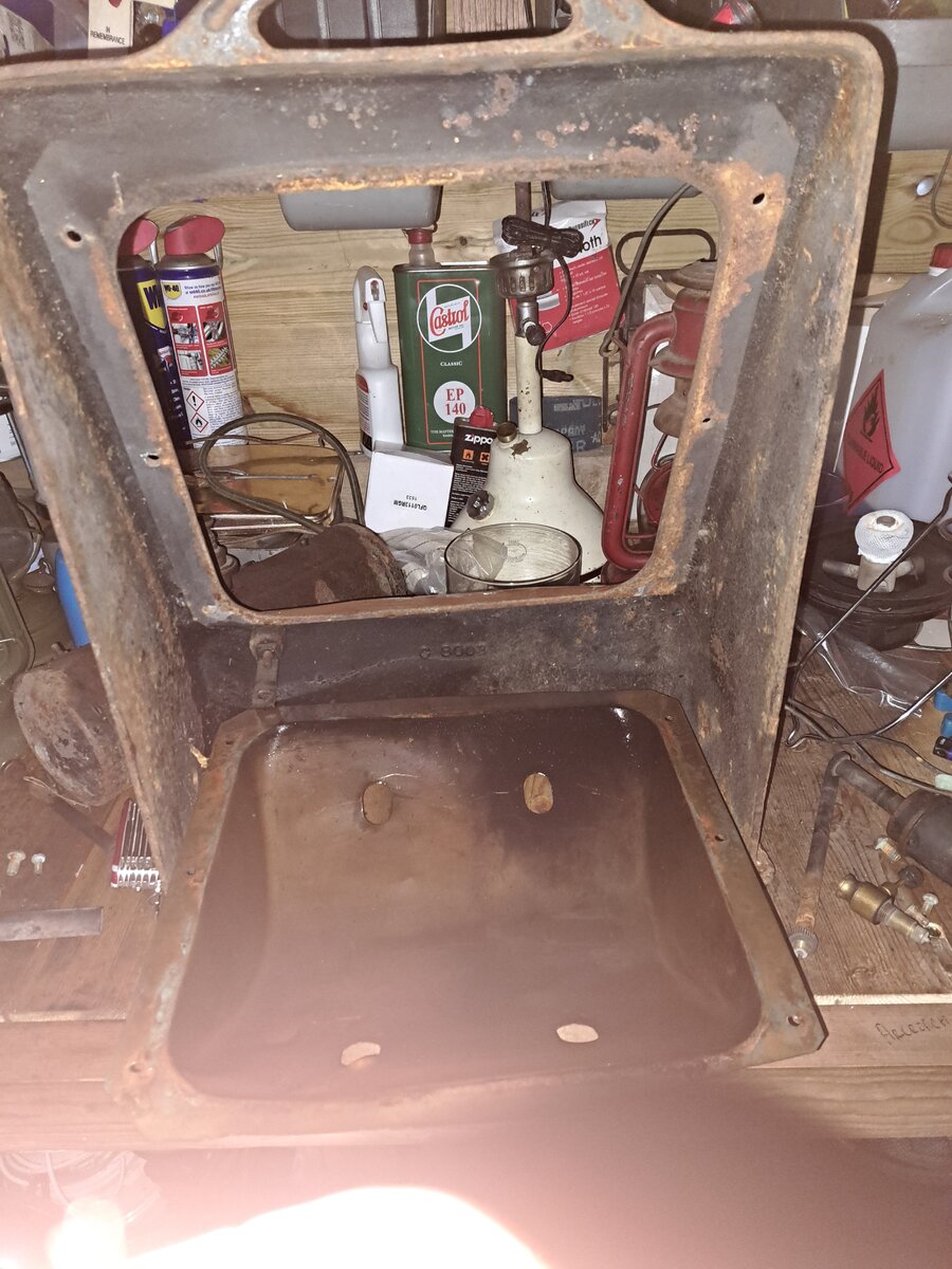

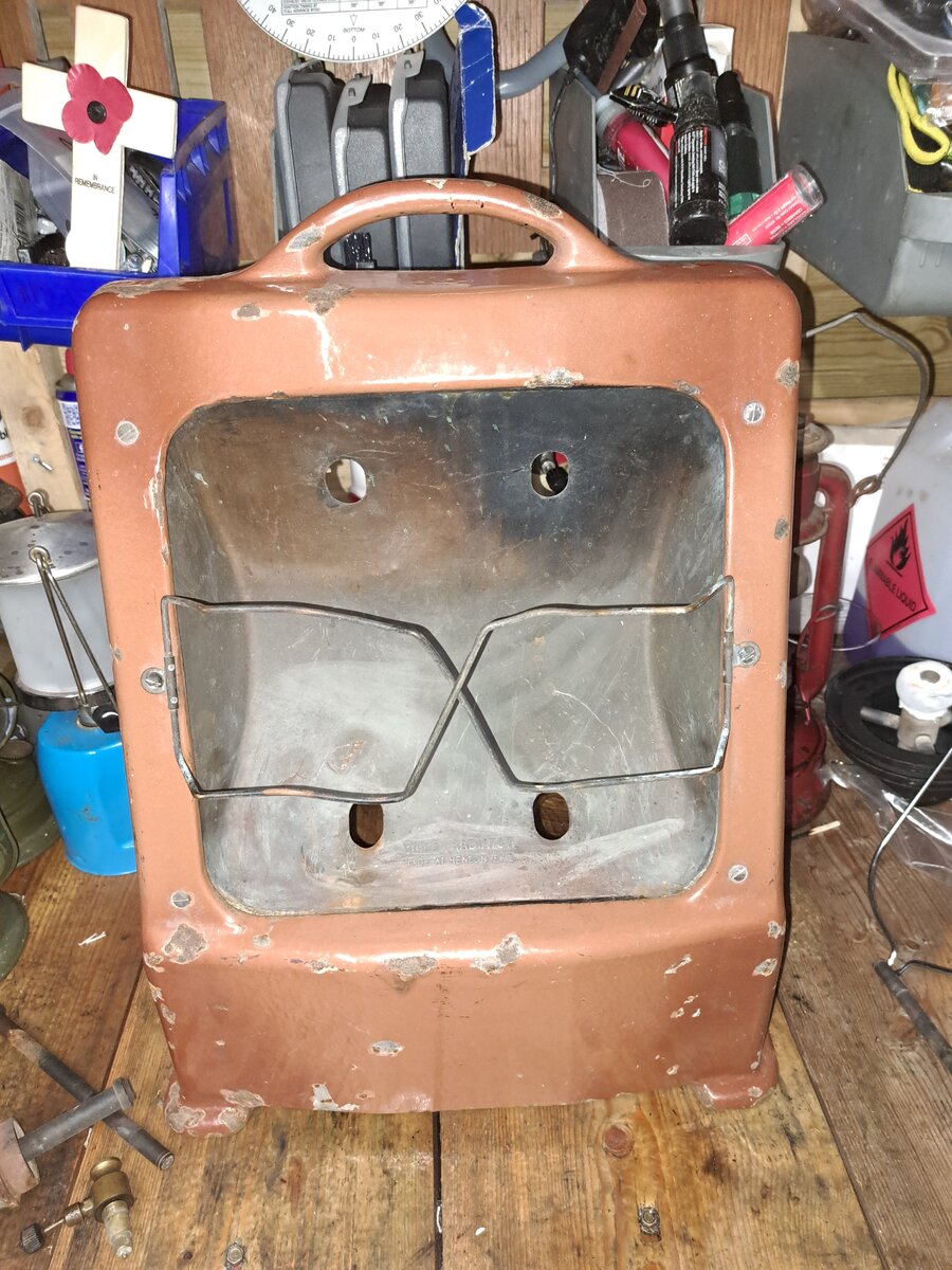

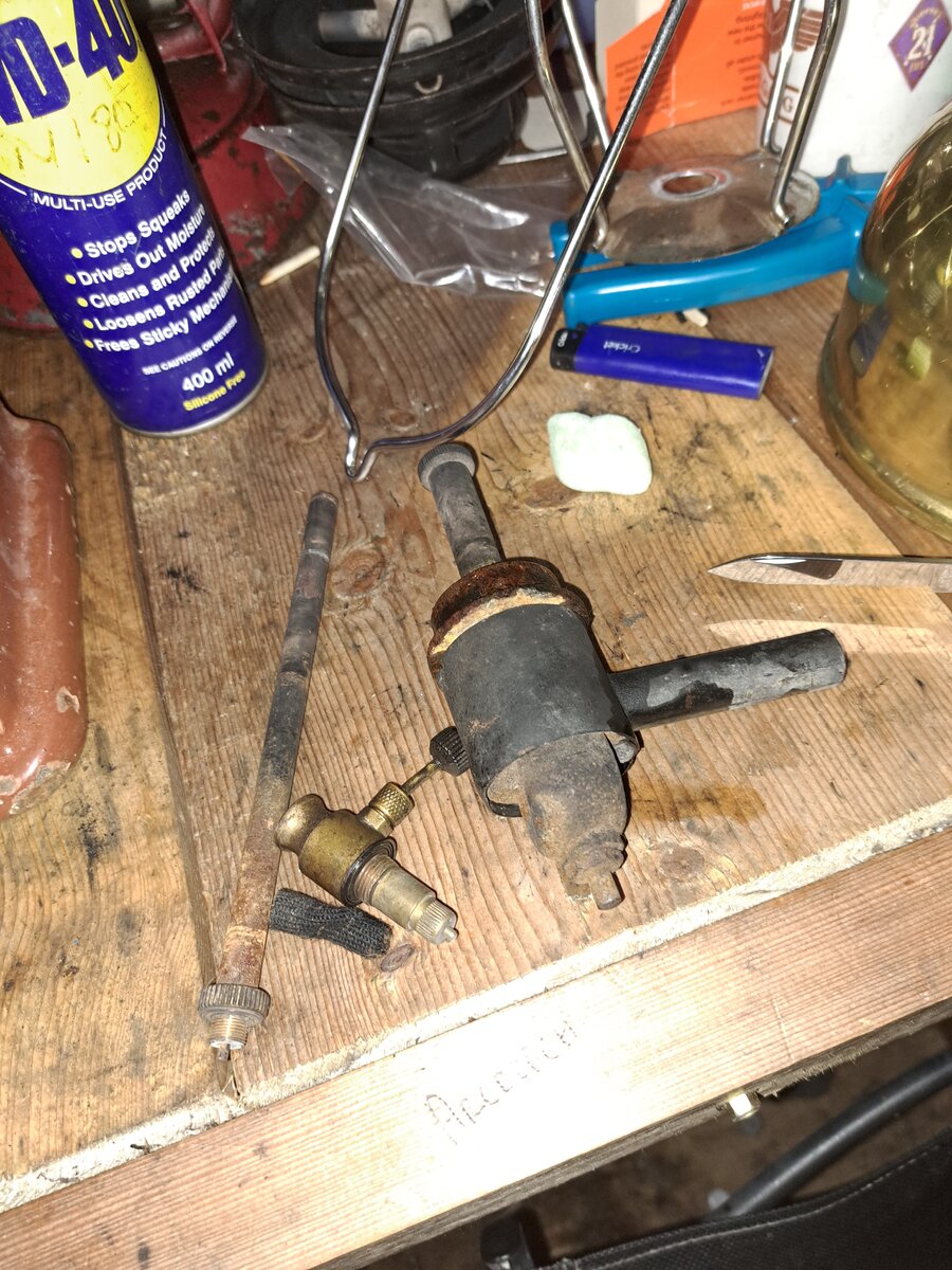

    Aye, but when it's up and running it'll have been worth every minute. Just wondering about the best way to polish the copper reflector.
  5. Tony Press
    Welcome.
    Polish the reflector carefully:
    First wash in soapy water; then, if there are any greasy fuel stains or soot remaining, clean with off an automotive degreaser.
    Next step is to use a metal polish like Autosol. With old plated reflectors, this should be a gentle, repeated, process to protect the reflective plating.

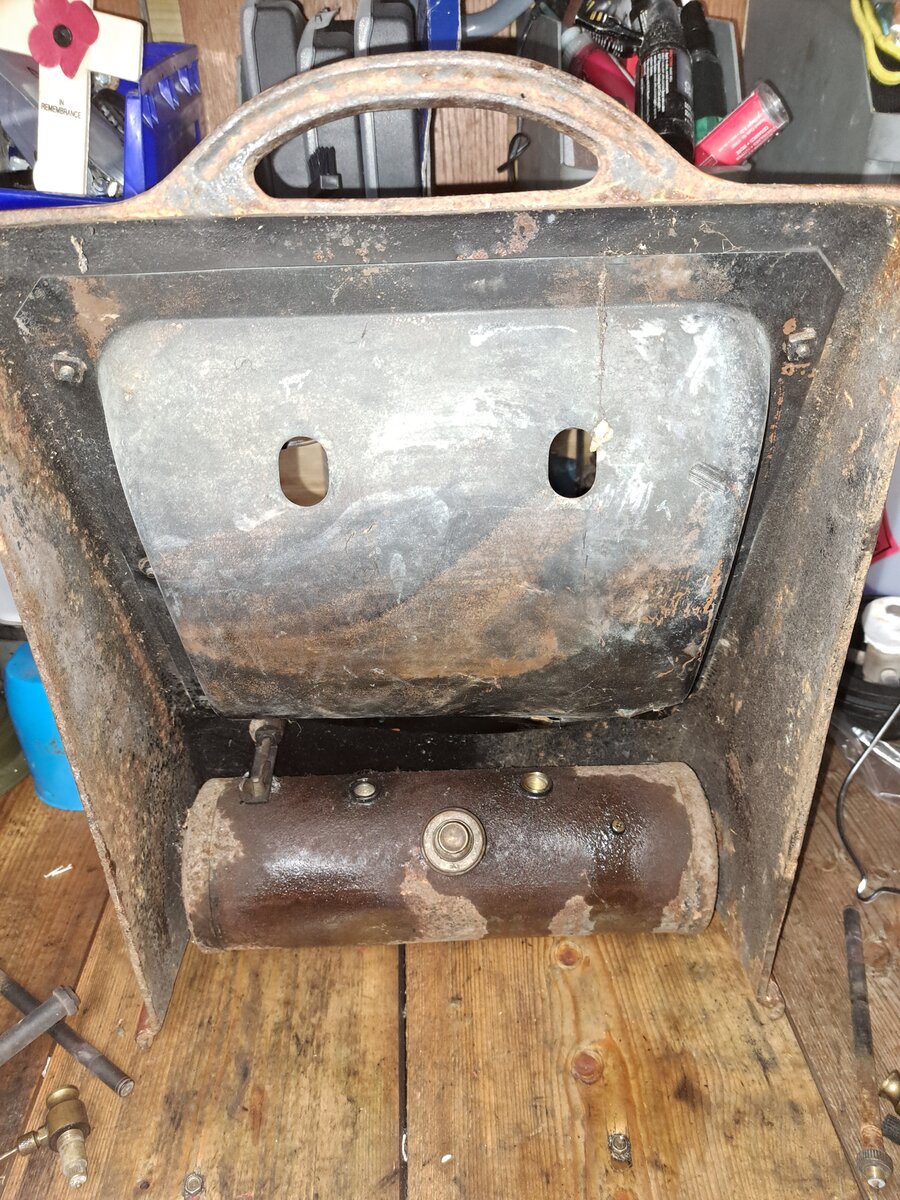

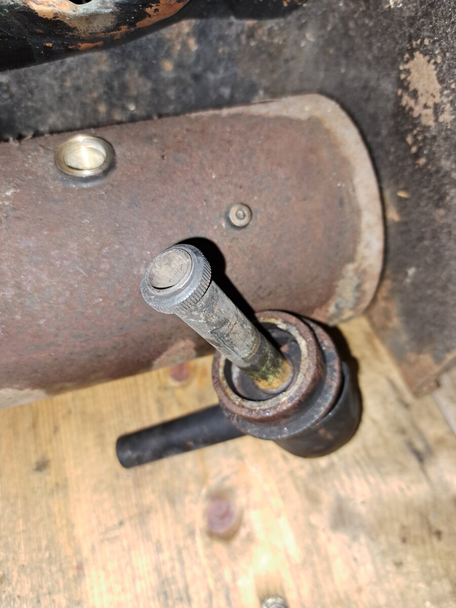

  7. podbros
    4,110
    Hi Norman
    I see you have one sock filter for the bottom of one control tap there :thumbup:
    Sometimes they fall off and can be found sitting in the threaded part in the top of the tank? Always worth checking in there.. Found a few like that
    good luck with everything
    regards
