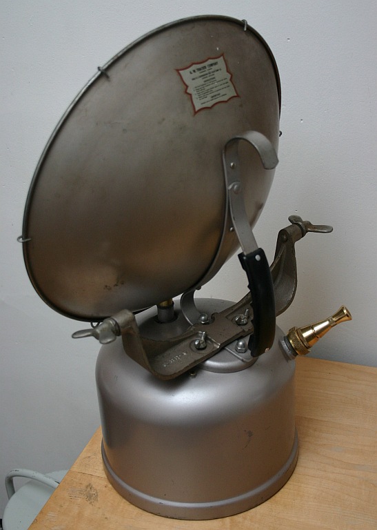

    Here's an example of an R55 with an R501 bracket.
    I can now mount my R55 to my FL6 low stand for better directionality. Usually however, I just use the R55 without the bracket as it works just fine on the floor.

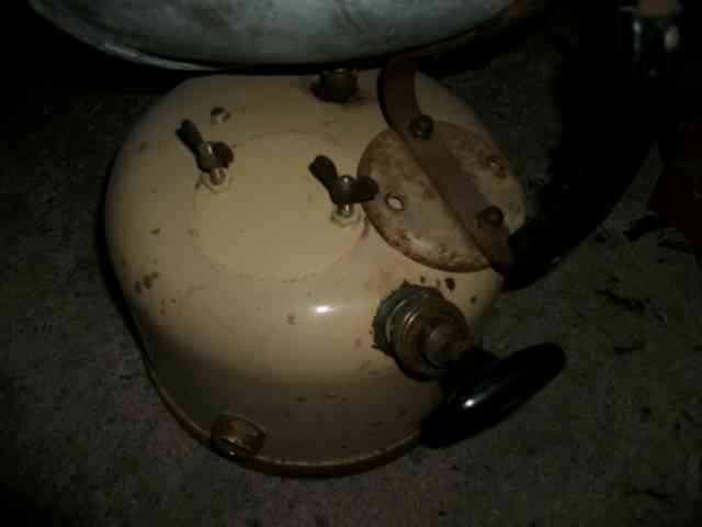

    Sorry about the dodgy pic - the R55 was at my store where there's no electricity - but it shows the arrangement well enough:-
    It's as I remembered - the wing-nuts attach the handle to studs fixed into the tank and the dome nuts merely attach the handle to the disc thingie...

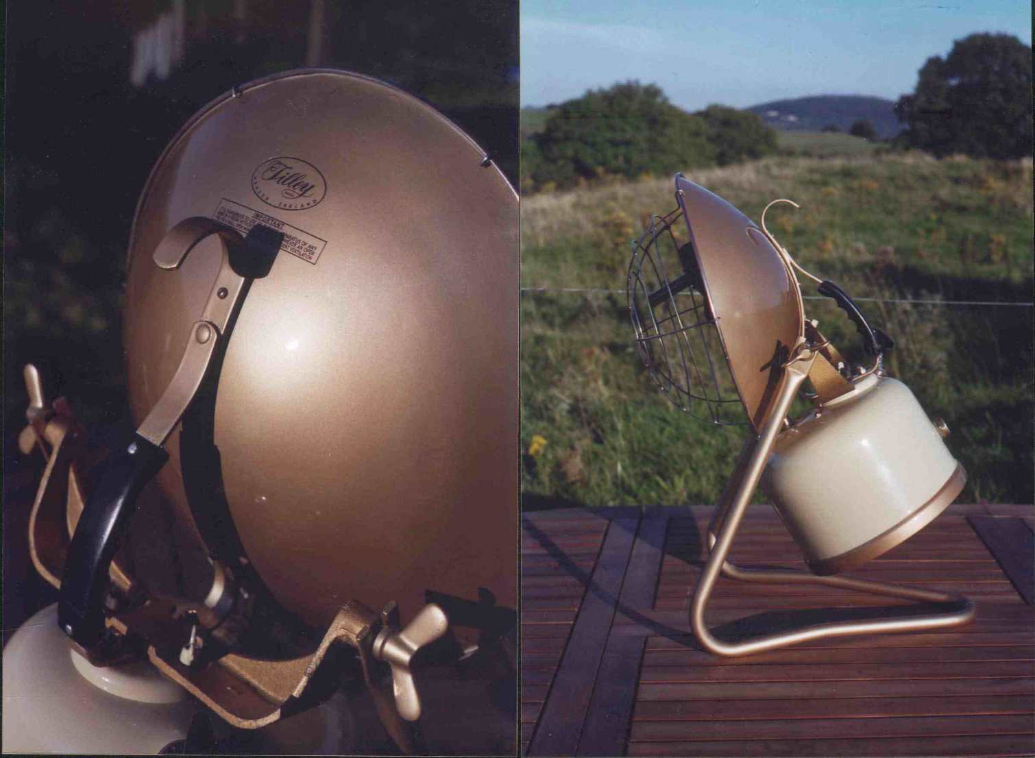

    I've not been on the CPU site for a while and noticed this posting. You might like to have a look at a cream R501 I have.

    377
    Thanks for that, all is now clear. I couldn't understand why they would bolt the handle to a plate and then bolt the plate to the tank with wing nuts.
