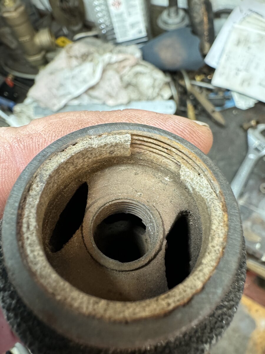

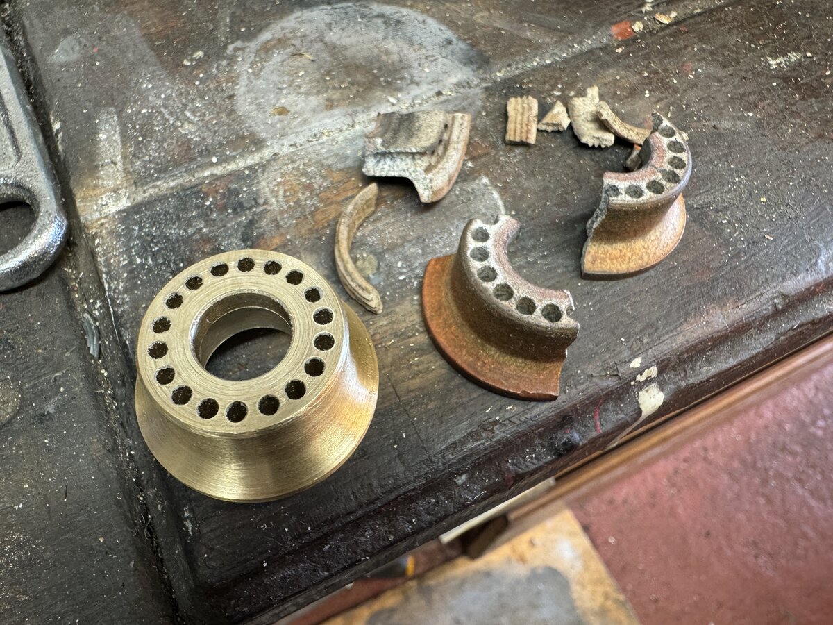

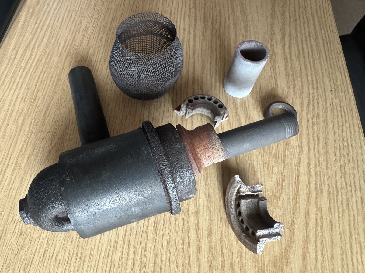

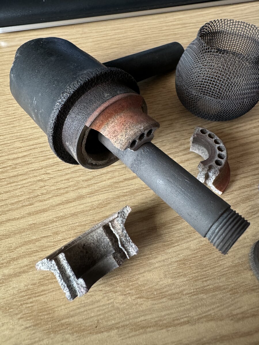

    I have been working on a Tilley radiator and the ceramic part of the burner head has cracked into several pieces. Despite having a look on the internet I can't seem to find replacement ceramic parts apart from the tube. Does anyone know if these are available? If not I shall have to get the lathe and milling machine into operation and make a replacement in brass.

    Yes definitely ceramic like you say. No need to get your coat :-)

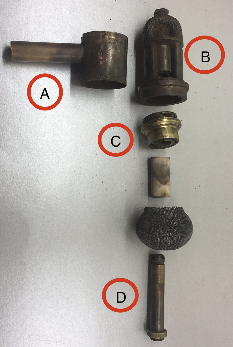

    New one to me also. Component ‘C’ on my burner is brass as you can see and it’s threaded to screw into the cast iron body ‘B’.

    Mine are also cast iron.

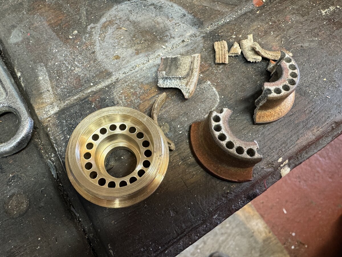

    Definitely ceramic, very light and brittle. Looks like I will be machining a replacement from brass when I get round to it.

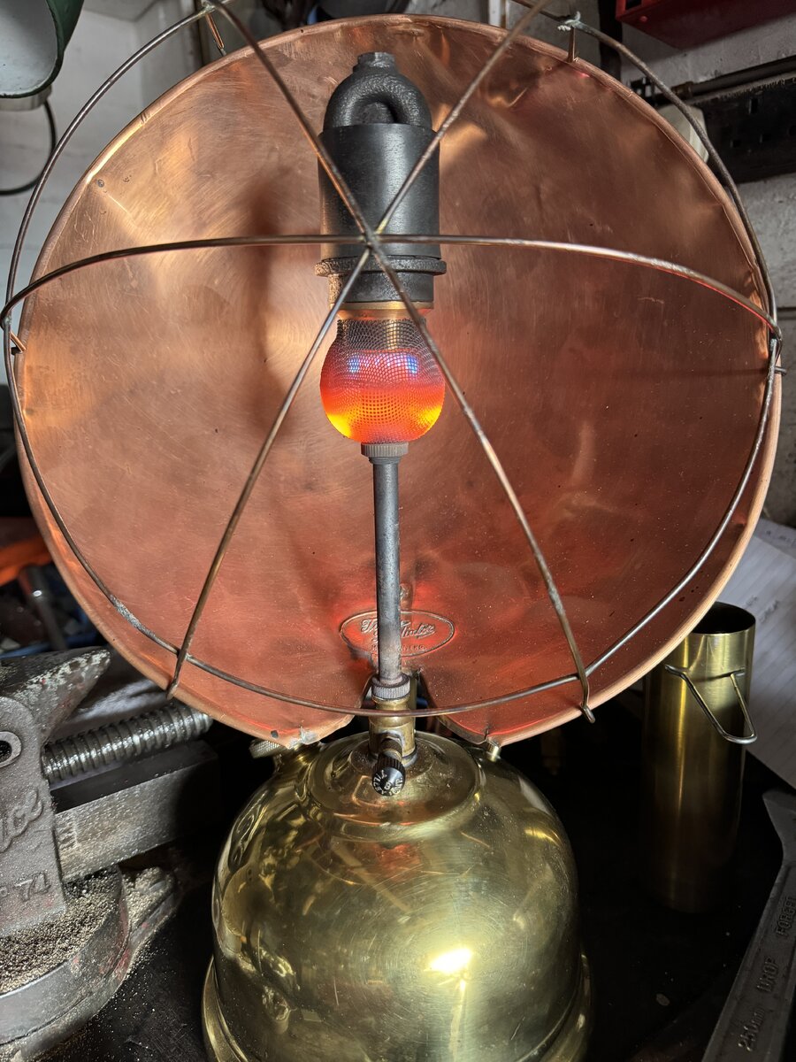

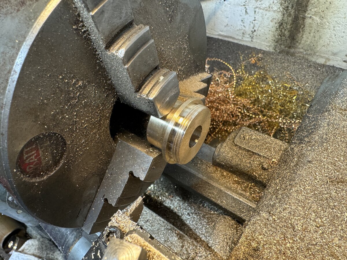

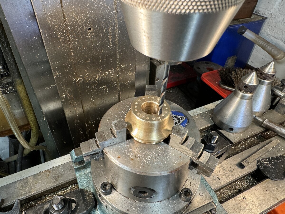

    For those that are interested I have made a replacement part for the burner head in brass. Working a treat now and been burning for a couple of hours no problem.
  11. presscall
    1,792
    Lancashire, UK
    Excellent work.
  12. ROBBO55
    4,448
    Nice work, excellent result :thumbup:

  14. MYN
    That's a nice piece of burner you've made :thumbup:
  15. Buggerlugs
    Congratulations and well done mate.
  16. podbros
    4,117
    Top job and great photos :thumbup::thumbup:
