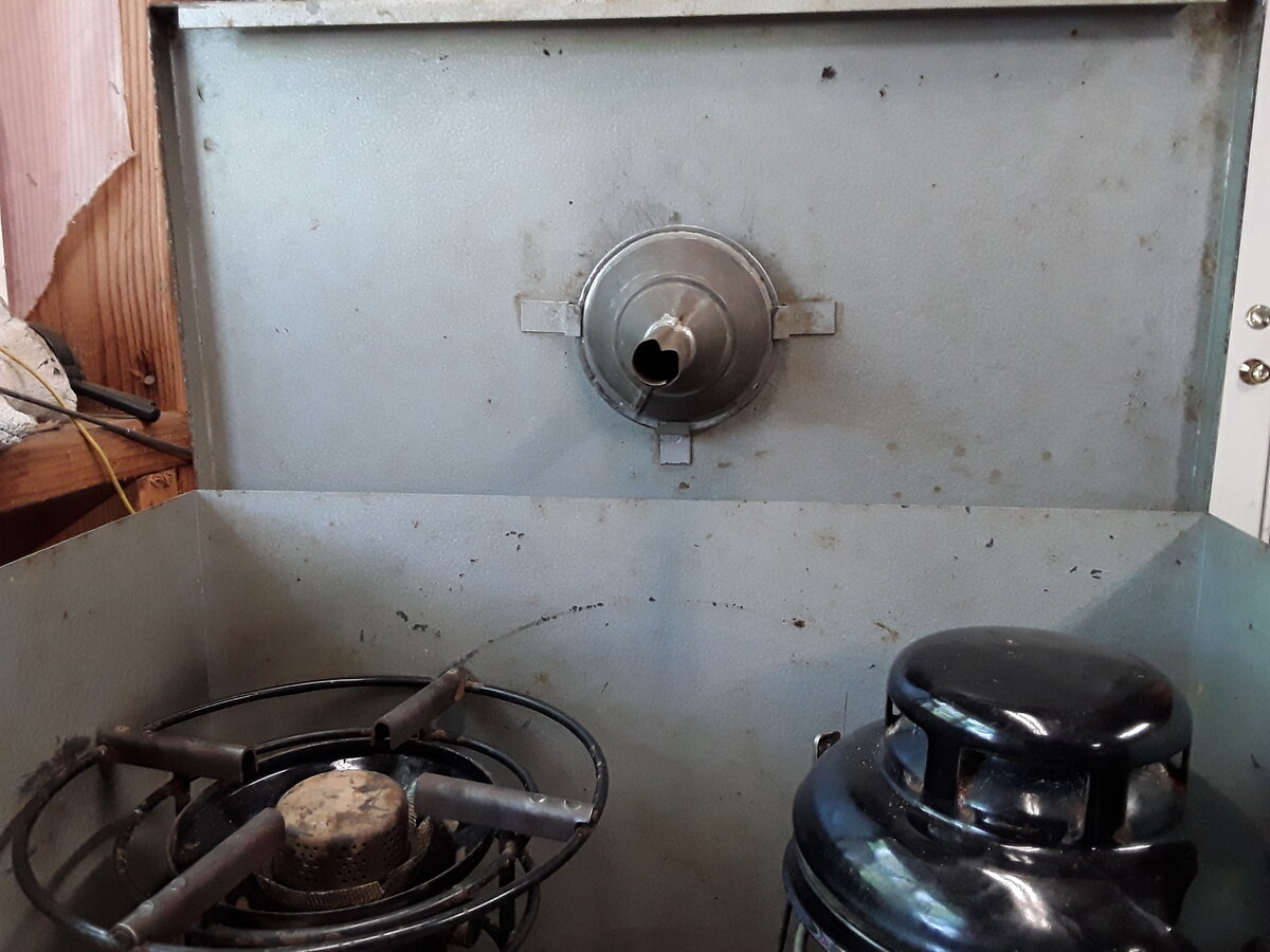

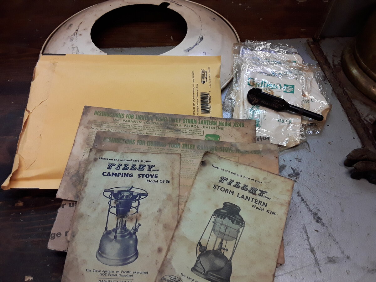

    Just got this. Figuring things out as I think about them a bit. Globe arrived over a week ago, just need to add a torch I have already. Has spare vaporizers, mantles, reflector, funnel, meths jar, dipstick, paperwork. Imported to the USA by Thacker

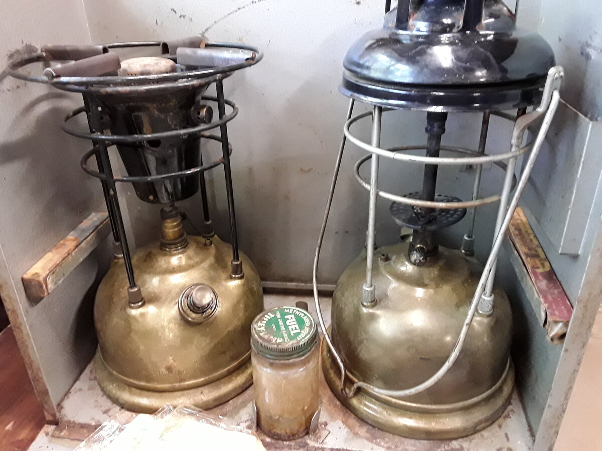

    Kit has a CS56 stove and a X246 lantern. A cool added part is a bug screen that clips on the lantern vaporizer under the globe.

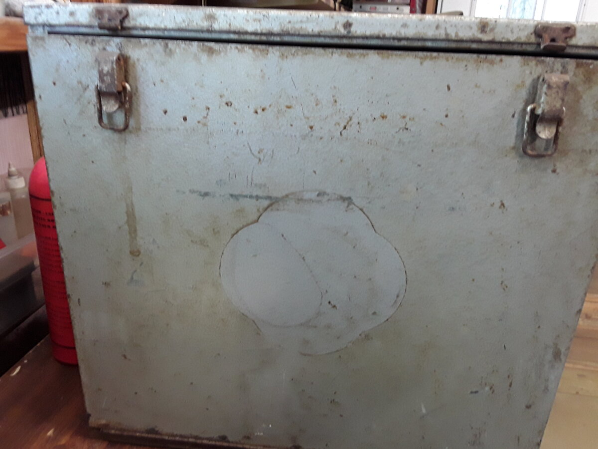

    The sticker (missing) at the front of the box? Is it this shaped? And 14cm (5 1/2 in) across?
  4. hikerduane
    Oct 2, 2011
    420
    Yes, 5.5" across.

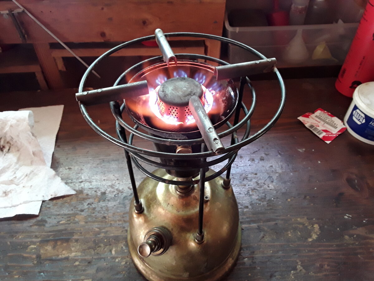

    I worked on the stove last night, pump is rebuilt, the pump cup had disintegrated, also soaked burner parts in hot vinegar for a few hours, the two pieces of brass screen had some sort of debris over spots, looked like the burner wasn't burning the best as there was some soot in a couple spots. May have to look at the parts chart to see order they back in, little more complicated than a bowlfire and my memory doesn't recall stuff.

    Thank you guys. The appliances have a A.W. Thacker sticker on the fount bottoms. The meths bottle is just located by clips is all. Both appliances have to be positioned just right so the reflector can set in its clips and the pumps don't rub or prevent the level sitting of them. I need to figure out the dipstick, which end is up. :) Busy today, so have not reassembled the stove yet. The lantern makes pressure, the stove of course had the ruined pump cup.

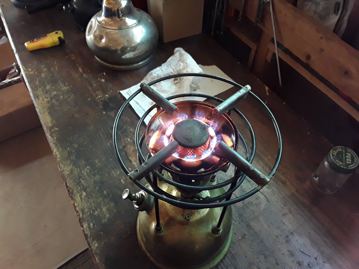

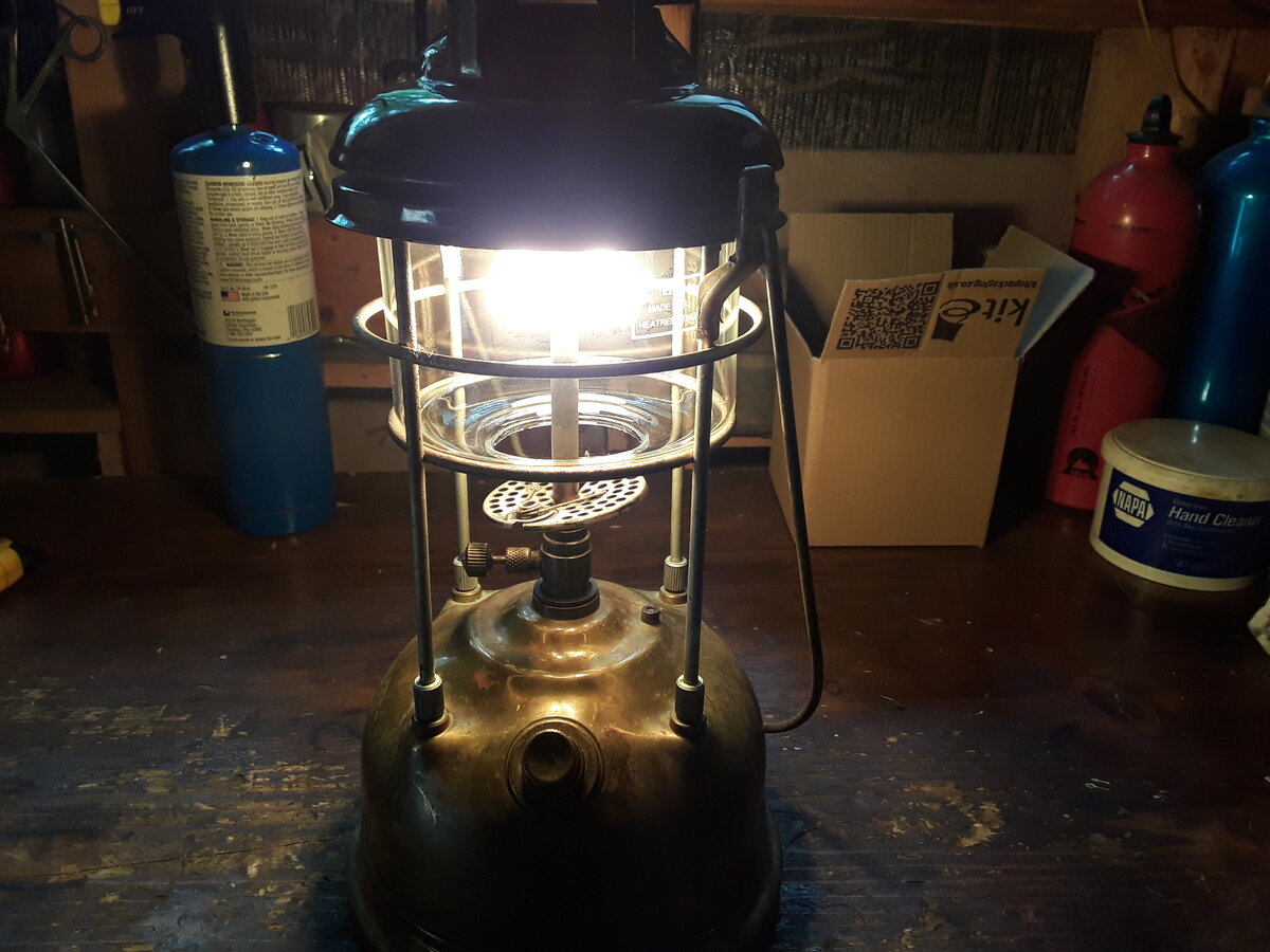

    Got it! Flame is getting better than photoed, who knows when it was last fired.

    The lantern was more cantankerous than the stove. Learned how to tie a Butterfly double tie to the burner, first one I figured out had no way to go over the vaporizer as I used a mantle with a single tie. Doh! Replaced washers with a kit from Ross. Ordered proper mantles I think. I think the bug screen goes on after the globe and sets at the bottom of the globe. Good learning. Valve leaks just a little, so will have to release pressure after use, which makes sense for the next use.
    Treated the fount interior with a lye solution overnight, rinsed some black dust out, it did look like it needed something.

  16. Henry Plews
    3,068
    No, it goes below the glass as you have it now. Slide it up to the glass after lighting, the spring should be strong enough to hold it in place.

    Being the split insect guard, I thought it optionally could go on AFTER the globe and sit at the bottom of the globe.

    Perhaps it's my sometimes mercurial mind, I was thinking going on after the glass would put it inside the glass which is of course incorrect.
  20. hikerduane
    Oct 2, 2011
    420
    I see in the Reference Gallery the bug screen goes under the globe.
