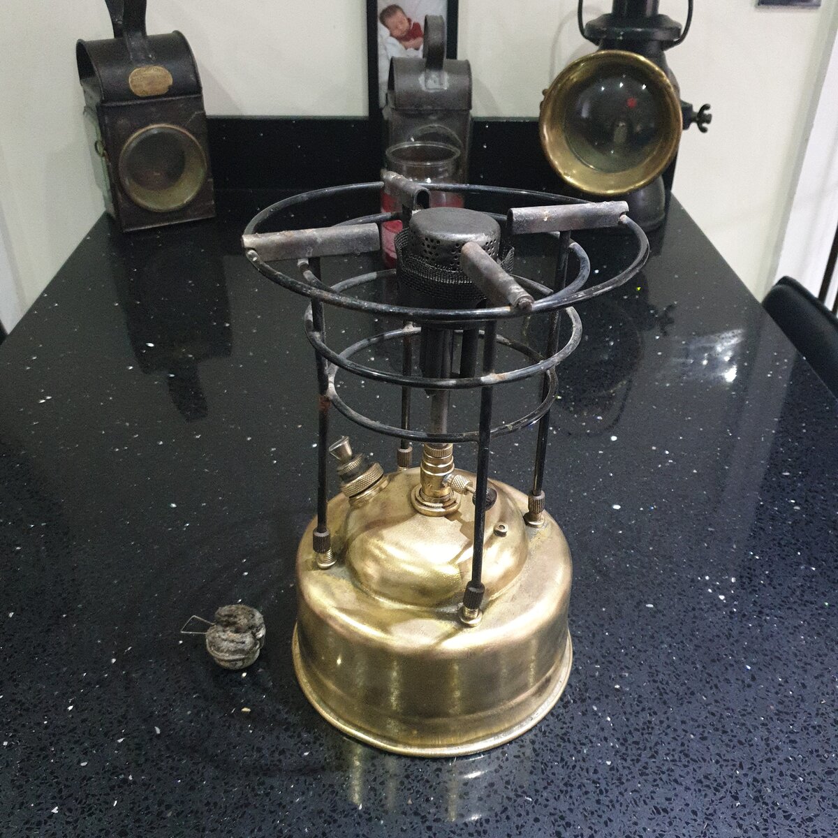

Tilley stove
Discussion in 'Open Forum' started by Tilleyz13, Mar 6, 2021.

    Never seen one with the pork pie tank before.

    I think they sold these also as a kit to covert your existing lamp.
    11,060
    @Tilleyz13
    Is that a conversion kit? A bit more information would be useful.

    Not sure

    Wow, that’s a first for me. Maybe @Anthony has some info?

    Stove CS56 was sold as a complete unit priced at 85/- in 1957 but they also sold a conversion unit type No 1657 for 44/3. In the price lists I have it was still available as a spare part to fit X246 lamps up to 1961 but I can't find it listed later. ::Neil::
  8. David Shouksmith
    Did the conversion kits still not have the truncated cone windshield to protect the three vapouriser heaters? - I can't see the vapouriser staying hot enough without it especially outside in a breeze. It appears to be missing from the unit above so given that, combined with the use of a pork-pie tank, my suspicion would be it's a 'marriage' rather than anything Tilley produced.
    I'm happy to be corrected...
  9. Tony Press
    11,060
    Definitely a marriage.
