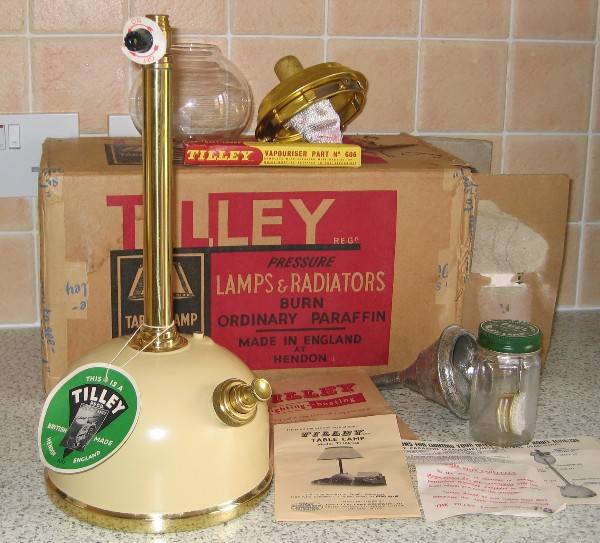

  3. Jimm77
    3
    Hi Ian
    This is my new in box TL106.
    You'll see the vapouriser is a 606
    All the best
    Jim
  4. Mackburner
    Yes all the table lamps after WW2 used the short 606 vaporiser. So all TL106/TL116 and TL120 and 120A were fitted with 606. It is short and most of these lamps look better and manage easier with the longer 169 but it is not strictly correct in these later lamps. ::Neil::
