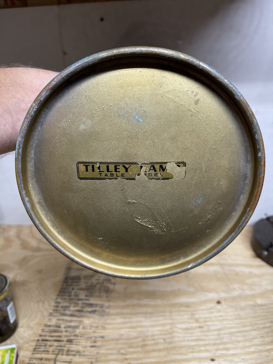

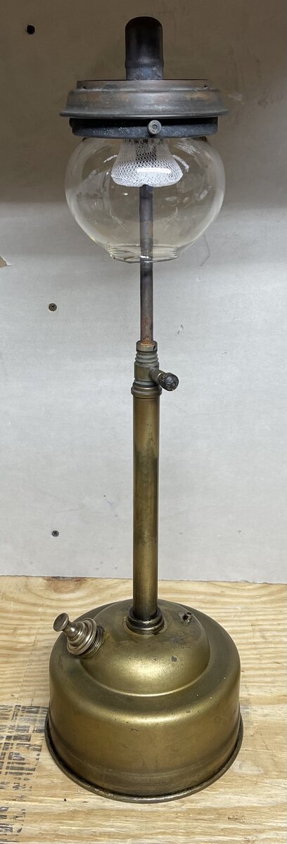

    Here is my example of the TL106 pork pie, fresh from the UK via the Fed-Ex truck. Luckily it was packaged securely inside a plastic bag as the whole of the inside was saturated with paraffin. [-X
    The thin pork pie pump looks neat, but loosening it a few times showed me pretty quick why they went with the thicker one.
    The paint doesn’t appear too bad given it’s age and it has a working pressure indicator.

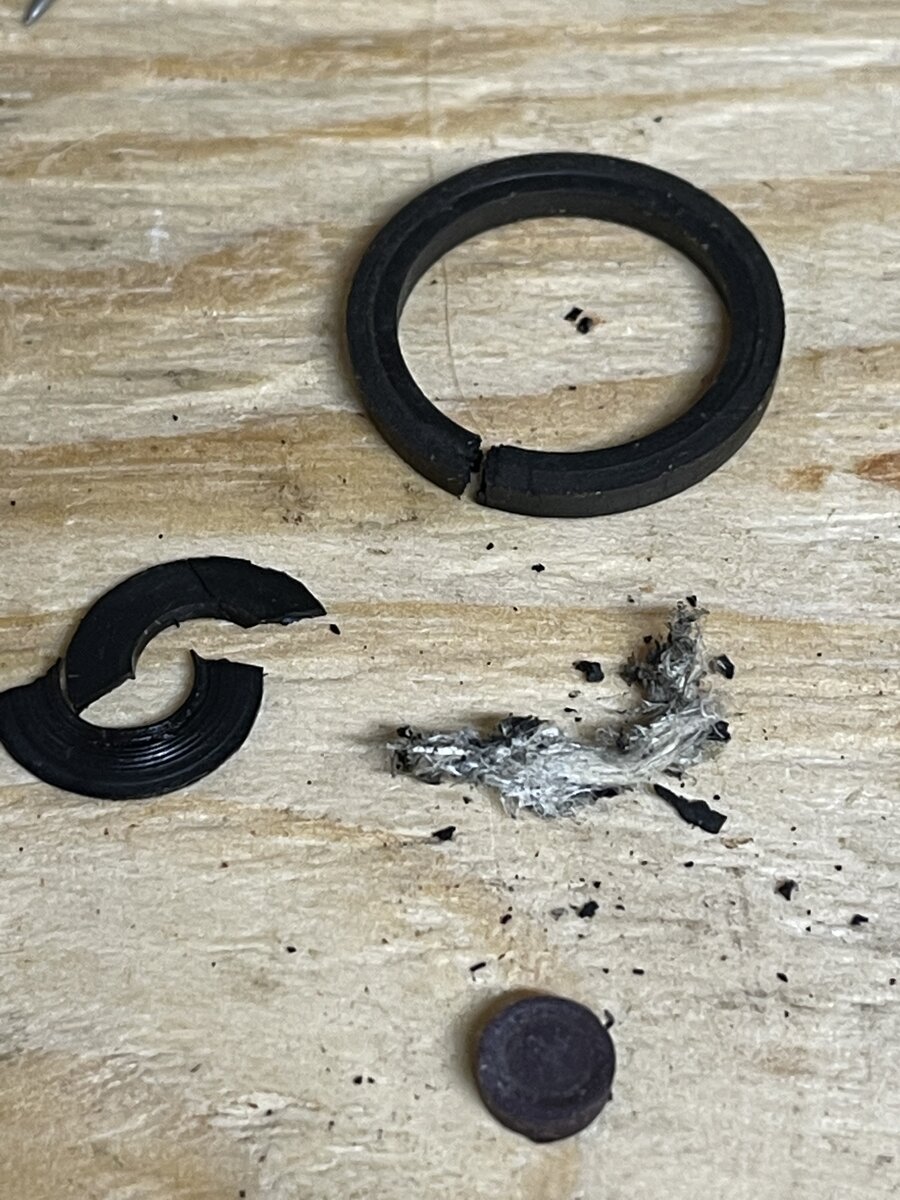

    Standard rock hard pips and the control cock nut had a string gasket material. A few seals from the Fettle Box fixed it right up.

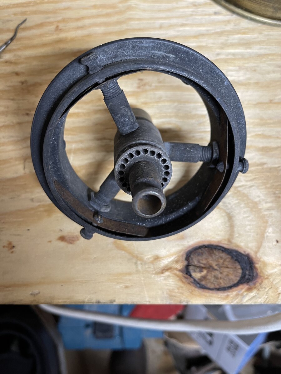

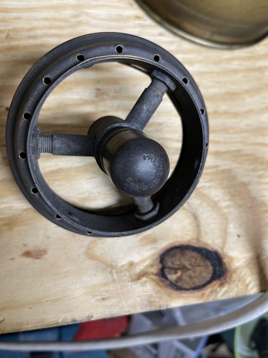

    First time I’ve seen a small nut holding the burner to the gallery.

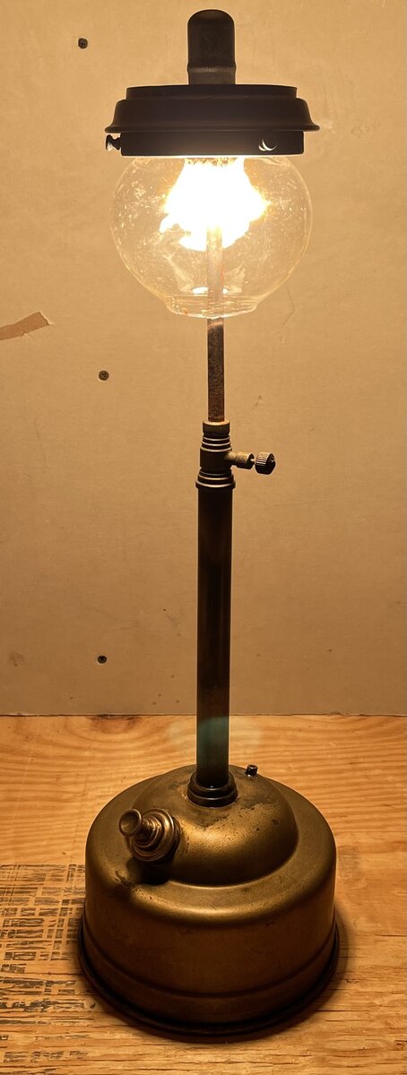

    I tied on a mantle and she lights right up even with a crusty vaporizer and fuel that was left in the tank.

    Nice as-found example :content::thumbup:
    Alec.
  3. BigStevie
    A nice original lamp and working well!
  4. Fireexit1 United Kingdom
    3,527
    Love it when a plan comes together. Looks great and is going well :thumbup:
    16,791
    A grand old Tilley which is now working well.:thumbup:

    There are other examples posted with the nuts to secure the burner to the gallery. So, appears to be original.
