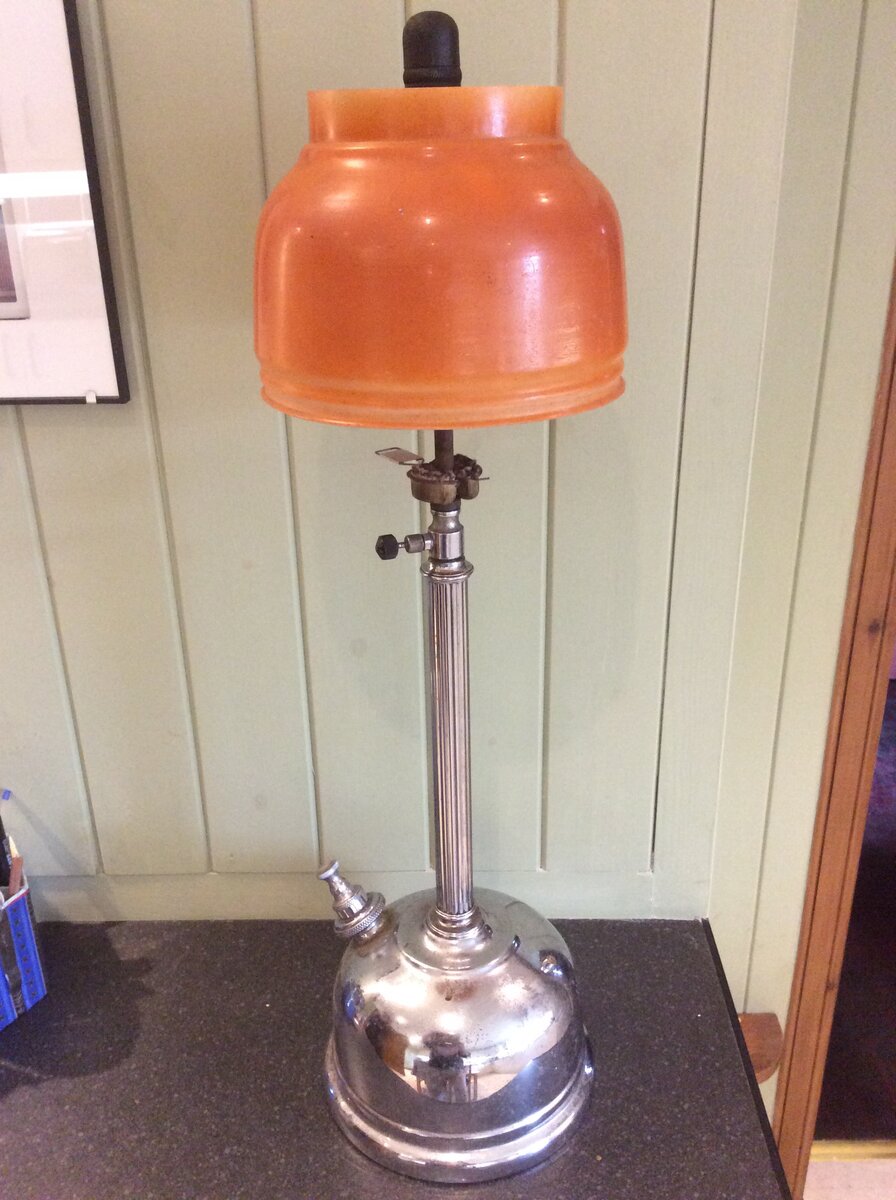

    Tilley TL11 as found, though I did give the globe and shade a dust off as they were black!
    Appears to be totally original, though the owner could only trace family ownership back to the mid fifties.

    Nice, nice, nice.... :lol: it does look very original - pump seems to show little wear from the photo

    It’s all muck around the pump, I think it’ll clean up well. One tiny ding on the fount.

    Nice TL10 with an interesting colour shade.

    Very nice ,I hope to find a shade of that colour one of these days,not too common I believe.

    I’ve never seen a Tilley shade that colour.
    After considering some paperwork and posts in this thread I think the shade with the top collar dates from mid-1940s (?post WW11), and just before the introduction of the “Pork Pie” tanks. Happy to move the date earlier if there’s more info around.

    This lamp, with its XN control cock, dates from before 1940, so a 1930s lamp. The shade is later (from mid 1940s onwards).
    Does the gallery have the external or internal steel springs?
    Tilley designated these lamps as TL10 if the lamp came with a glass shade and no globe, and TL11 if it came with a globe and no glass shade.
    In Australia, though, if the lamp came with a shade it was usually also fitted with the globe and insect shields because of our kamikaze moths and beetles.

    The plated gallery has internal springs.

    The gallery with the internal springs is pre-1946, so consistent with your lamp being 1930s.
