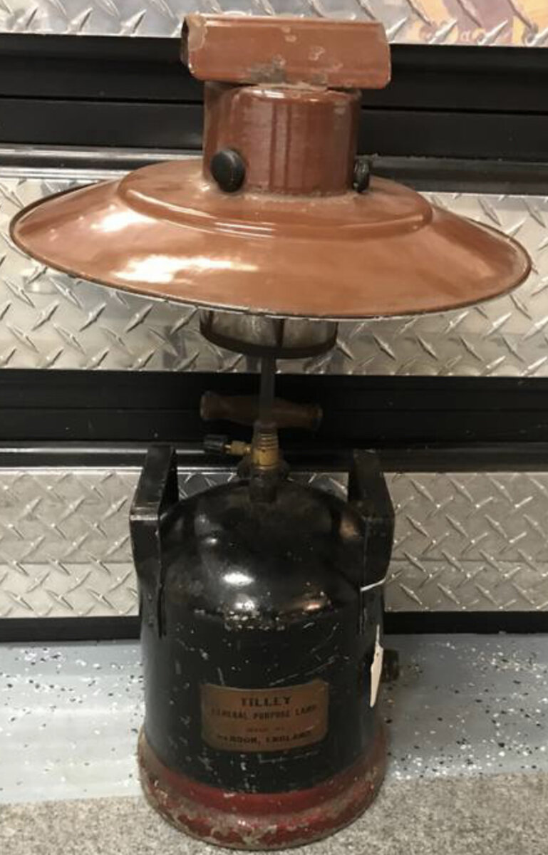

    Looked through the reference gallery and couldn’t find this one. Any idea? D6FA8D06-76D0-409E-9689-C048113D2178.jpeg

    I think it’s a Tilley GL1, or very similar. Pictured here in Jim Dicks book.
    16,919
    Stevie is correct and those lamps are scarce.

    It was for sale but I bought it. It looks nice. Good buy?
  6. Chad Campbell United States
    Jan 26, 2021
    93
    South Carolina
    Looks like it may be missing a piece or two from the picture in the ad.

    The mica globe is broken.
  9. podbros
    4,118
    Don't worry, it's a rare thing in itself, there are other ways of holding a glass globe in place, and you may be able to repair it!
    Mica sheets should be available, if not then there is a very reputable maker of mica globes in your part of the world
    You have done really well and as Jeff said, you have bagged an extremely scarce old Tilley ! :mrgreen:

    Rare lamp to find, even rarer in the States, it should have a glass, not mica, but the glass is rarer to find than the lamp, ohh it's missing the wire cage that holds the glass too...nice find though...

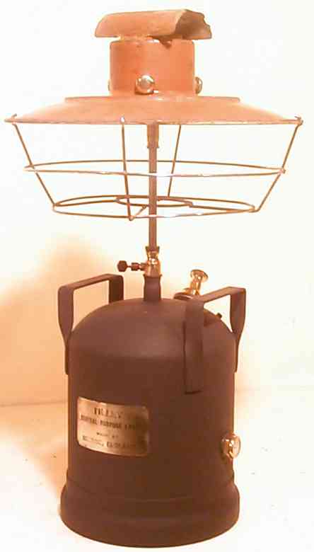

  12. Anthony

  13. Chad Campbell United States
    Jan 26, 2021
    93
    South Carolina
    @Anthony Thanks for the print ad. I would love to find the tri-pod! Was the tri-pod specific to this lantern or would any work?

    The top part was specific. The legs were the same for the FL.
    Having a look through some paperwork I find the glass for the GL1 is part number 801.
    What is odd is that all globes have `heat resistant` in brackets. The 801 does not.
    Perhaps this means the globe was so big it did not get so hot and if you found a glass that fits it would be usable even if not heat resistant.

  16. Anthony
    Anthony Australia Subscriber
    May 7, 2013
    1,658
    Theoretically yes. Practically no.
    I will see if I can find some clearer pictures and perhaps you could make or get one made.
    Worth doing for such a great lamp.
    A detailed post with size comparisons is warranted for this one.[-o<
