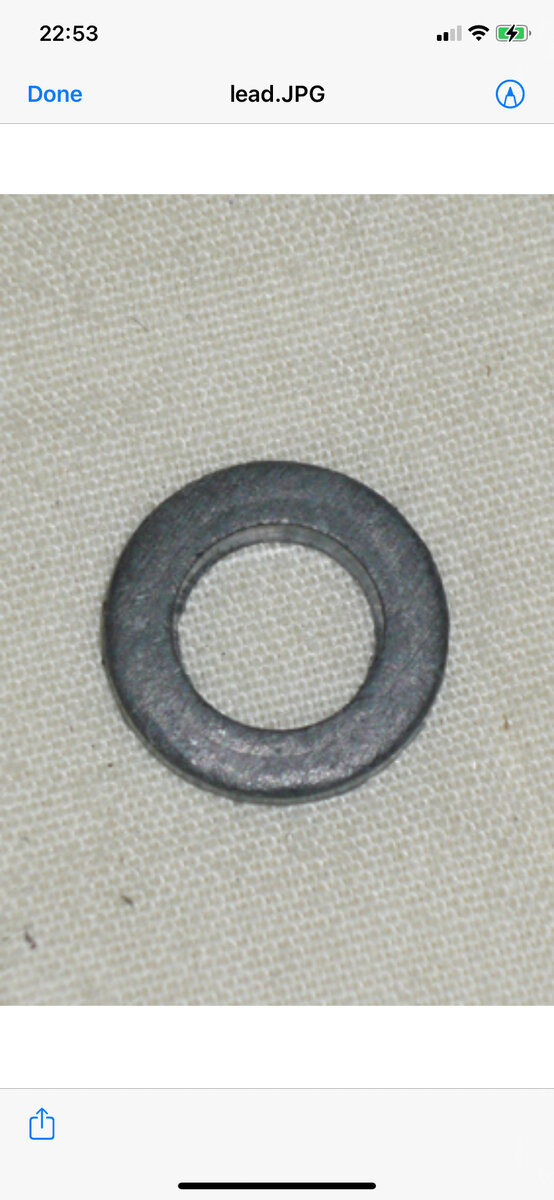

    Wow thats very kind of you Tony, thank you. I was sent a photo of the seal by Base Camp not sure if this helps.
    Thanks Henry for the seal sizes. I did contacted Base Camp in the UK and they were going to send me two lead seals along with the correct feet for my wall lamp. The photo below was the lead seal they sell. Here are the prices they quoted me.

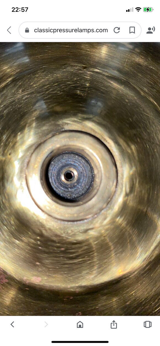

    Tony seeing I’ve never had a wall lamp before I wanted to ask a few questions. Seeing it’s going to be running inside the house every week am I best to put a new lead seal in. Below is a photo of how it looks now.
    If you think my lamp needs a new seal I would be grateful if you could please make me one. I have 2 different feet so wanted to get another foot eventually to change it back to factory original.
    It would be interesting to see what other wall lamps look like when the swan neck is unscrewed seeing how different visually they are to my current seal in the below photo.

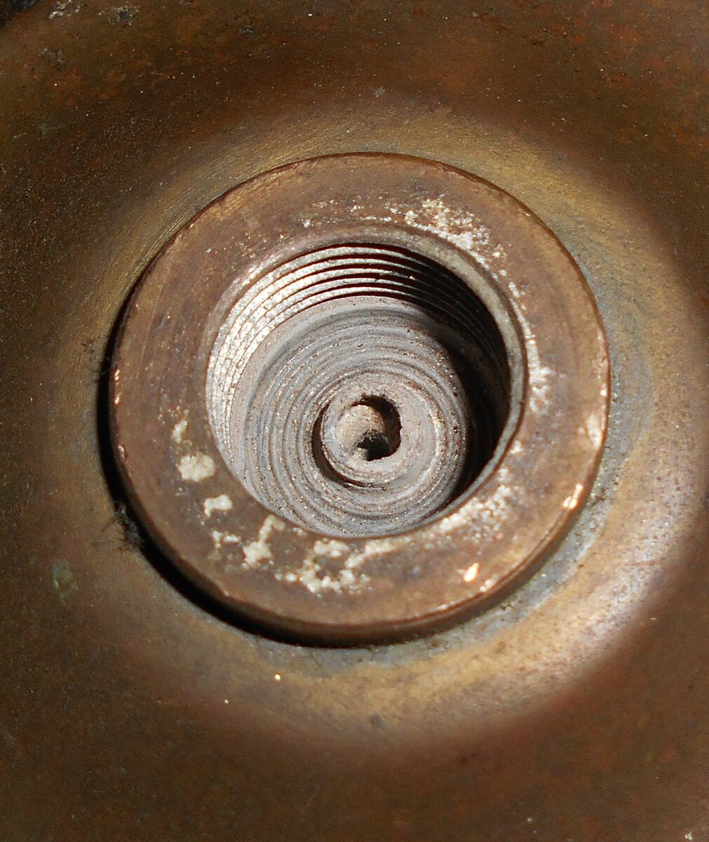

    Here's an image of the seal in one of my wall lamps.

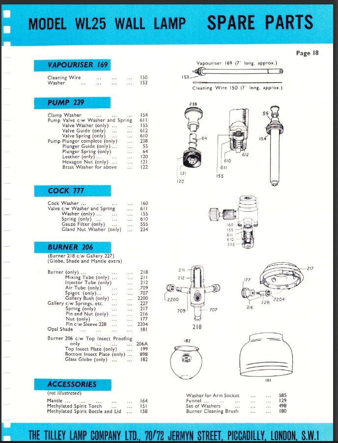

    Tilley Lamps WL25 Parts.JPG Bottom right hand side of parts list
    Does not state as lead washer so I checked my WL's
    1950's (GF control cock lamp = lead washer)
    1939-40 (XN bakelite knob = black hard washer) very old rubber I think
    I would have no hesitation using the hard rubber with application of a light smear of teflon sealant
  7. Henry Plews
    3,068
    A bodged repair.
    The correct material is lead, as shown in the image from base-camp.
