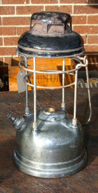

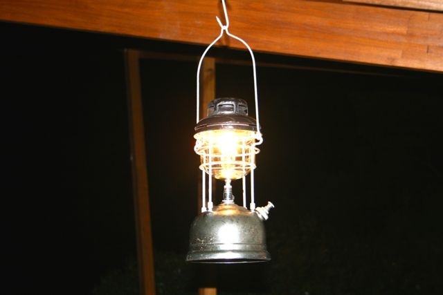

    I just fettled this X246 for a friend. It's good to see another one saved from the tip.

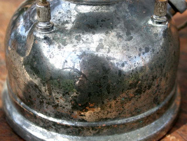

    It was a straightforward fettle. I did my best with the tank, but it obviously had been the subject of chemical exposure and some poor cleaning. I polished it up as best I could and finished it with car wax.

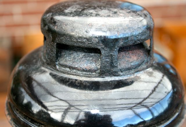

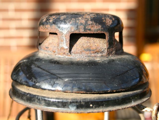

    The hood was very rusty... BUT, i think I've found the best rust converter ever! I'll put a little post in the Fettling section on the rust converter:
    Before:
    After:
    Note, above, the older style black hood (without the lip on the top dome).

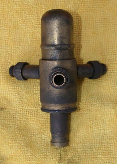

    It also had the older burner from which I had to remove a couple of dead spiders:

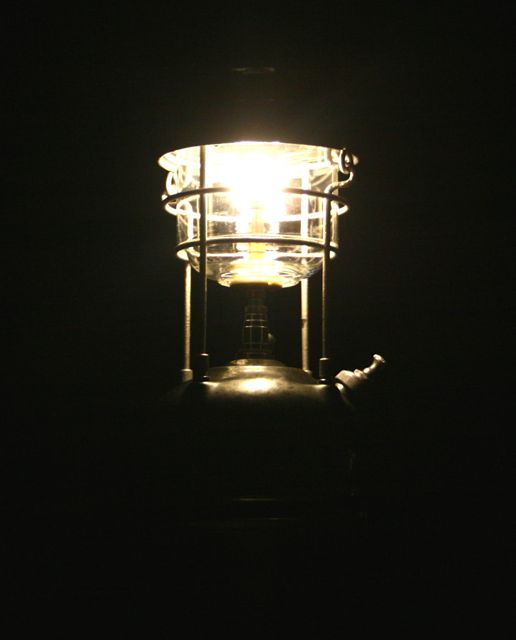

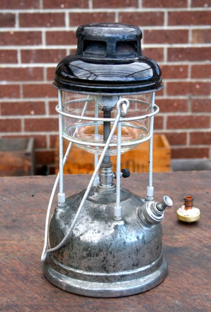

    I painted the cage with metal primer and VHT Aluminium paint. Fitted a new vaporiser and globe, and one of the Japanese mantles. Away she goes:
    Washers and seals from The Fettle Box.

    Well fettled! :thumbup:
    Tony Press Ukraine Subscriber
    11,036
    Thanks, Jeff.
    I think my friend will be happy - it was pretty sad when he gave it to me. Seeing that these lamps are as old as I am, it's good to get them working again.
    16,613
    Hello Tony, he should be pleased as he now has a good working lantern that should last for many years to come, Jeff.

    Anyone know what the rust converter was ?
    I cant see anything referring to it when I search "rust converter"
  6. Tony Press
    11,036
    @Beanie
    These days I use Ranax (which is an Australian proprietary product using phosphoric acid as its base) as my go to rust converter for jobs like this.
    I then paint the converted rust with pot belly stove black paint. It’s not gloss, but it withstands the heat.
  7. Beanie United Kingdom
    Mar 2, 2026
    69
    United Kingdom
    Thanks @Tony Press , been doing some reading around and it seems there are a few home made mixes about too :)
