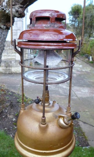

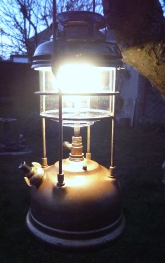

  13. Shed-Man R.I.P.
    1,032
    Kristian,
    You said "Hope it is not totally destroyed and abused like my 930, had to change everything on that one"
    Here are a couple of pics of the pre-1960 Tilley 246X that I can provide to you; and I will send more pics by E-mail tomorrow. I hope that this shows that it is "not totally destroyed, and that it is working like a good-un!" You will also get the spare mantle and preheater clip that you asked for. It's pretty good for a lamp that is over 70 years old. Steve.
    Steve.
  14. Kristian123
    Jul 25, 2012
    115
    Looks good to by me, was not expecting a wreck, but for that price you never know :). I actually dont worry that much about the looks, it is more important that they work as I will use them on lots of trips.
