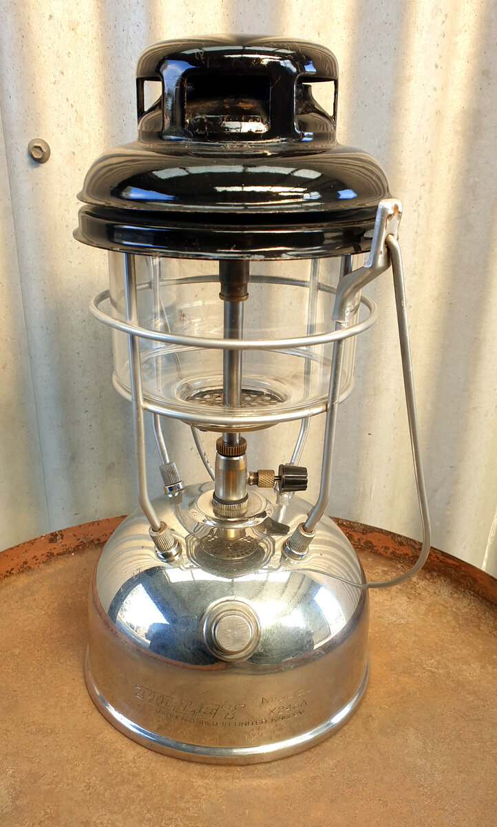

    The Regular ‘Angled’ X246A
    The new model X246A Tilley flagship lantern was released in September 1961 and manufactured through to December 1964. The model number was prominently displayed on the side of the fount through to around April 1964 when the model number was omitted.
    Tilley A246A (April 1963)
    Tilley A246A (Mid 1962) Pump knob; very V shaped

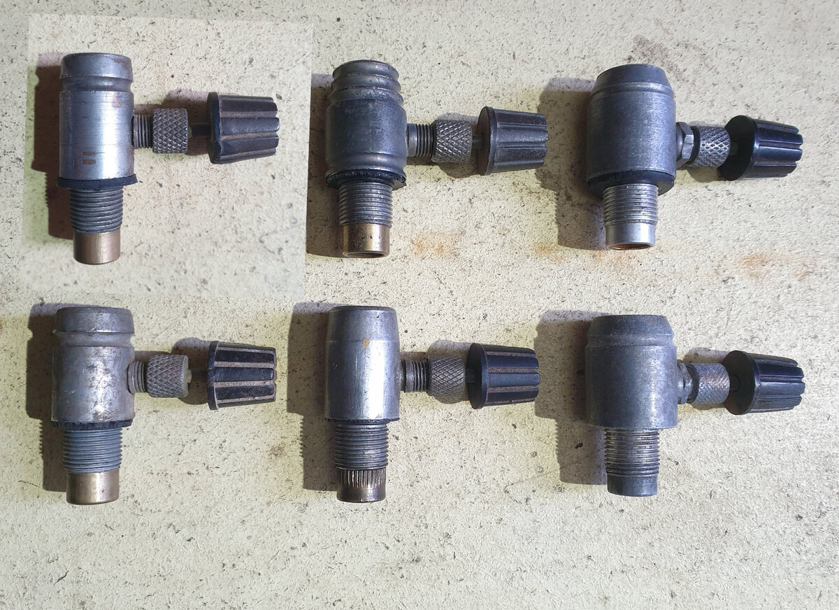

    The straight caged ‘Guardsman’ models with the X246A stamping usually had the GF2563 control cock. Regular X246A units had the GF777 control cock through to early 1962. After that the smooth X246A control cock appeared through to mid-1963. Lastly the X246A aluminium control cock featured a groove through to the end of production.

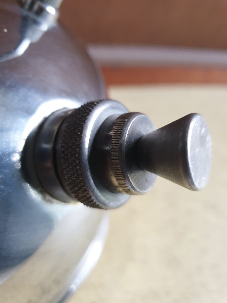

    Initially the ‘Guardsman’ type pump with its larger clamp nut and standard looking pump knob were used but around the middle of 1962 the smaller clamp nut and the very V-shaped pump knob appeared.

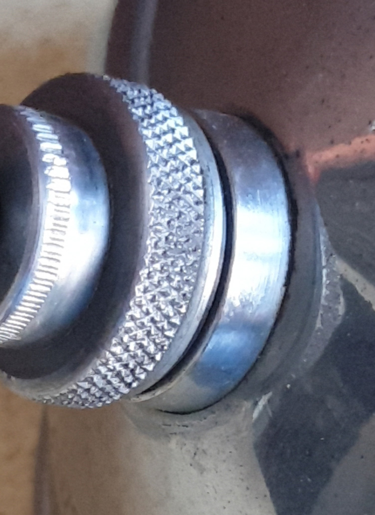

    The early threaded pump bushes were stepped with a slightly thicker part closer to the fount that was usually around 1.010” and the outer part being 0.987”. This is readily visually confirmed. Then from early 1963 the bush is smooth and almost a perfect 1.000” size.
    (L) The stepped bush & (R) The smooth bush

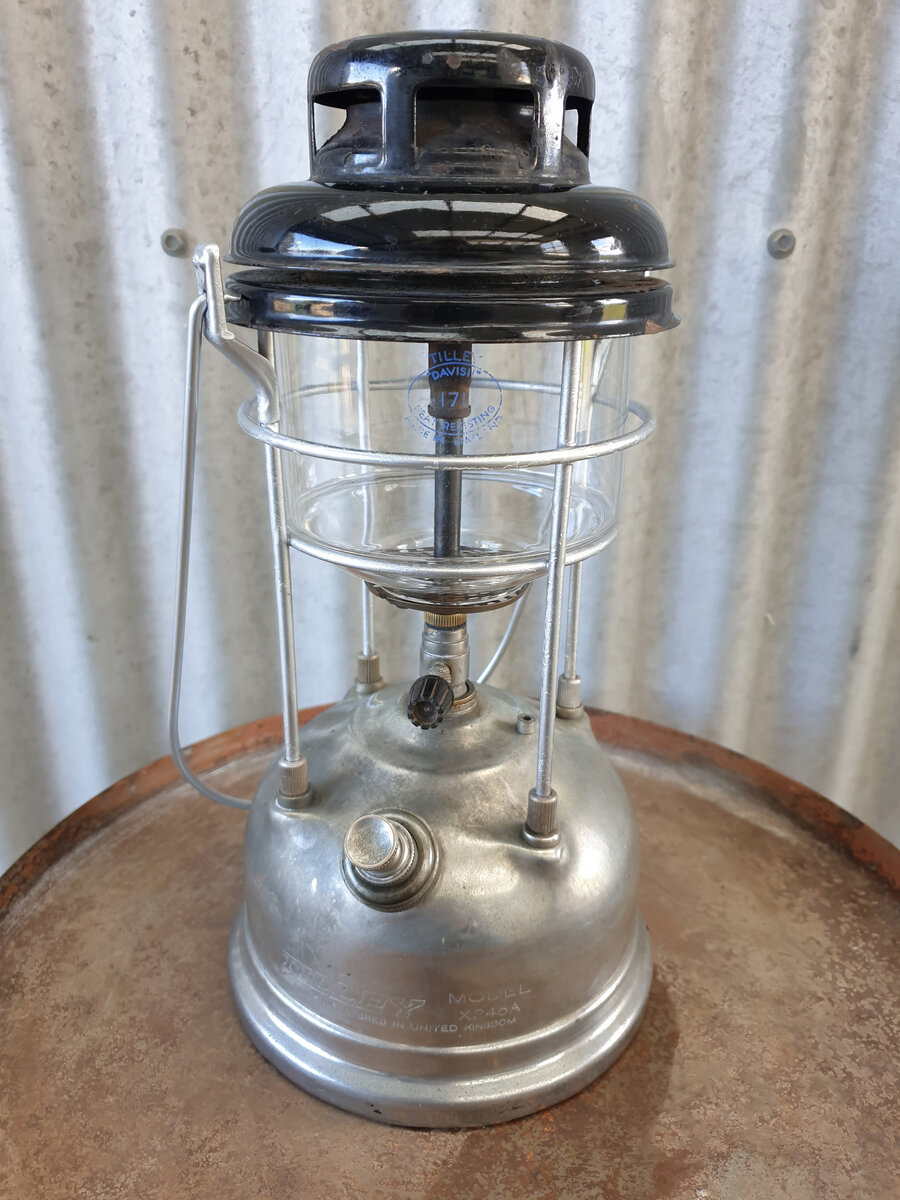

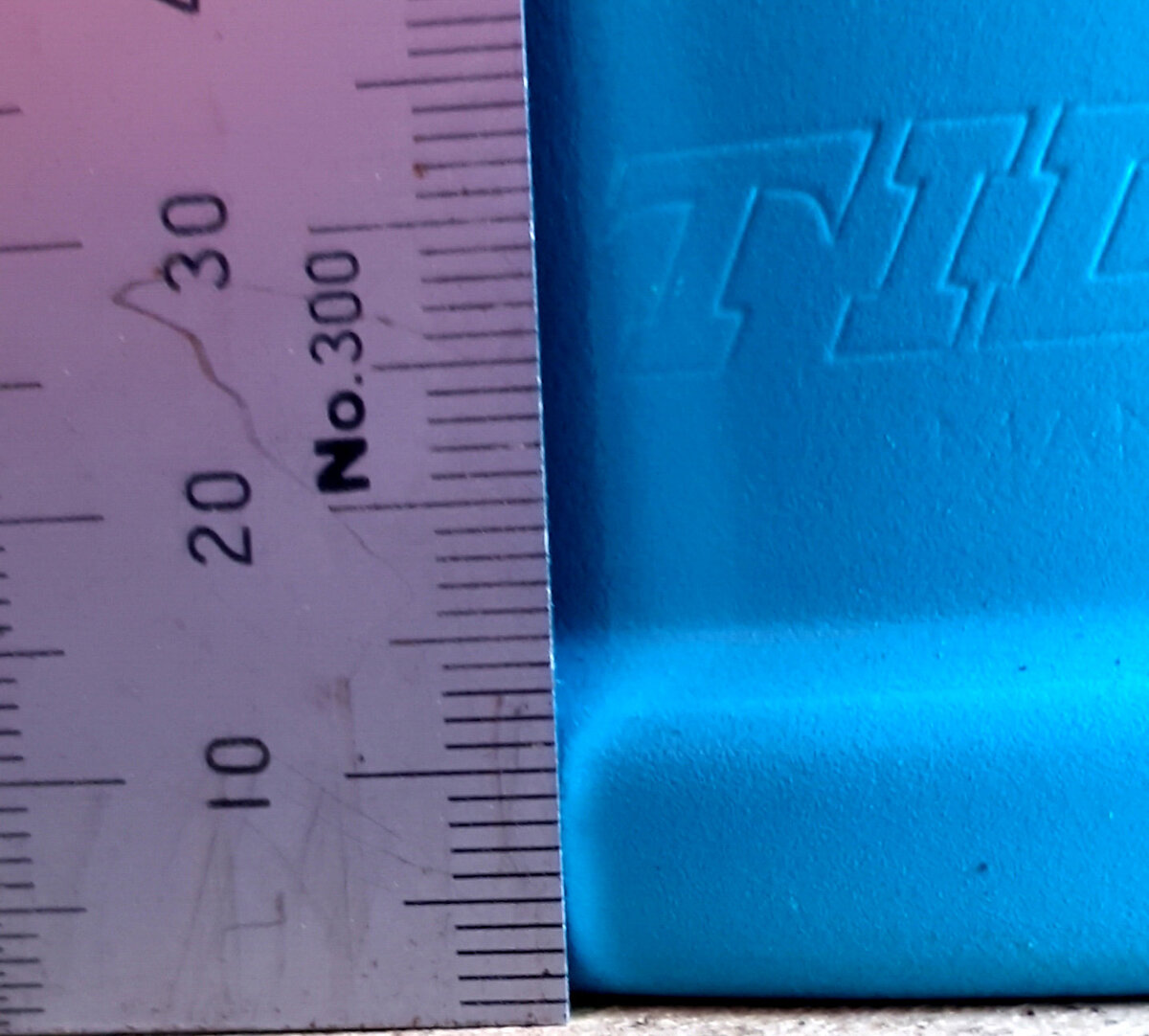

    The earliest X246A founts have a taller rim (15 mm) than later models (10 mm) and appear to be the same base font as was used in the X359.
    Tilley early X246A with taller rim
    Tilley X246A (1961 to 1964)

    Early Production

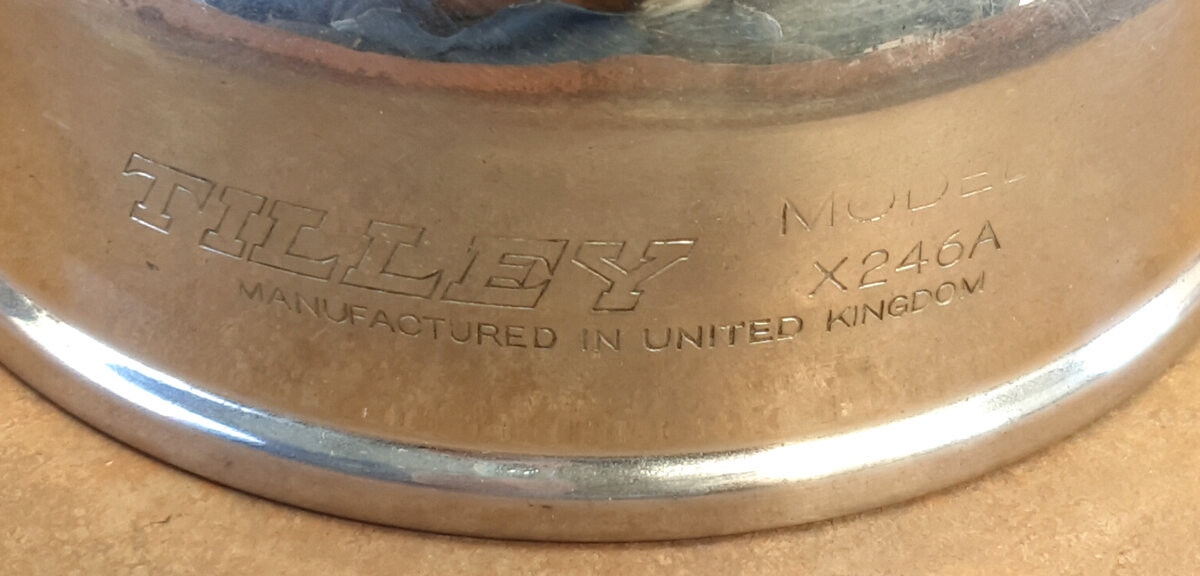

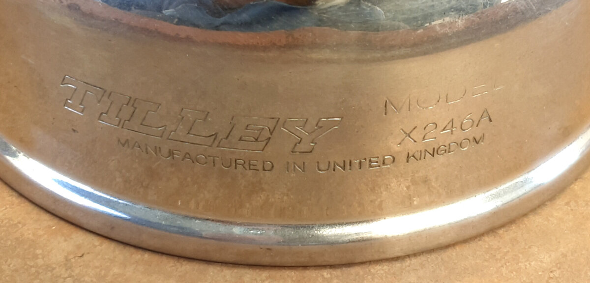

    • Side of fount stamped “TILLEY Model X246A Manufactured in United Kingdom”
    • Very early production models, e.g., Sep 1961, have a taller rim.
    • Pump clamp nut - large size
    • Threaded pump bush – stepped
    • Control cock GF777 initially
    • Brown hoods until June 1962 then black, but export models were probably all black

    • Pump knob strongly V shaped (about mid 1962)

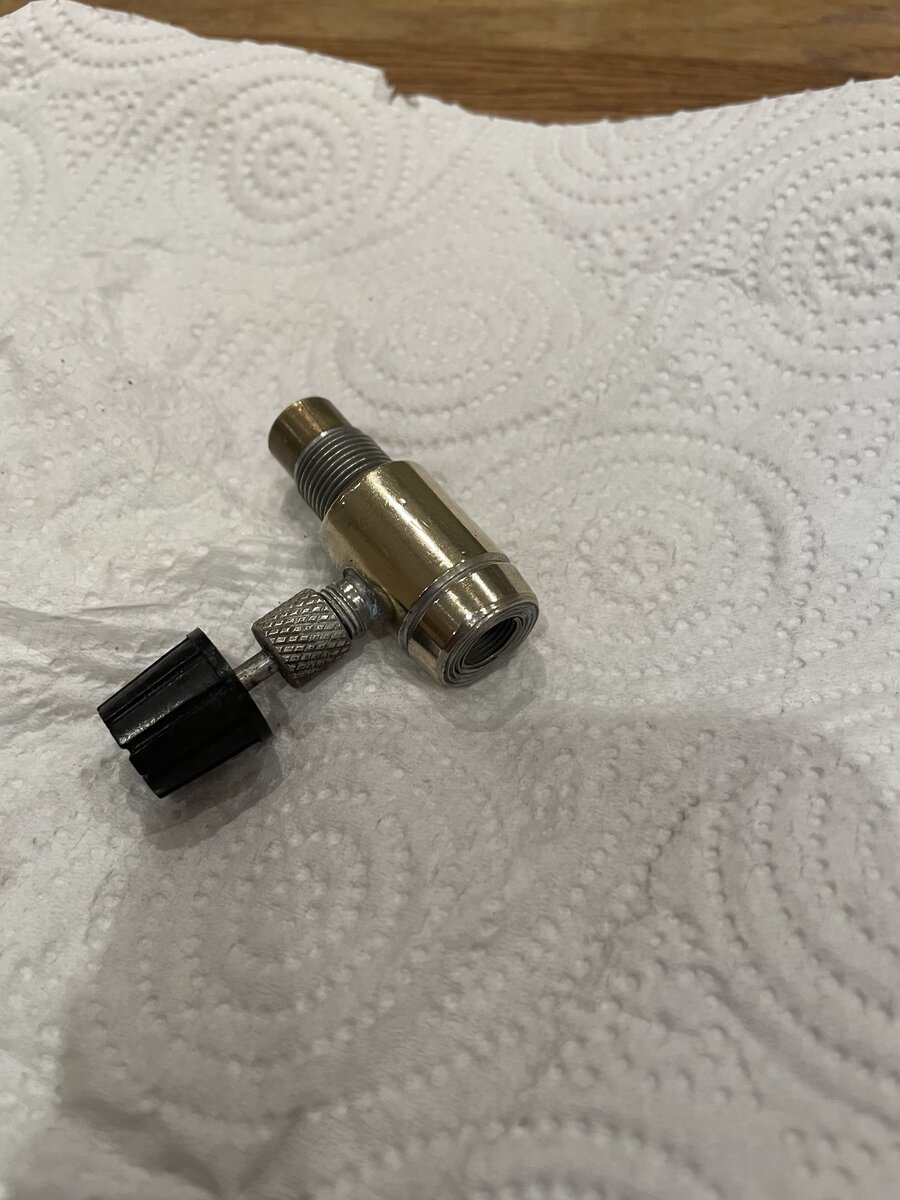

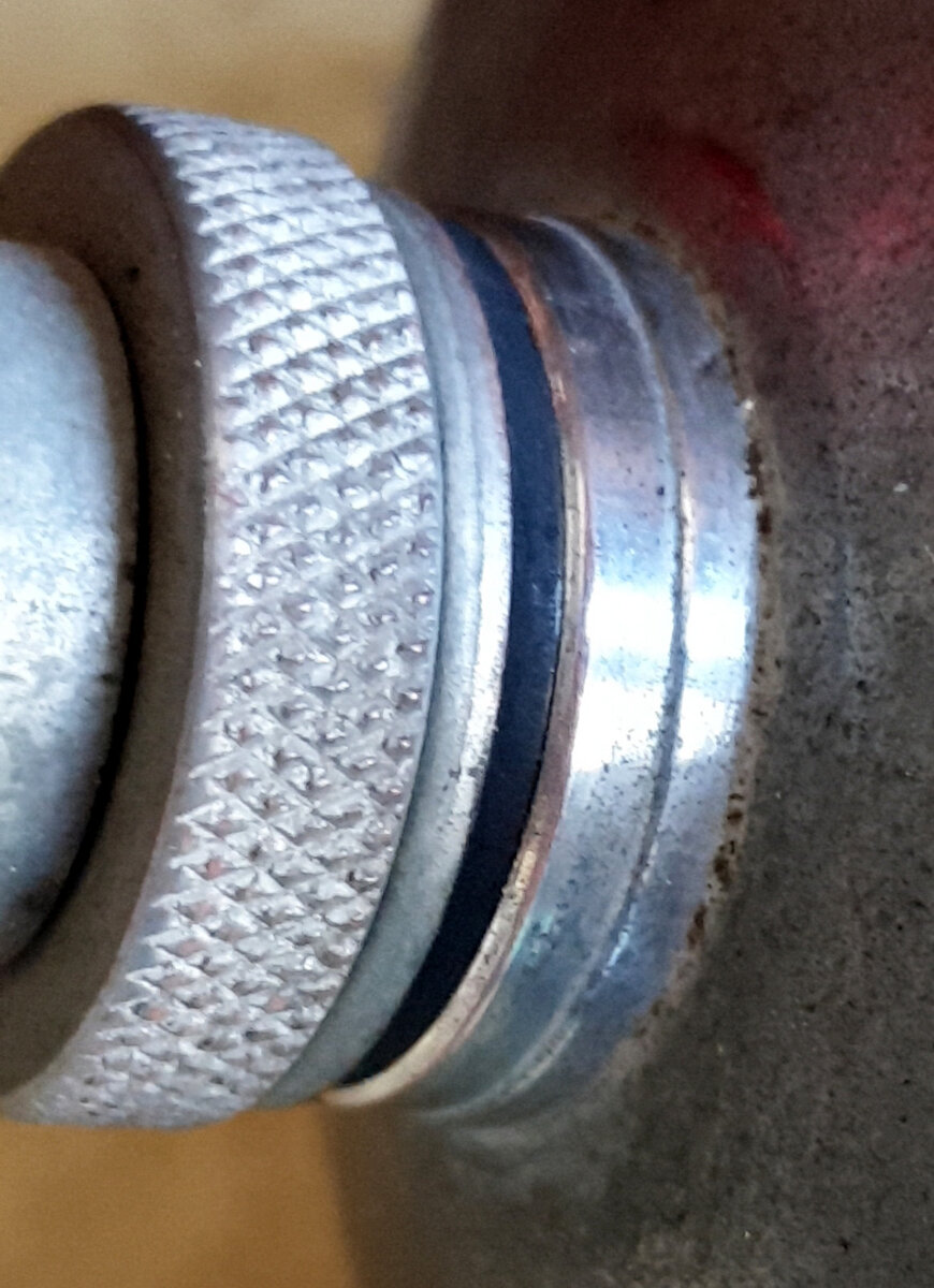

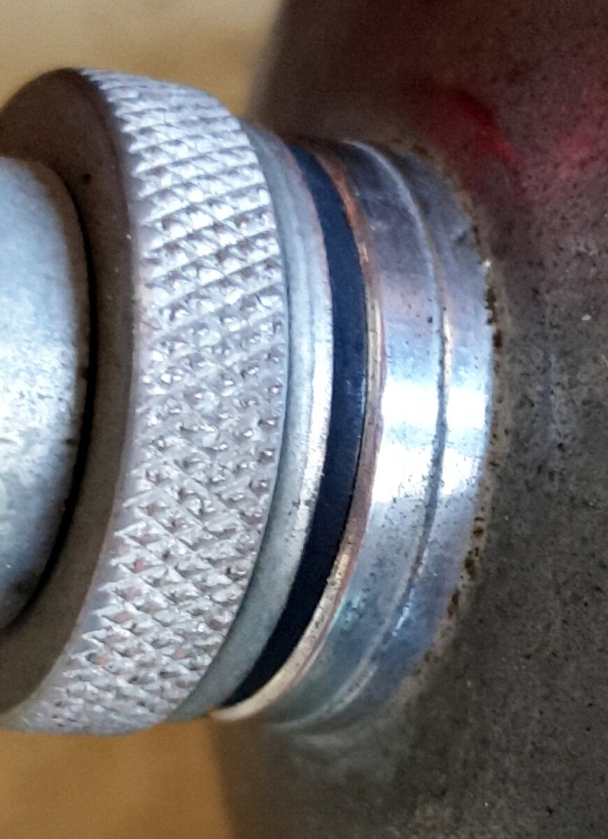

    For info My Nov 1964 X246A, fount not stamped as X246A, but base stamped 1164XA has a brass not aluminium 777 control cock with the brass holder for the round 155 valve seal , I believe the lamp to be as built when I received it, condition of all parts would suggest so

    Thanks for mentioning your late model X246A brass based control cock 777, which looks like it may have been plated originally. I chose not to expand, at this time, on the later production 777 cocks and just point out that in the later production they all have a groove which is still quite correct and useful for immediately knowing they are a later X246A.
    Later Production
    I probably should have referred to the above as a 777 control cock but very often they are just referred to as X246A control cocks, perhaps to differentiate them from the traditional GF777.
    In the advertising, parts lists and instructions I have seen that they offered the earlier (about 1961 and 1962) control cock 777 as "plated or gold sprayed finish". I haven't been able to find much on the subtle differences later on but knowing the date of yours will help me in that endeavour as I do have some of the other ones dated such as the smooth aluminium one.
    Good luck too with your Bialaddin 305. They are a nice unit.
