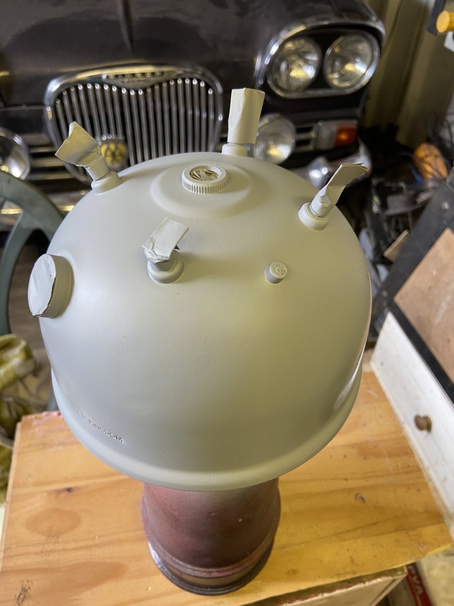

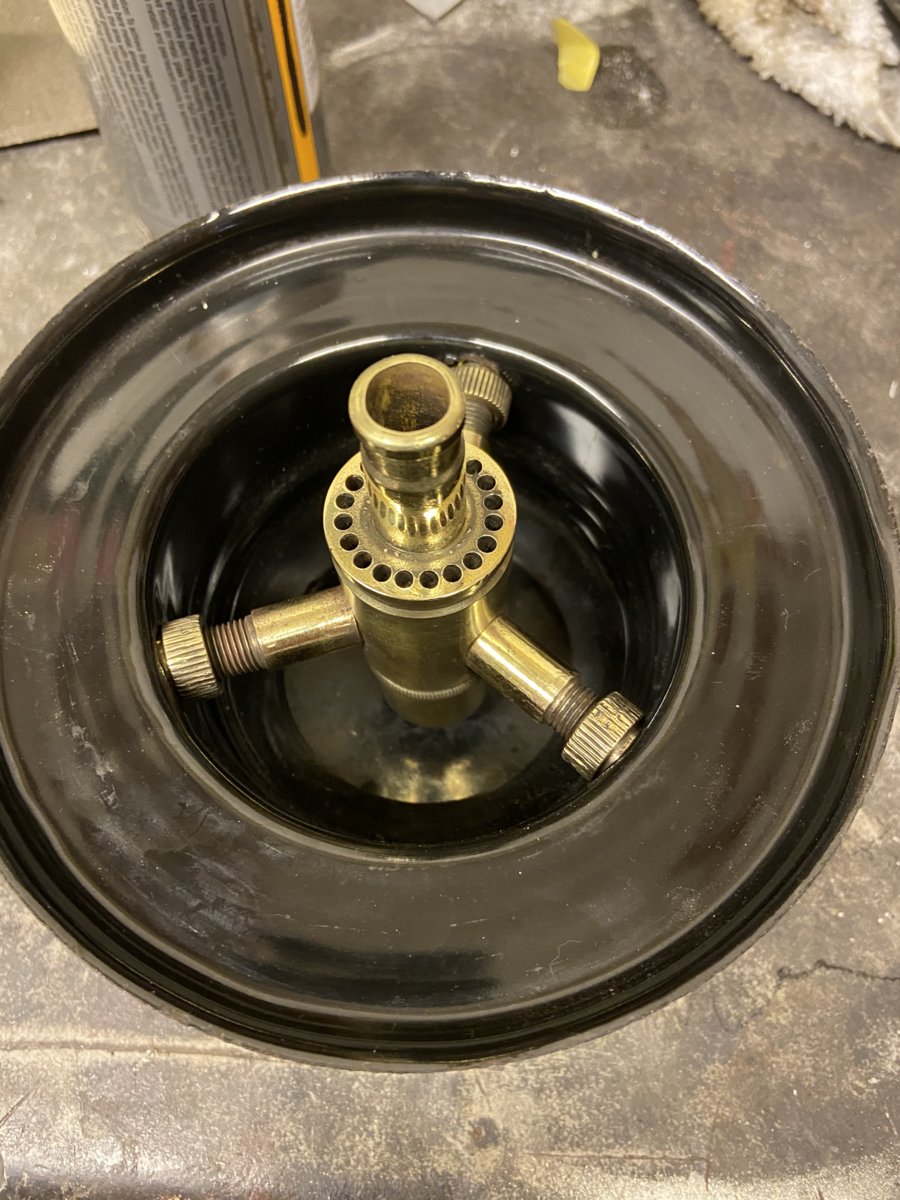

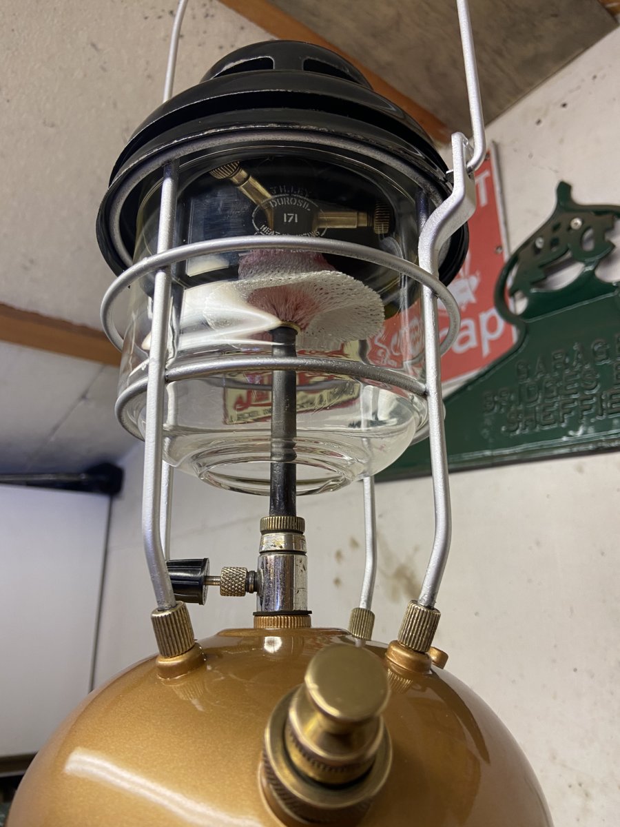

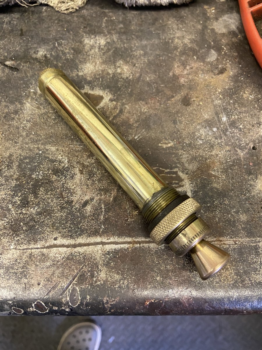

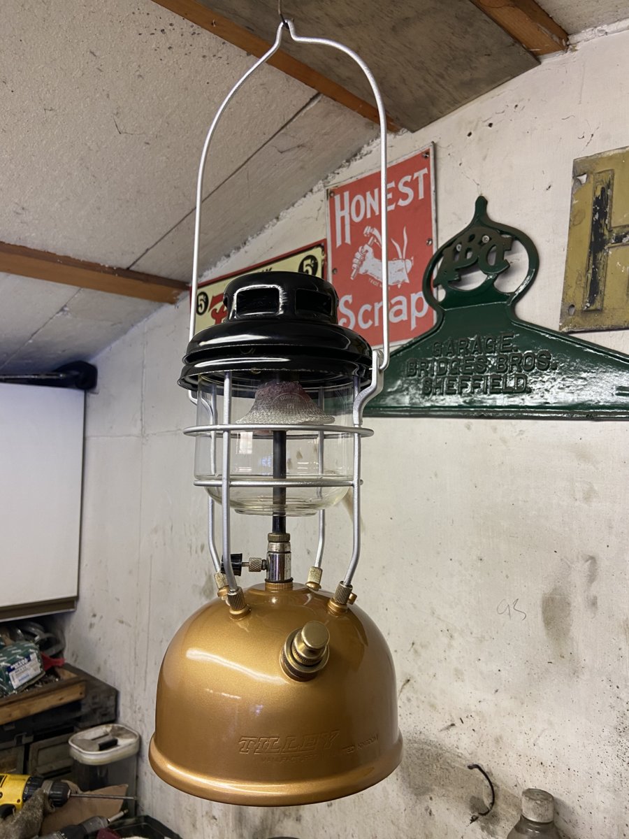

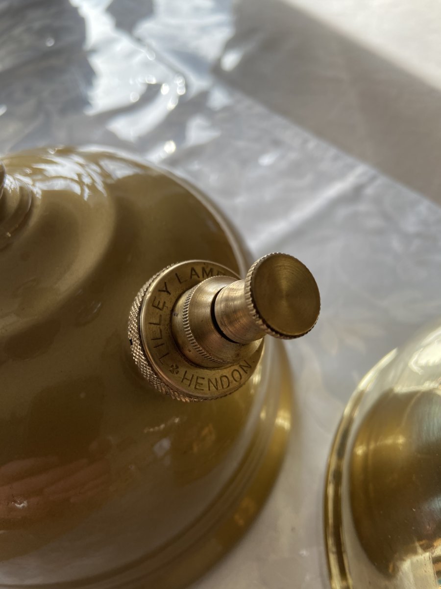

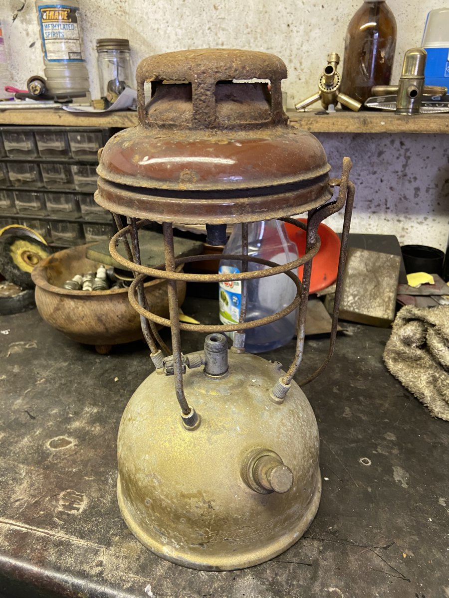

    This is 1964 and I found it at the back of a shelf in the shed hidden behind a load of scrap X246Bs. Stripped back to bare brass to revile pesky dents that needed to be filled, primed then finished in Halfords Ford Arizona Gold and lacquer. I’m actually thinking this colour would be spot on for the PL53s. (Watch this space)
    I’m aware it should probably have a 171 glass in but I had some deep glasses spare and thought it looked better. Luckily it had retained its original pump and control cock.

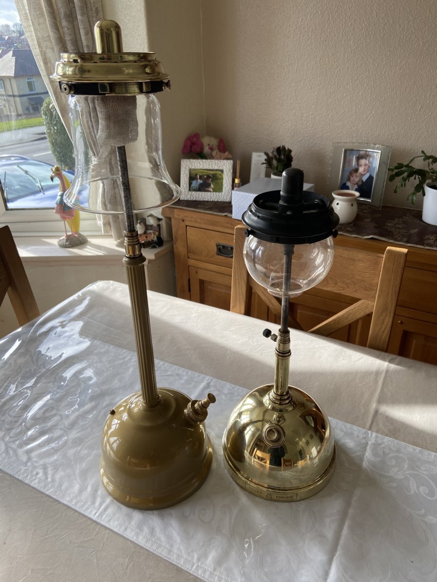

    @paparazi I have also used the Ford Solar Gold, recently on this table lamp. slightly brighter in colour.

    Did you bother to sand the primer? Did you find the need to sand between any coats?

    @Matty yes the primer was sanded between coats with wet and dry paper.
    Then 2 coats of the gold then a fine wet and dry sand before 2 coats of lacquer.

    Thanks for the tip in regards to sanding. When sanding prior to lacquer we are talking 1,000, 2,000 or 3,000 wet and dry?
    Indeed, why not make it look the part. I was serious with what I said. I actually went and got a couple of lanterns I wouldn't normally give a second glance to size them up for a spruce up.
  17. Gary Waller
    Apr 3, 2018
    622
    @Matty Halfords recommend 1200 but I thought that was a bit course so I used 2500 with slightly soapy water and it worked fine.

    I'd have thought 1200 was a bit coarse too. I have 2,000 paper here that I use on brass founts before I polish them.
