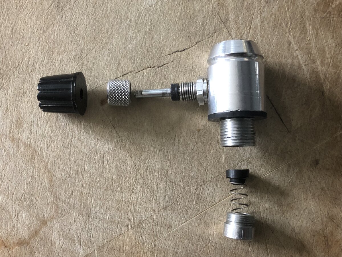

    I am currently trying to service one of my X246B’s by installing Tilley’s Service Pack 1 but am running into problems with the control valve. My lamp was evidently produced in November 2015 and I believe all the parts to be original. I can see no way to disassemble the internals of the control valve assembly, as there is nothing to unthread from the valve body to access and change the spring (610) and washer valve (155). A search for information on YouTube only yields happy Englishmen easily and conveniently dropping all the necessary parts in place while carefully explaining that they are also servicing X246B’s.
    I understand that there are brass and aluminum variations of the control valve assembly, but the aluminum one I have does not come apart as do the ones I’ve seen on the Internet.

    Any good?
    when you take the plastic knob from the spindle , then you unscrew the gland nut.. the little washer may be hiding inside [-X
    the piece with the filter unscrews revealing the spring and moulded washer

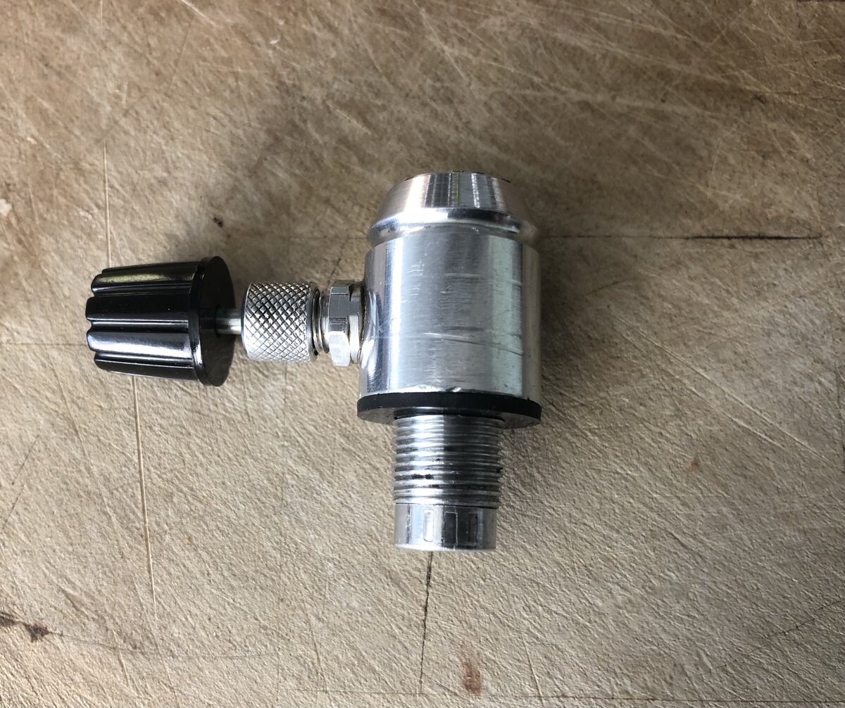

  4. podbros
    4,118
    479964FC-FB39-4A61-8670-D3C56A4EE5D3.jpeg 2436F48A-0E28-4222-B9E6-8066739DCAC6.jpeg

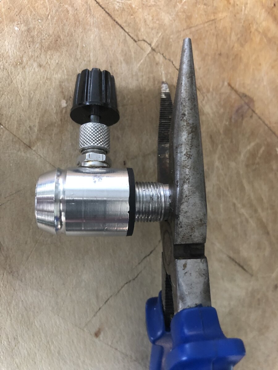

    ok here is mine screwed back together
    if you get a pair of pliers and grip Only on the unthreaded part it will come undone.. to prevent marking use a piece of leather or similar?
    ps you should not need the pliers to put back together :-)

    Well that did it. Thank you, podbros! All it took was a large pair of locking pliers and my wife’s right glove 8].

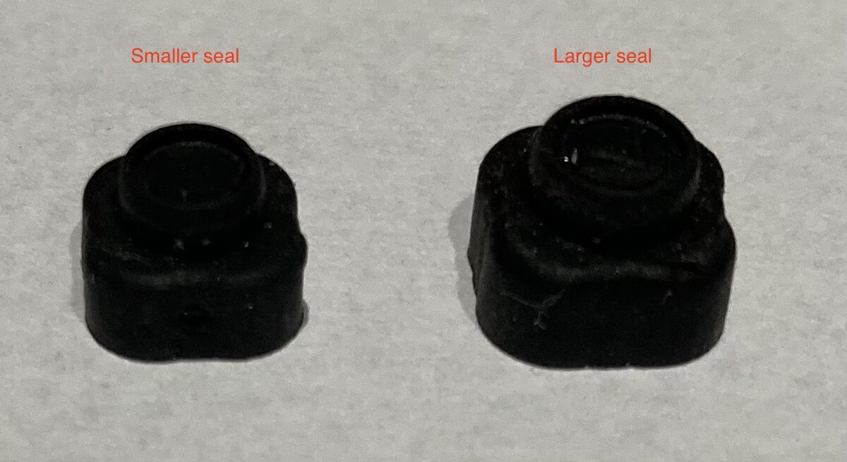

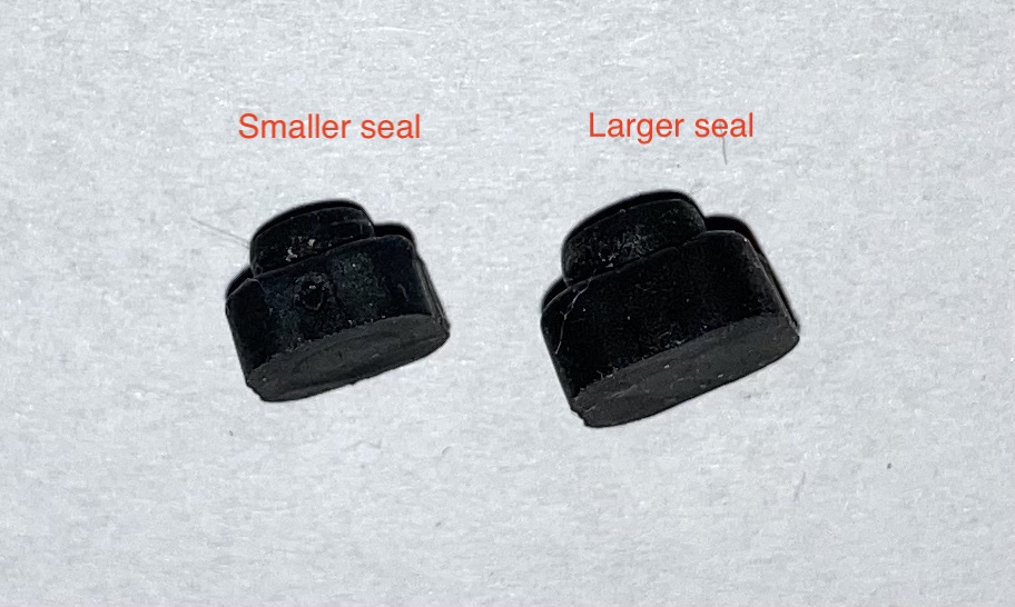

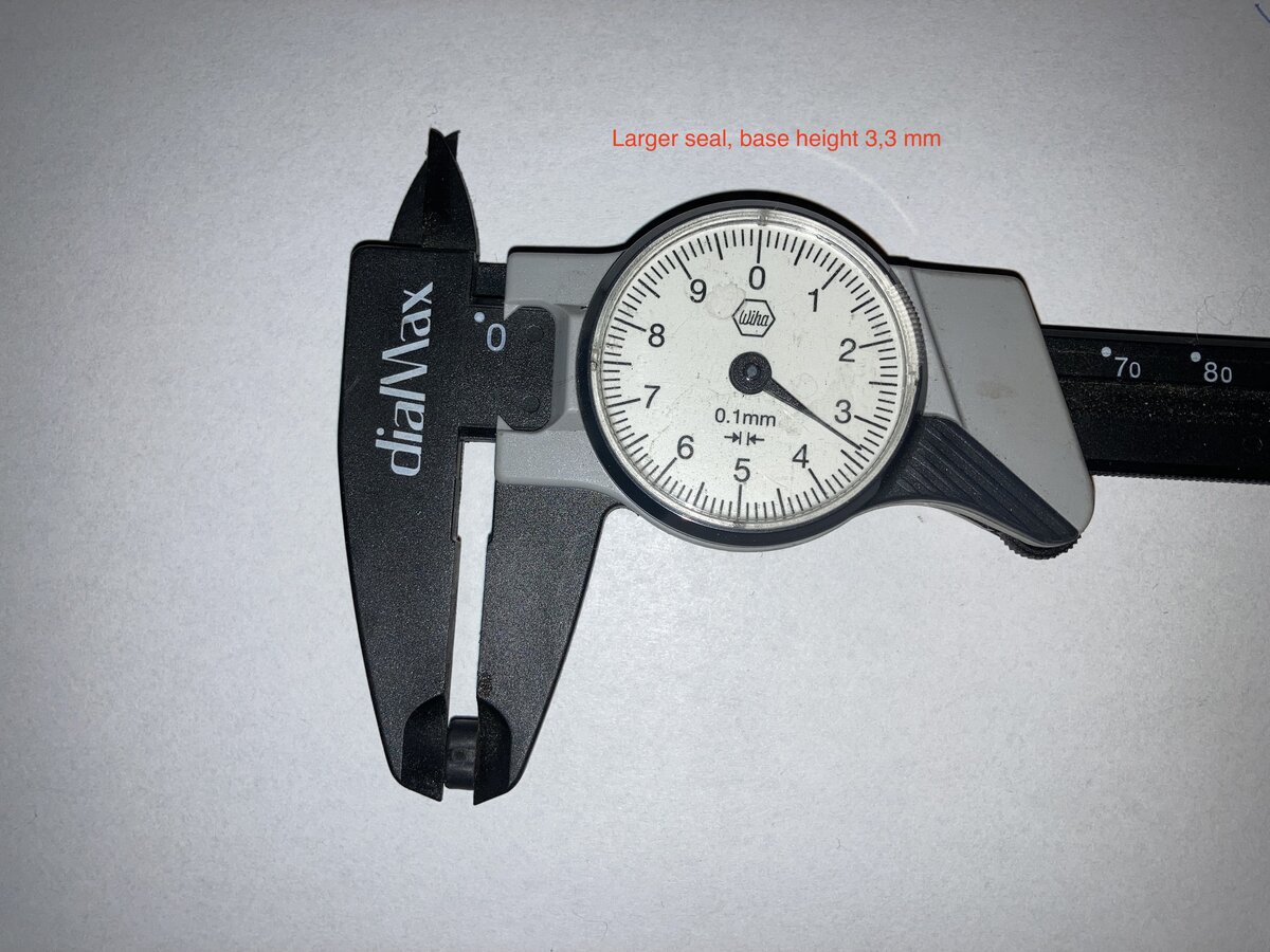

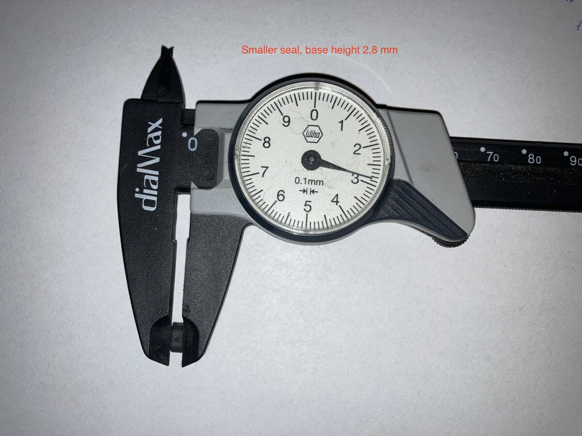

    OK, here are some pictures of two #155 seals included in a recently purchased Tilley Service Pack 1. There is a difference of 0,5–1 mm difference between them in both the height of the seal (which I've referred to as base height in the attached images) that rests outside of the spring and in the overall width. As I've tried to explain, the thicker/wider seal prevents the pump from dispersing any air because it compresses the spring too much—at least that's how it seems to me. To use this seal, the retaining nut has to be partially disengaged/unthreaded. My understanding is that there should be two identical #155 seals in SP1, one of which is for the control valve and the other for the pump. I haven't brought this to Tilley's attention, but it would be nice if they would look into this and, if appropriate, send out another visually inspected SP1.

    Many of us will replace the "modern" seal with the older brass cup and flat seal.
