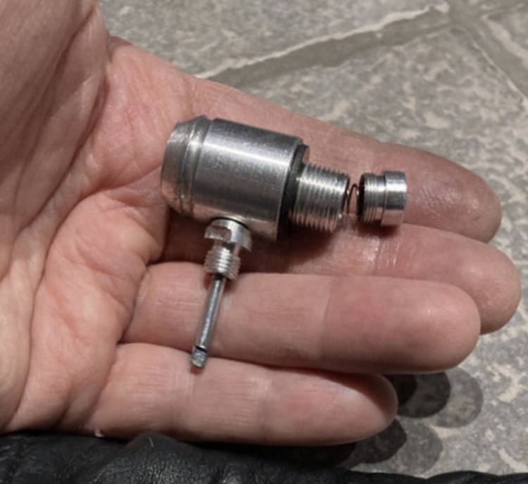

  2. Sedgman
    1,274
    Victoria, Australia
    The lower section of the control cock unscrews to grant access to the 'pip' and the spring. Usually just the pip needs replacing. If the spring is not strong enough and is in reasonable condition it can be stretched just a little but I would replace the pip only and see how that goes first. Use Viton rubber, not Nitrile rubber and the washers are available from the site sponsor Fettlebox.

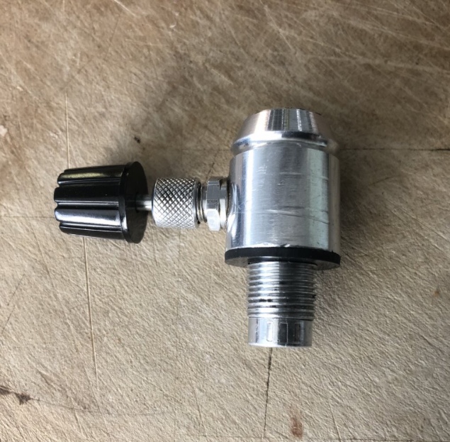

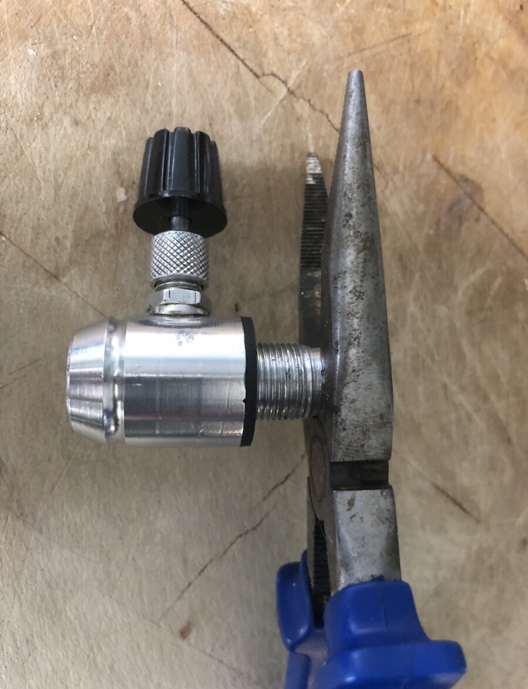

    4,008
    Hi @Simon Foxxx

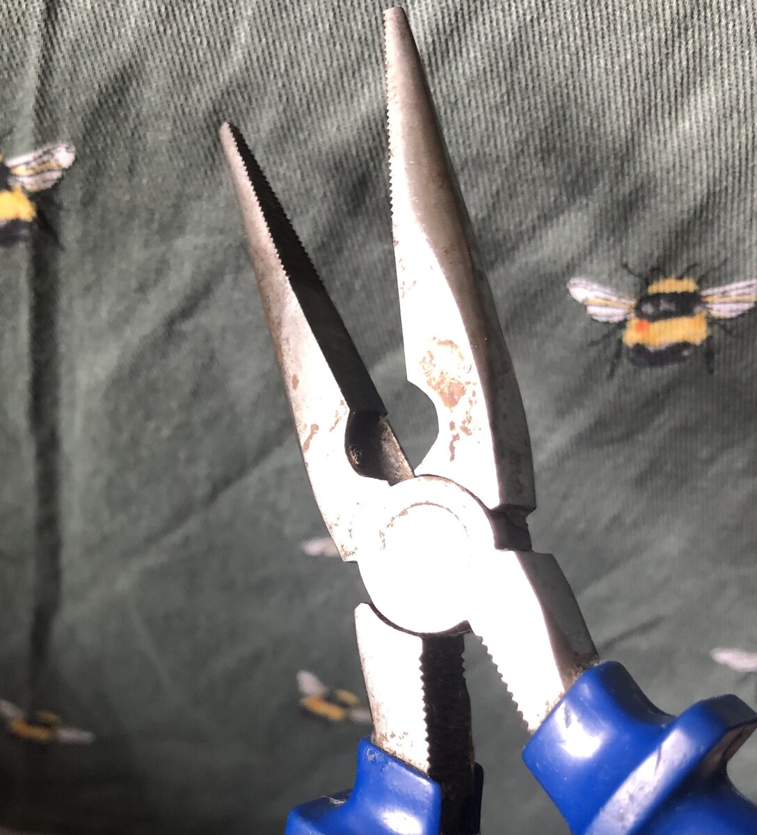

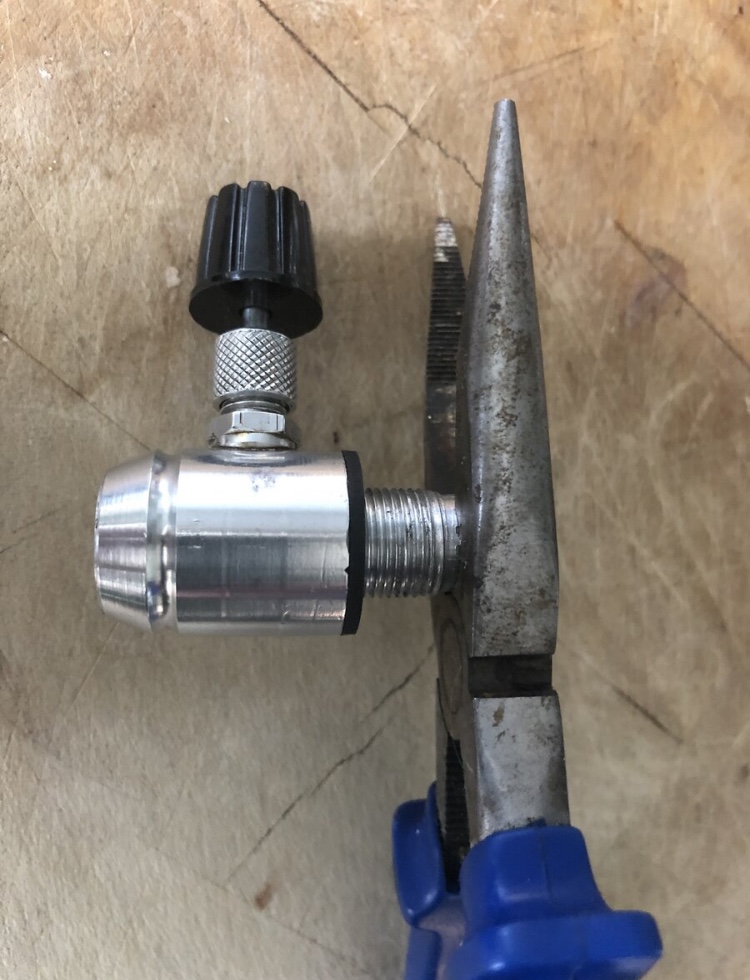

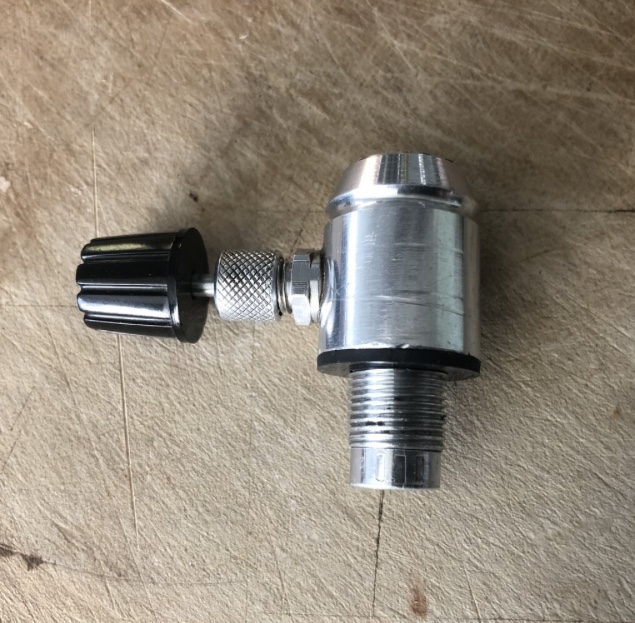

    its not always clear on the alu control taps that the bottom section with the gauze filter unscrews as it can look like part of the main body?
    but careful use of pliers can reveal the valve contents..
    i generally use the hollow section on my pliers to grip them as it doesn’t mark them so much
