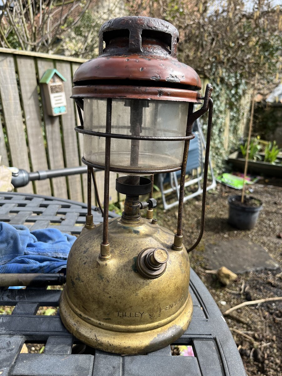

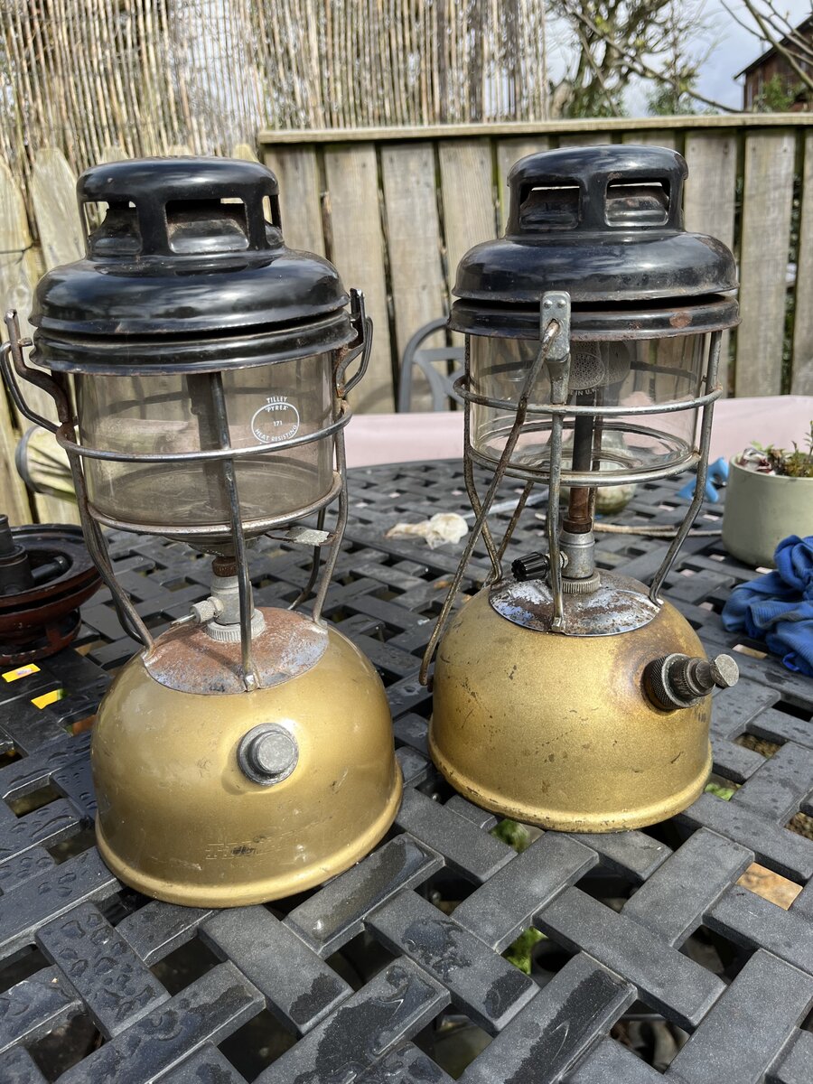

    6B914868-C339-4A86-9CF0-EB58EE3E1A47.jpeg IMG_2988.jpeg IMG_2987.jpeg IMG_2985.jpeg IMG_2986.jpeg So I’ve started my first proper Tilley restoration on the freebie X246 (first pic on here) that was given to me by a neighbour. Stripdown was remarkably painless, although the tube appears to have some odd kind of black varnish on, and the burner nuts are solid. Would a good soak in paraffin be recommended for those? Pics at end of this text…
    However, I’m now sure that these Tilleys keep multiplying… a visit to my localish restoration yard discovered two more for £10 each. Pics here… one seems to be virtually identical to the X246 I’m already working on, albeit it came with a very loose reflector and asbestos wick tray.
    The other - an X246b - is quite tidy and is stamped 1269 on the base. December 1969?
    It’s the left hand one with Tilley stamped on the side. It also seems different to my other X246b (on the right) and I’m guessing is earlier? That one has no stamps anywhere. Anyway, onwards and upwards! This is really quite addictive…

    The black varnish like sustance is fuel residue and will need a long soak in varnish remover / acetone before attacking it with wire wool.
    Paraffin is very searching so will act as a penetrant but when those nuts are tight, they are TIGHT. You may strike lucky but don't expect it to work after just one overnight soak.
    It's rare to find an X246B with no stamping, I'd expect a date at least. Are you sure the date stamp isn't just very faint ?

    Thanks Henry. I’ll get started on the soaking. The threads by the nuts are all full of solid carbonised crud as well so that’ll hopefully soften that.
    I’ve double checked the base of the second X246b and there’s a very faint ‘T’ but that’s all. I will be stripping the paint off that one however when I get around to it, so more might be revealed.

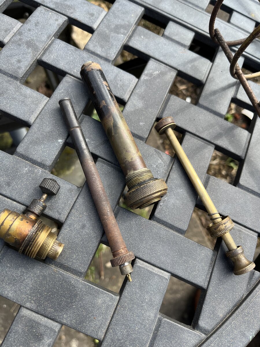

    IMG_2994.jpeg IMG_2995.jpeg IMG_2996.jpeg IMG_2997.jpeg So… here we are after a full strip down and inspection if anyone’s interested. Basically, despite having sat in a shed for 30+ years everything seems pretty intact albeit in need of a good strip down and clean.
    Two questions … is the hood saveable or is it best to just leave as is? And what would be best to strip the paint from the tank. I’ve done tests with both Nitromors and Paint Panther (I saw a recommendation on this forum) but both don’t want to touch it… not even the faintest sign of a blister.
    Thanks as ever in advance
    Chris
  13. Fireexit1 United Kingdom
    3,518
    Hot water seems to do for Tilley paint. As for the hood - I would live with it until a better one comes along. It all looks very promising :thumbup:

    Yep tried that just now and incredibly it works - the paint seems to soften and blister much better than the actual paint stripper! Not sure what the mrs will say when she finds a slightly paraffinish Le Creuset but we’ll cross that bridge when we come to it
    On the minus side I’ve got the burner off but two of the nuts are dented - old injury, not me - will that affect performance? Also the whole thing is crudded up to an incredible degree. It and the vaporiser are soaking in paraffin now …
    C
  15. Fireexit1 United Kingdom
    3,518
    As long as the nuts go up and down the thread they should be fine. They may be a little eccentric but if they are you may be able to squeeze them back to being a bit more round. That crud is probably an effect of it not running very well for a while, or with odd fuel. Don't go too mad cleaning up the brass as it will discolour as soon as you light it up.

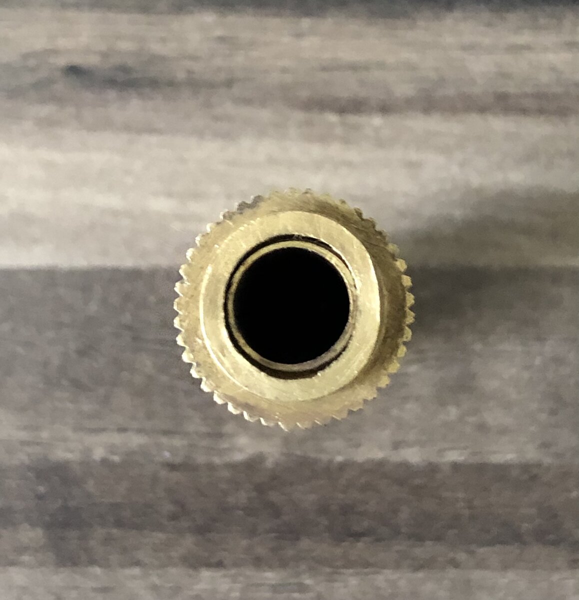

    So, the first X246A from the top of the thread (the one that had the 'varnished' pump) - had its first successful light today. No glass, just blue flames from the burner. An initially hairy 30 seconds where it looked like a flarestack quickly subsided into a nice roar - I'm guessing more pre-heat needed, plus a slight leak from the vapouriser gasket - I'll get a new washer from Fettlebox.

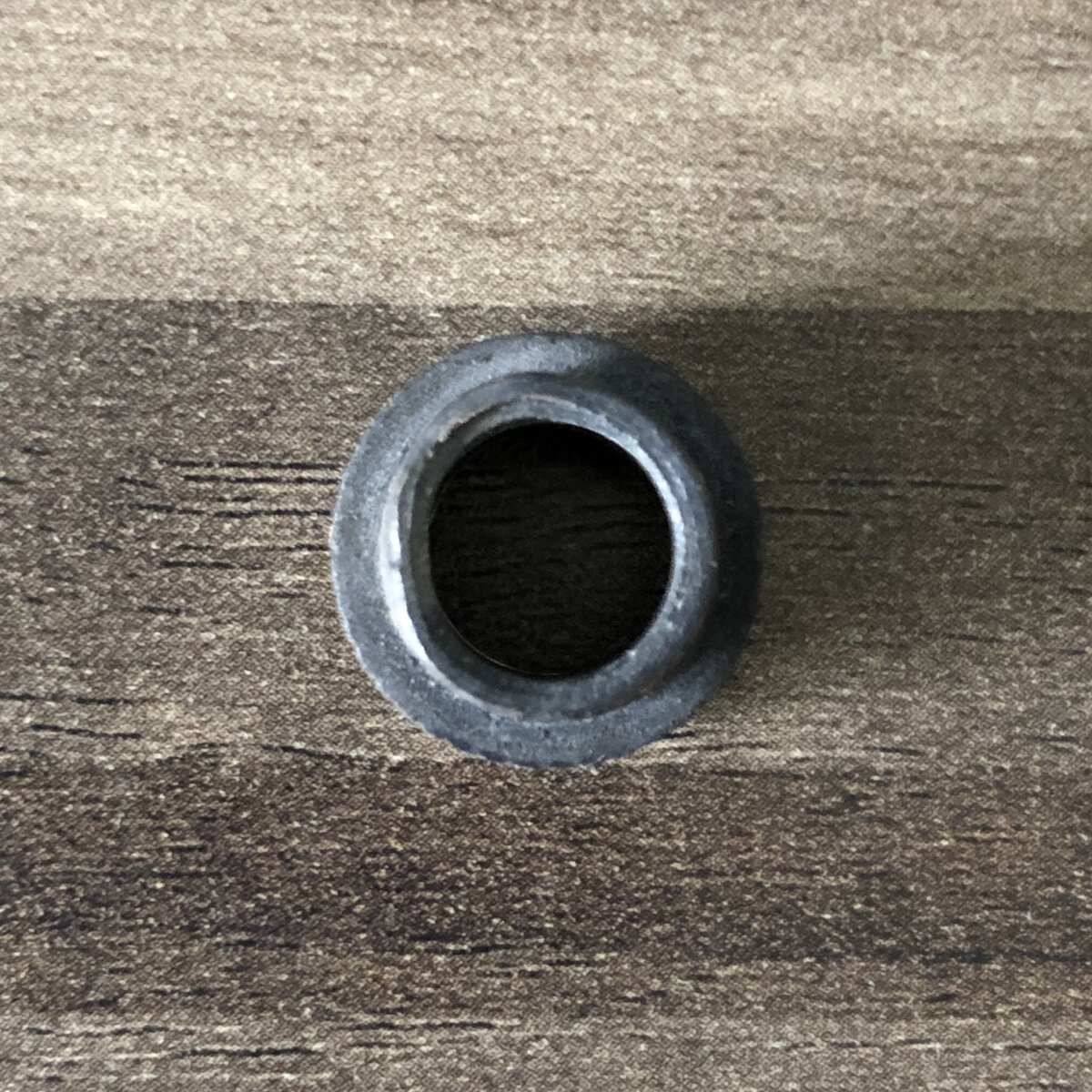

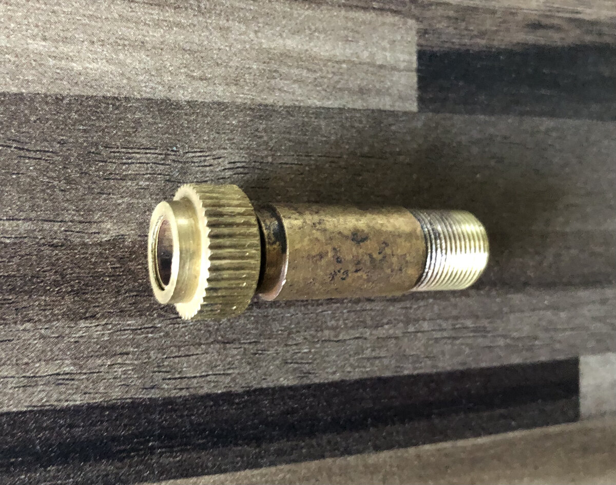

    More digging into X246A number 2 - the one that came with the Bialaddin pre-heater as an extra - has thrown some issues. First the burner looks distorted - the ends of the air tubes look wonky for want of a better word - a quick test on X246a number 1 did get them down to a nice blue burn but only after there was a flaming leak from where the vapouriser met the burner. Prior cleaning had shown them to be crudded up to the max with a carbon-varnish for want of a better word. And... the vaporiser is blocked - have tried quenching, acetone, soaking in paraffin, banging it, swearing at it, offering it untold riches and scraping the inside but no joy. It's one with a nice brass nut too, so I'm reluctant to get rid - have had the nut off, and managed to free the very stuck needle but the end is resolutely blocked. I have six spare vaporisers heading my way shortly but I'd rather get the original off the blocks... anyone want a go at attacking it?

    Well the vaporisers were designed to be a consumable. Sometimes they just don't want to come back to life.. Burners can wear out as well, and with a lot of use can warp/bend. Often they continue to work OK. The mantle support (bottom part of the burner or spigeot) is also a regular replacement part.

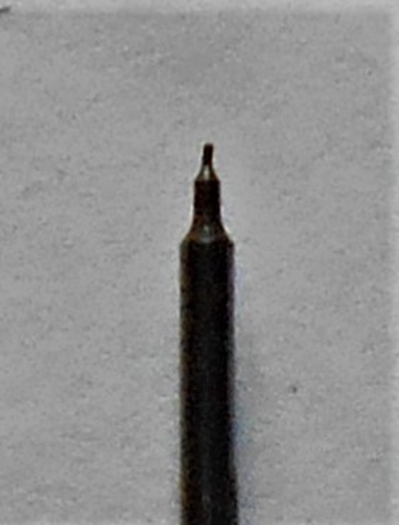

    Are you 100% sure the end of the needle hasn't broken off the wire and is stuck in the orifice ? The end should look something like this. If it doesn't, don't throw the vapouriser away just yet. base-camp usualy has spare cleaning wires (#607) but at the moment, they're temporarily out of stock.
