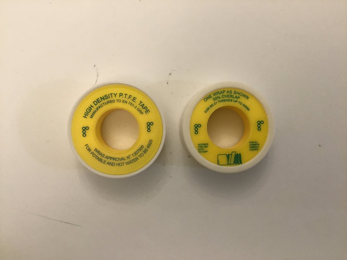

    Plumbers PTFE will work OK but better to use the Gas tape which is thicker and designed for use with fuel. Normally more expensive and in a yellow case but readily available. I use it a lot for sealing glands. PTFE does stand considerable heat and is a simple quick and permanent fix. ::Neil::
  17. X246A
    1,240
    Norfolk, England
    Hi folks
    This is the stuff that @Mackburner is recommending:
    When I had a problem with a seal on my Veritas 350 and was unable to remove the control wheel from the spindle without damaging it Neil suggested twisting gas often tape into a “string” and wrapping it round the spindle a couple of times. Three years later and still no leaks.
    Regards Jeremy
    Edit: corrected spelling error!
  18. Mackburner
    Yeah that's the stuff. It also has the advantage of a low friction coefficient so you can tighten the gland pretty hard and the spindle will still turn easily. Cheap, withstands heat well, safe with fuel, last for years, easy to fit and available at any plumbers merchant and all good DIY stores. What's not to like? I've been using this tape for many years now and it is a standard in my tool kit.
